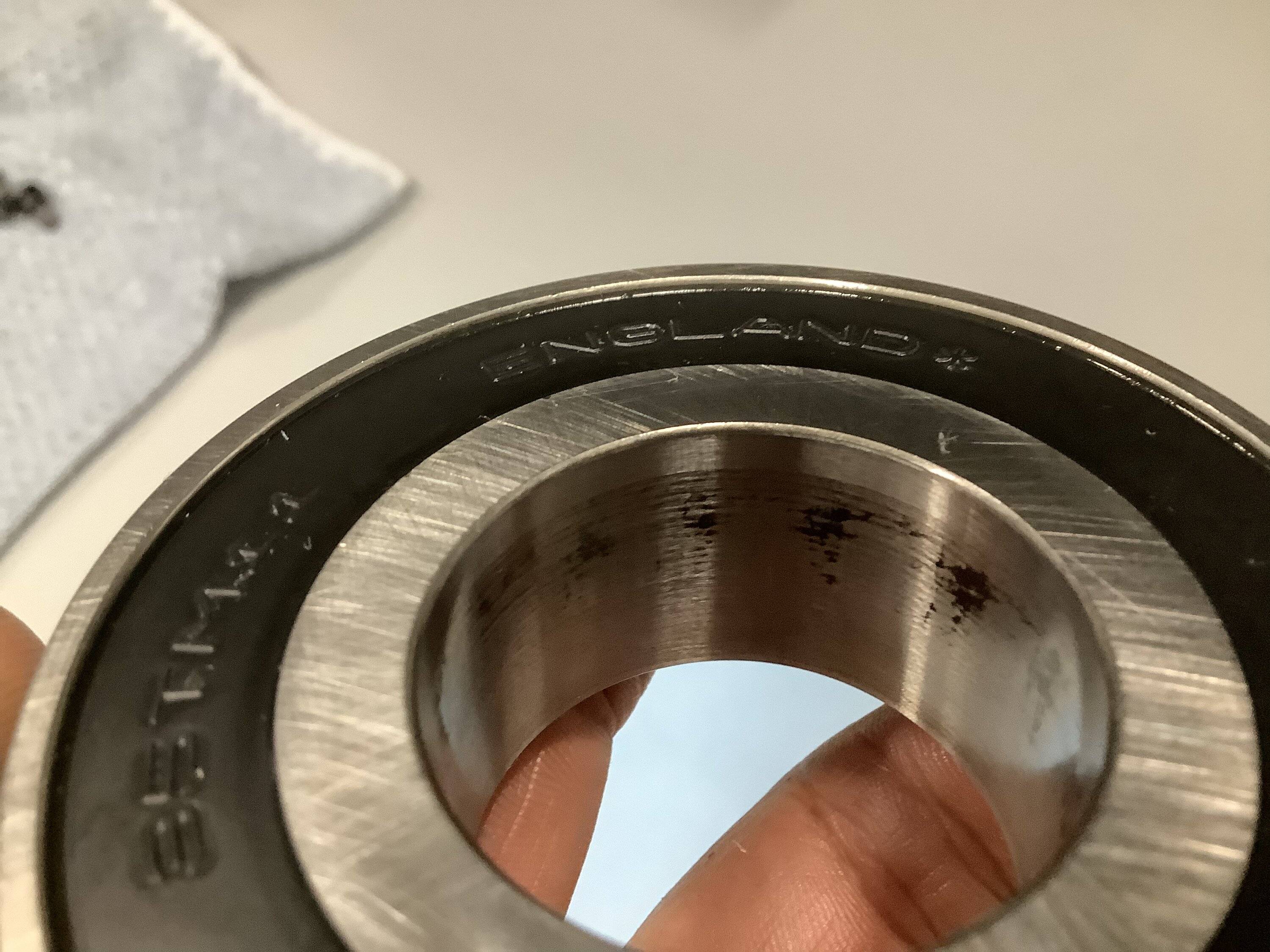

Here’s what my input shaft bearing’s inner race looked like at 6400 miles and with just two drag strip outings. After the second trip to the track, I would get a chirping sound every single time I released the clutch on takeoff.
If yours is going bad, it’ll involve a teardown in order to get to it. If you go that far, you might as well replace other things like synchros, tob, clutch, pilot bearing, countershaft bearing and output shaft bearing.
I got myself into rebuilding my transmission after pulling it for a clutch install, as mine had begun to slip. I thought about how much time and effort was required to pull it and convinced myself that it made sense to upgrade everything that I possibly could.
Exactly. Thanks for posting the pic, that sucks it happened at 6k miles. Such a junk trans in these cars, I should have gone with the auto.
Anyway, just as you said, it's why the dealer is stating it might be better to just replace the clutch and trans completely and get a 3 year "partial powertrain" warranty on everything replaced.
I'm definitely not ripping the trans apart myself. I'll do quite a bit of my own repair and maintenance, but I'm not touching a trans. Nor do I have the means to get it out anyway.
I hear you. Have the dealer replace the clutch and entire trans and you should be good for a long time, especially if you don’t race or beat on it.
