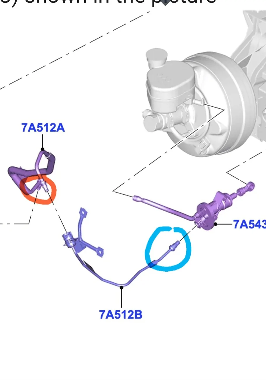

I have gotten a leak from the pipe (blue circle) that goes into the clutch master cylinder (pedal fire wal)
I have marked where its leaking with a blue circle
Could someone provide me with the part nr of only the o ring where the blue circle is
And is the size of the o ring where i put orange circle also the same part nr?

I believe it is a standard 010 o-ring. Make sure you use a green "AC" line one, which will not degrade from the brake fluid.
