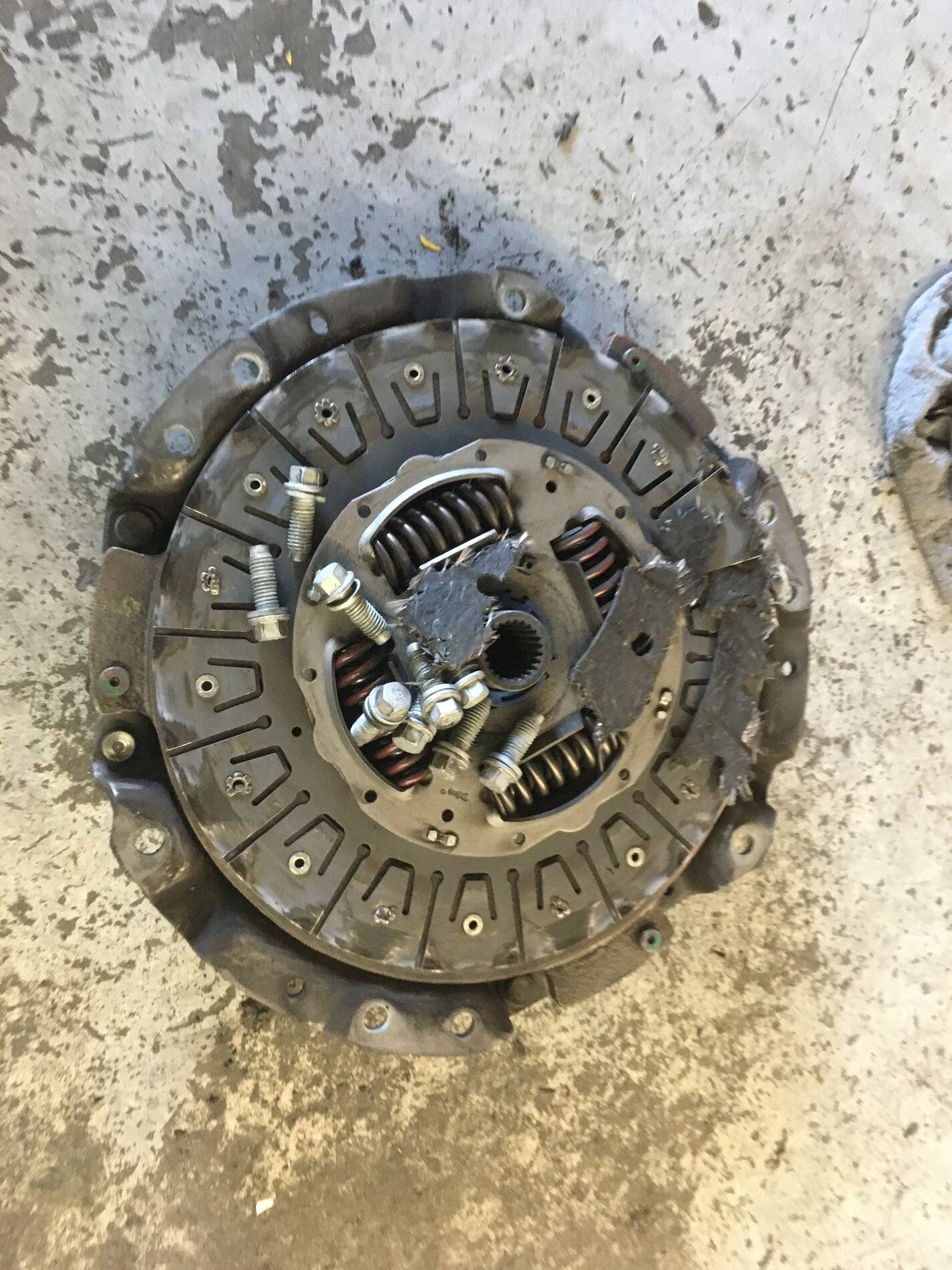

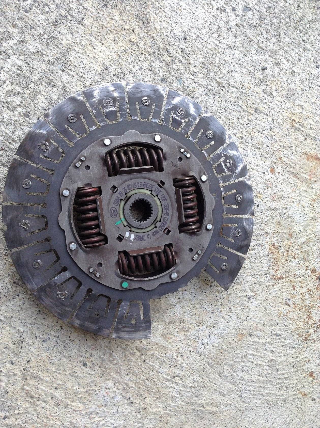

I would put money on your friction plate is looking something like this. Maybe not as bad as mine, but close. High RPM shifts do it. Let us know what you find.
This is why I went with a McLeod RXT twin disc. 7k rpm shifts all day
You made a mess of that dude. I will hopefully get it out by the middle of next week.
You were right, Half of the friction material is missing from the clutch plate. not as bad as yours mind. Half of the pressure plate fingers were still pressed in and the release bearing and green sleeve had separated from the back plate.
Yea the factory clutches are shit. Mine let go on a road course on the first lap at a 7200 rpm shift with 22000 kms on the odometer. They are made in Turkey. Sorry it happened but now you can replace it with something reliable.
