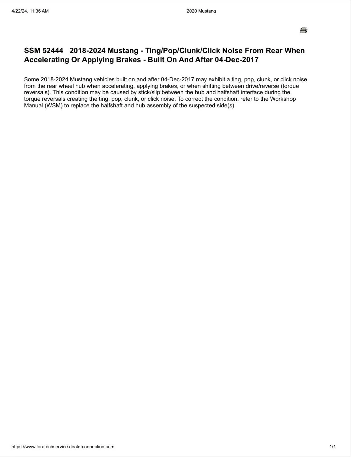

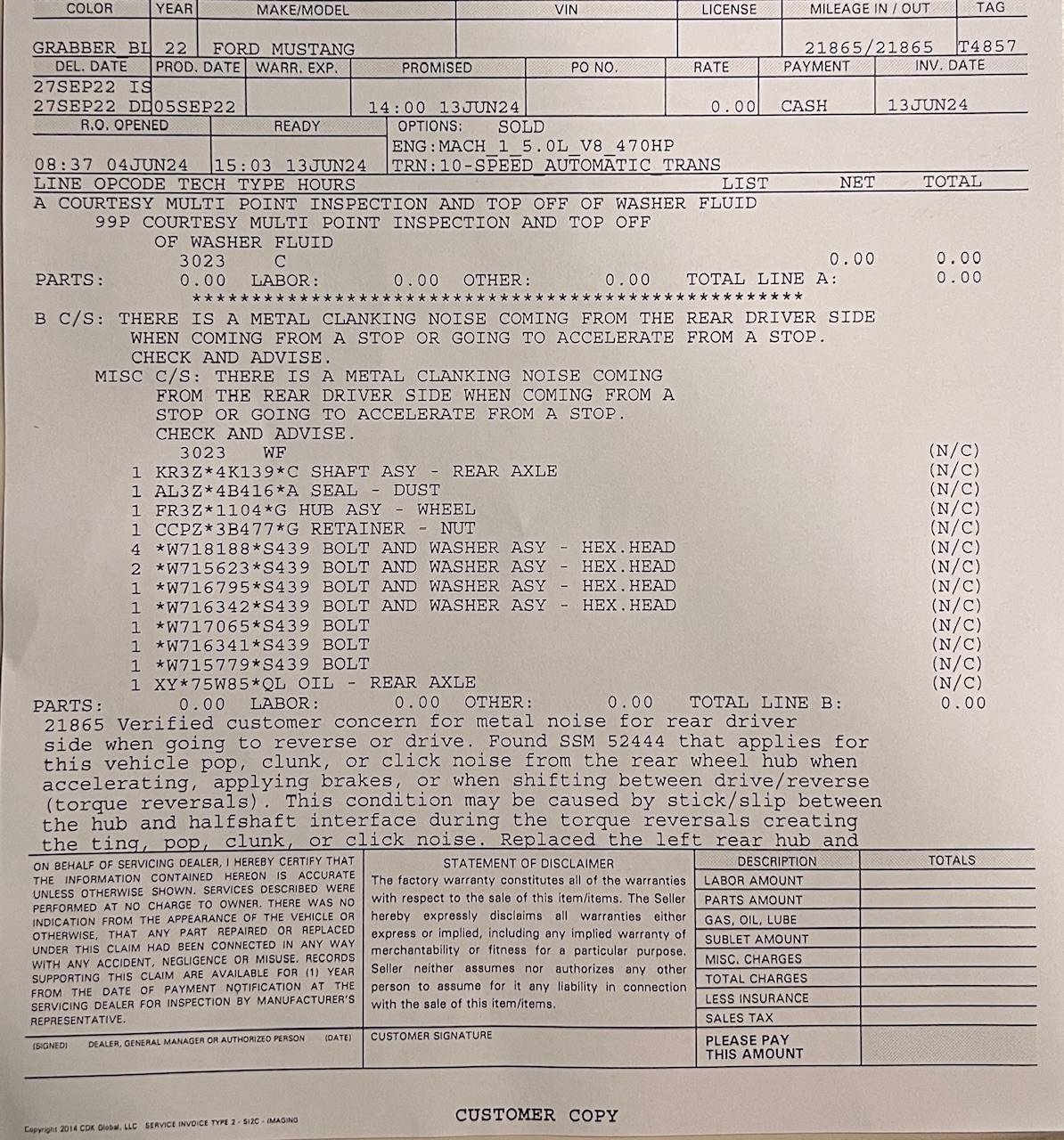

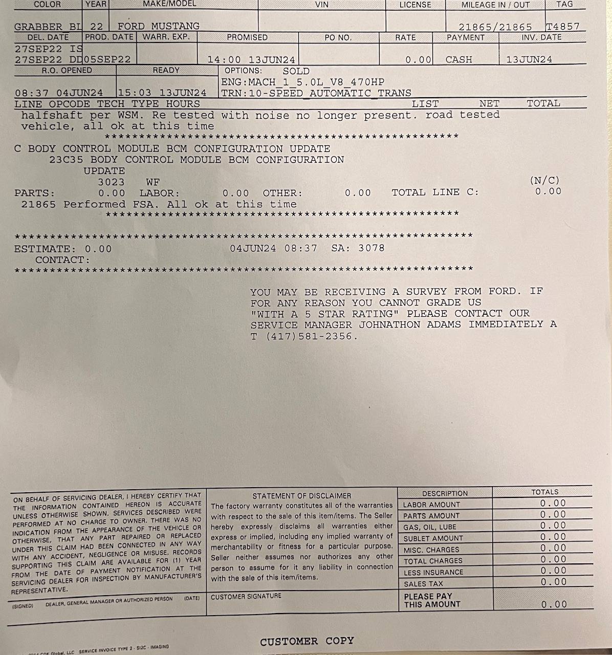

Okay so here were the results. They diagnosed the car with a condition of stick/slip between the hub and halfshaft assembly when accelerating or applying brakes or during the "torque reversals", this condition results in the clink/pop noise I had. They reference tech bulletin SSM 52444. There was also a similar bulletin sent for the ford lightning back in November of 22 with some more details and the repair for that vehicle (TSB 22-2395). Below is the SSM# and the paperwork I got from the service department. Car drives great now and no clicking or pinging from the rear anymore. Your issue may be different than mine considering what you mentioned but still worth bringing up. Hope you get it figured out!
