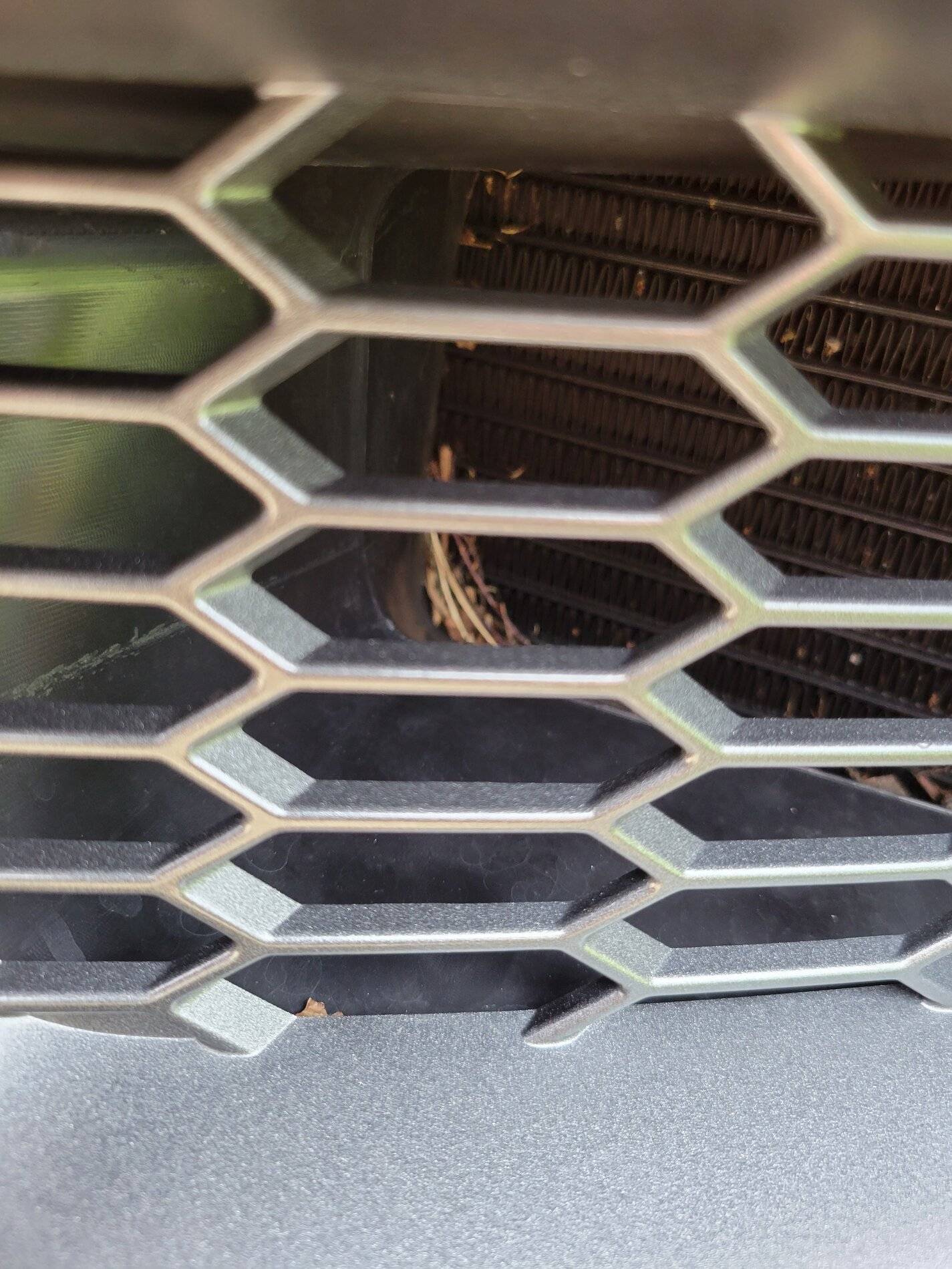

Anyone know how to clean out the lower grills that contains the turn signals? Both of my sides are getting full of stuff and there is a radiator blocking getting out the debris.
Hopefully I don't have to remove the wheel wells and unmount the radiators.

try a compressor or leaf blower maybe.

air compressor and a small vacuum hose sucking right at the grille to pick it up as it swirls around.

I tried the air gun and it wouldn't work. The plastic is directly against the coolers. I had to take a long screwdriver and bend the plastic (hoping to not slip and stab the cooler ) to open the gap and then the air gun worked.

A remedy for that would be to get screen and mount it behind the grilles so that debris can't get past the screen. Doing such a mod won't affect airflow.
