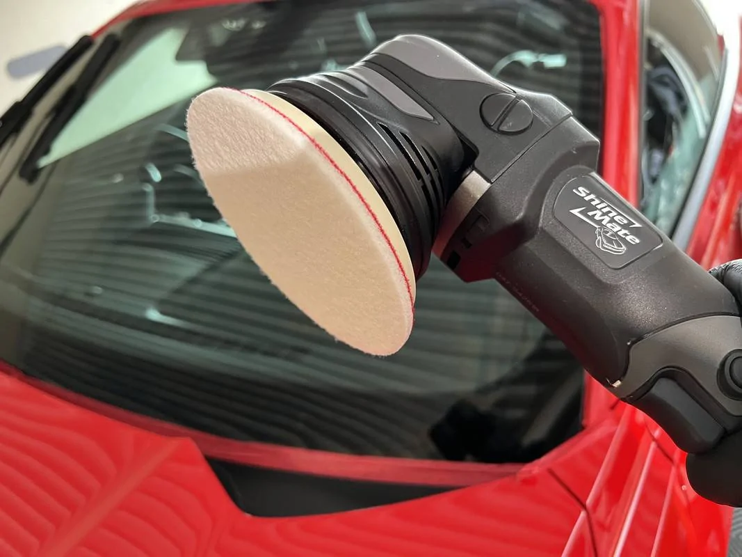

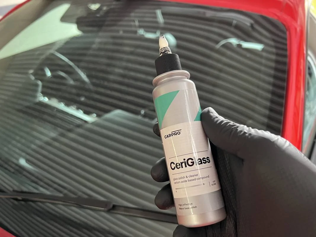

The heavy hitter for glass polishing would be Carpro CeriGlass on a Rayon pad or Rayon hand pad. You can buy this on its own or as part of a kit which includes a hand polishing pad. Otherwise, you would use the Rayon pad on a DA polisher.

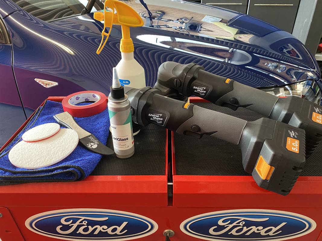

+1 for the CeriGlass with the necessary pad. Did this job a a good few months ago on mine. I had a little spray / sprtiz bottle of water to keep misting the compound and just took my time. Takes a while with medium pressure but it does work wonders. It removed the film / coating off my windscreen which I think was some sort of coating that was in the midst of breaking down. Nothing else would shift it (glass cleaner, vinegar, rubbing alcohol, clay bar, etc).

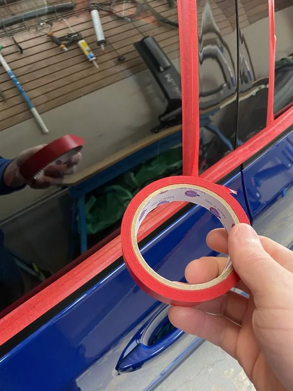

I forgot to mention in my post above about keeping the machine and pad moving across the glass and don't focus on one spot for too long. You can be pretty aggressive with your movements on glass, just keep the pad moving.
Only drawback to CeriGlass is that it can be very messy to use, I would recommend washing the car again afterwards to remove the splatter. You can of course use other polishes and compounds used for paint in this case, but they lack the ability that CeriGlass can deliver. Also be sure to mask up your rubber trims.
