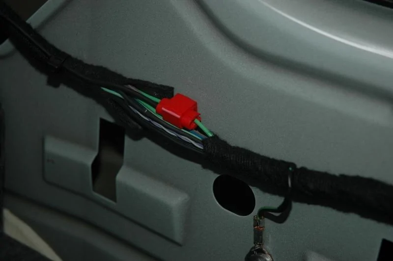

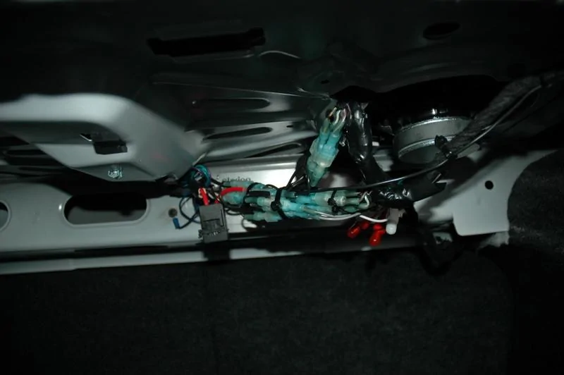

I had posted this in what I did to the car today and keep being asked about it so I am adding some pictures and info in a separate post.
Simply, I was tired of the lack of power the rear deck speakers had with my 12 speaker shaker system so I did a quick fix for about a hundred bucks. It totally woke up the system and I usually don't crank it up past about half to three quarters now and the entire car sound great.

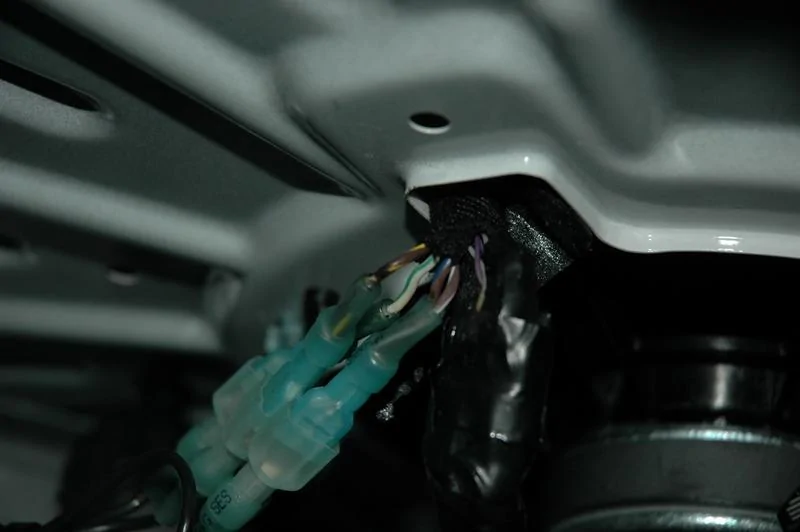

I tapped into the harness at the right rear speaker and pulled the brown with white stripe, brown with blue strip (right speaker), white with green stripe and brown with yellow stripe (left speaker) out of the harness, tapping into them and adding some spade connectors so that I could add a few feet of wire to the amp. Hooking into the amp with the speakers is a no-brainer. 4 wires in and 4 wires out. Took the ground and nailed it to the bulkhead and did a quick lock into a hot wire that is keyed behind the center rear body trim. The only thing that had to come apart was removing that trim with the 4 screw knobs (30 seconds).
