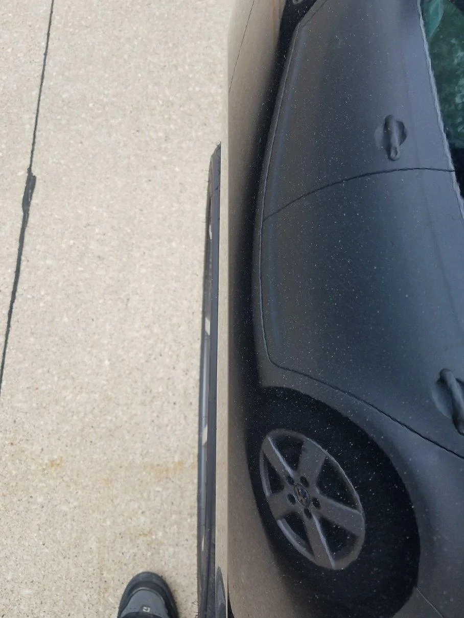

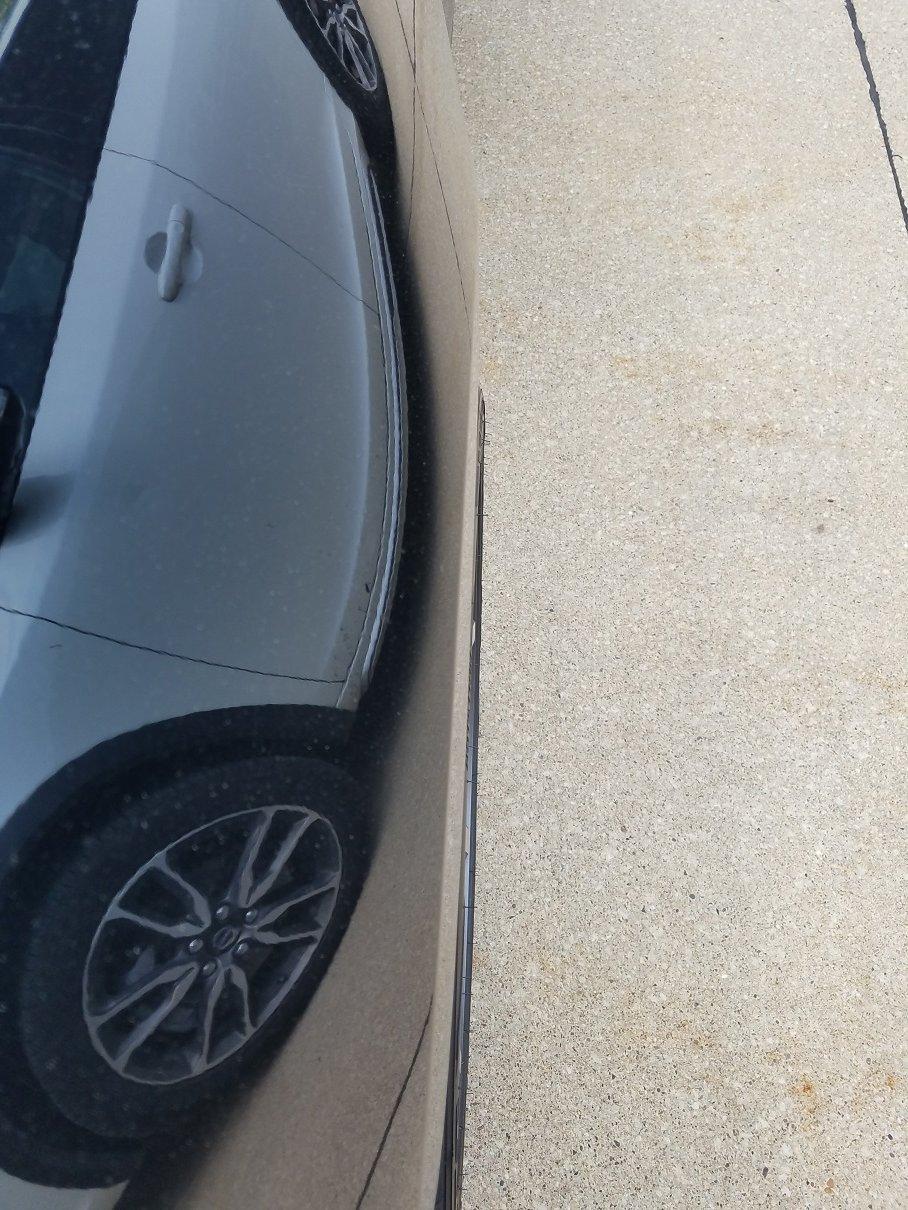

I believe the needed camber adjustments are for those of us were off from the factory. From the factory my left wheel is WAY off. You can actually sit behind the car and visibly see my right wheel is cambered in, while my left is pretty damn close to 0. Just haven't gotten it fixed yet. You can see the difference in the pictures.
I believe all vehicles should be checked on alignment regardless off the factory floor, sometime the subframe itself is shifted left or right factory.
Agreed. You can see a difference in your pics. Still, a cool ride regardless.
