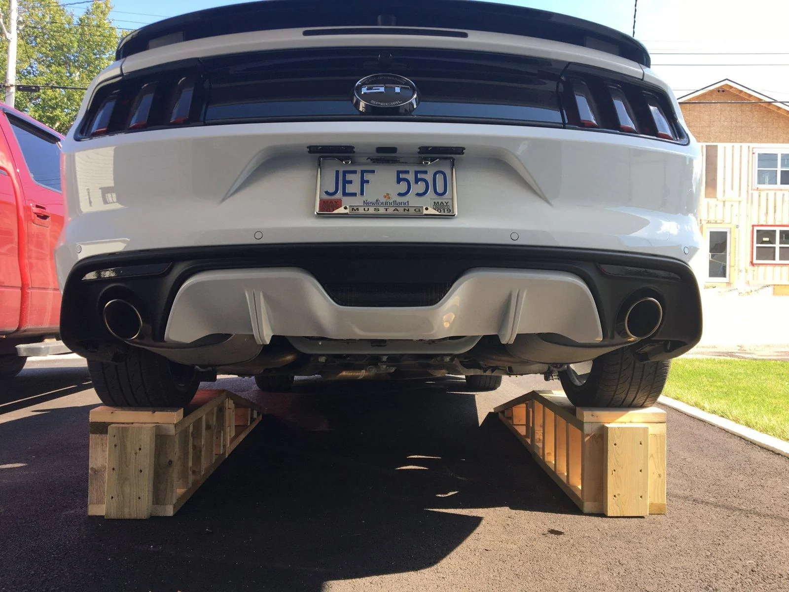

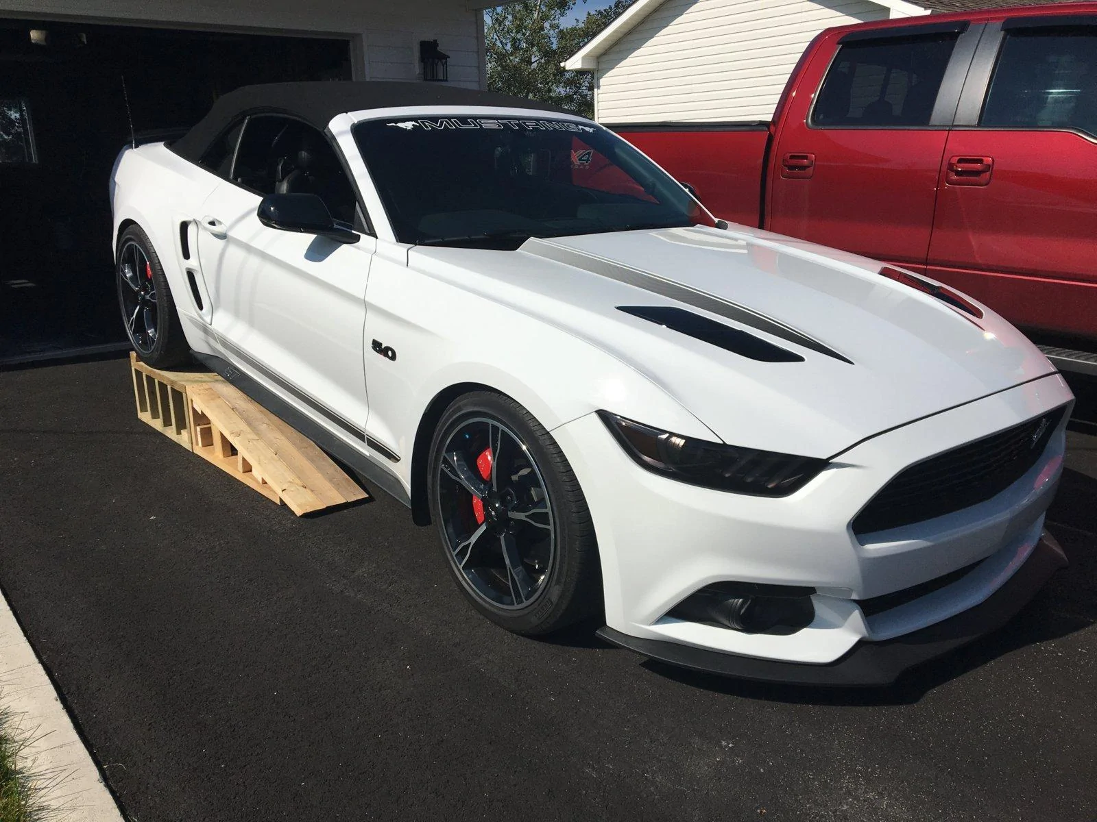

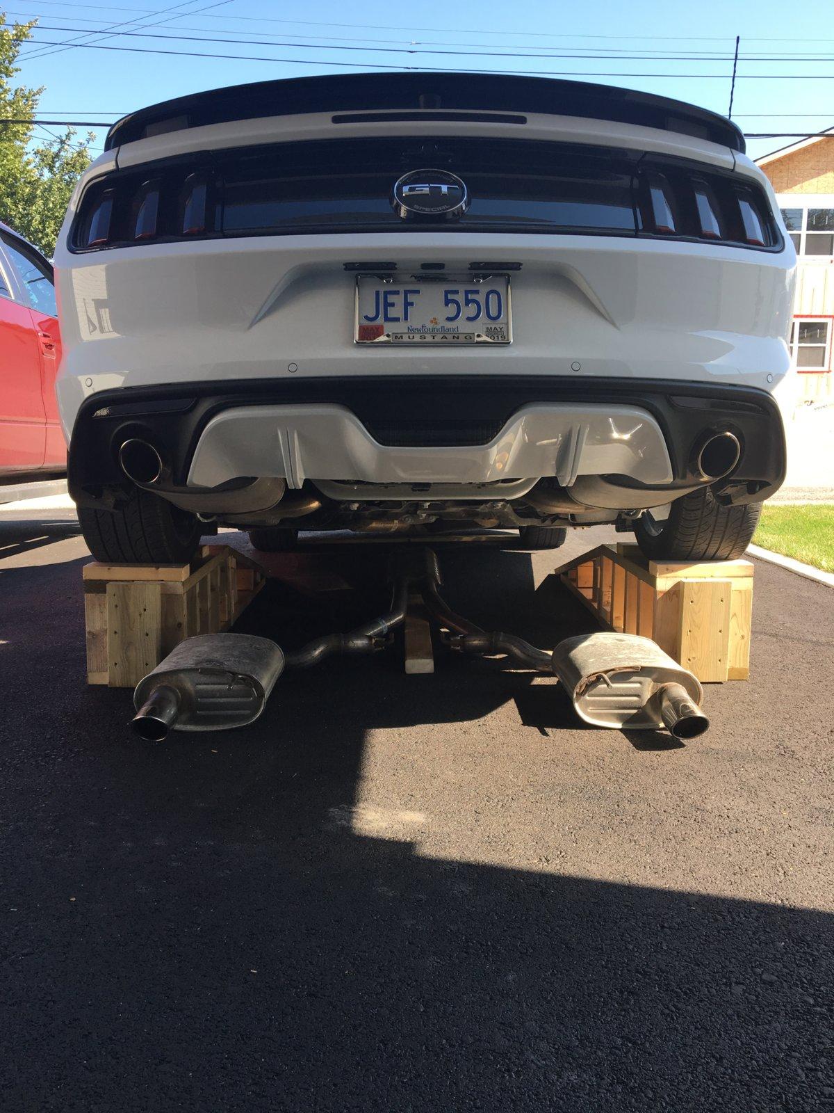

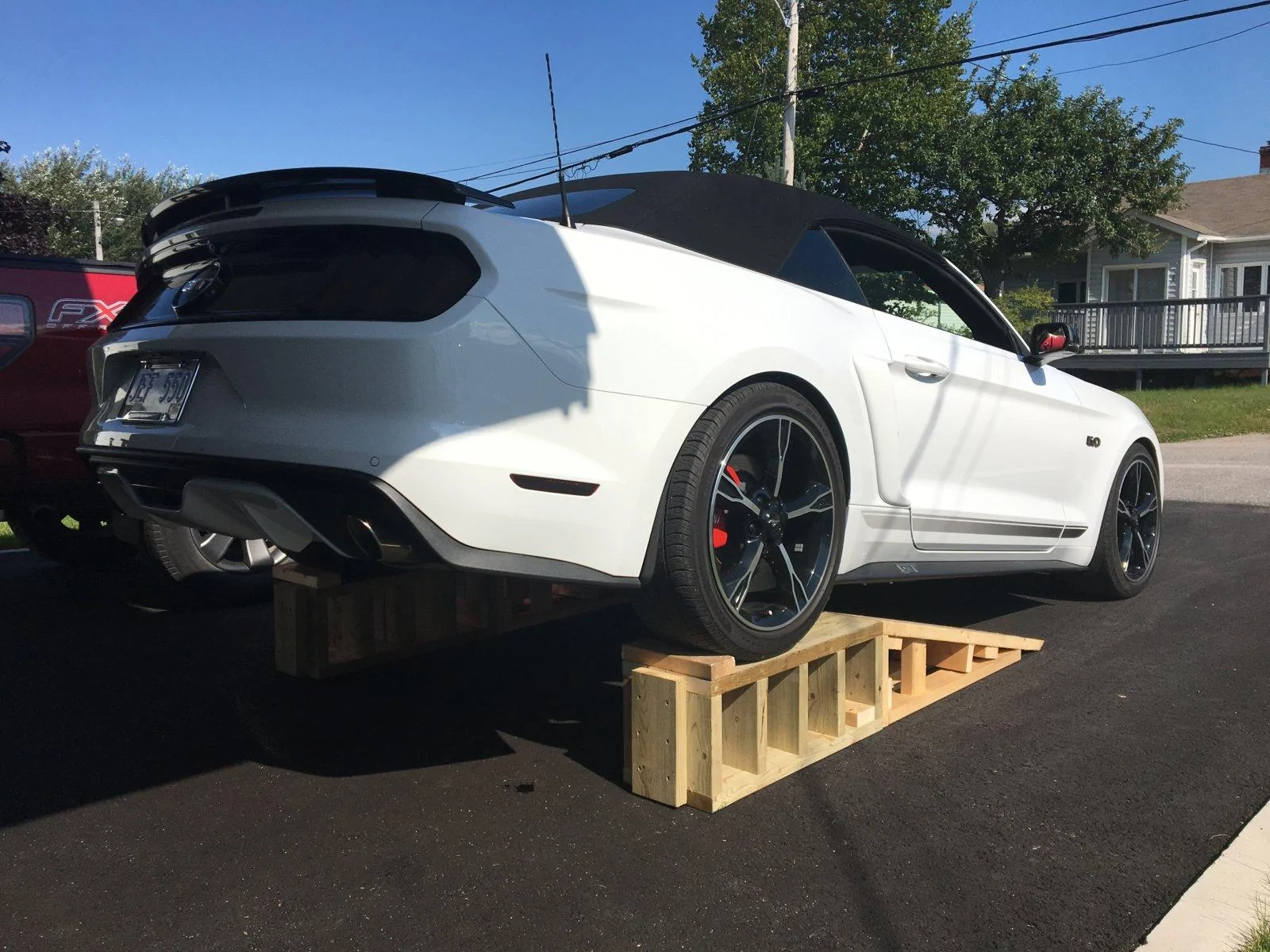

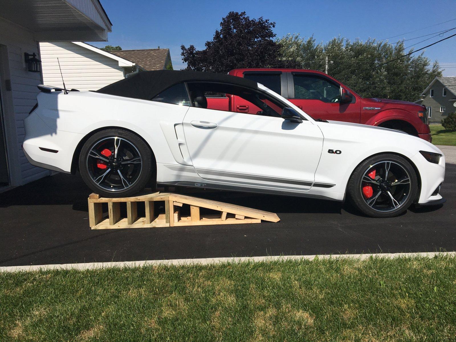

Well I am FINALLY prepping to install my CJ axle backs. This has been a busy summer and just haven’t had the time to be quite honest. Anyway, I didn’t have any ramps, and couldn’t find a set for the height I was looking for. (I wanted 12” and could only find 7-8”) and he sets I did try, just didn’t fit under my bumper properly ( ramp angle was too steep) so I built a set.
Here is step one in my quest for an exhaust exchange. I can party under there. LOL
...... and YES, I did block my wheels after I took these pics

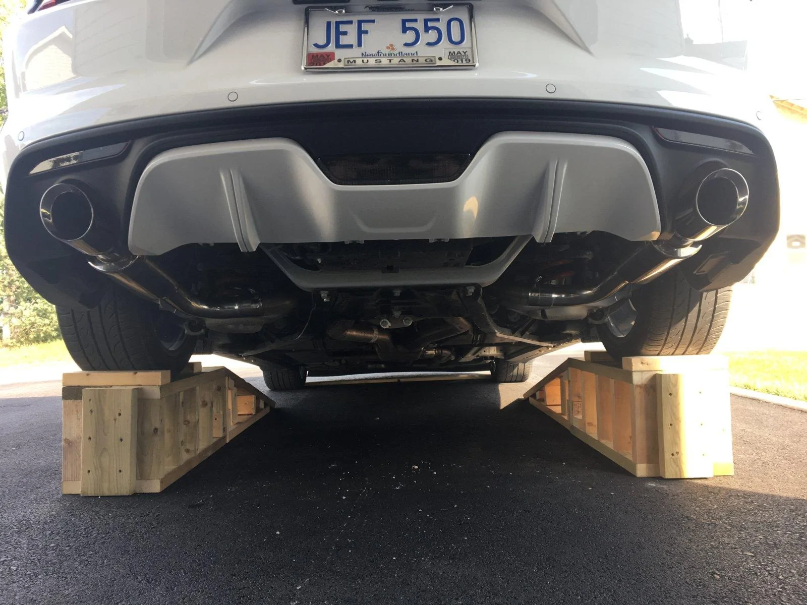

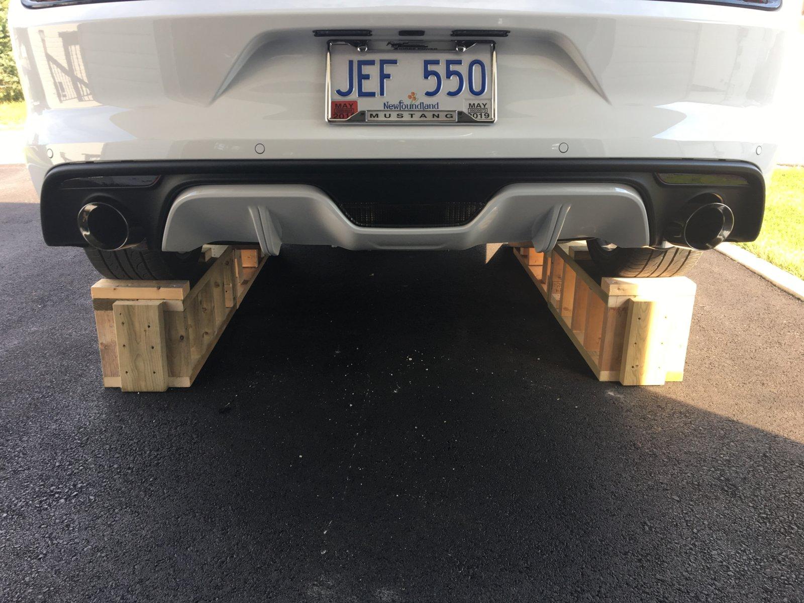

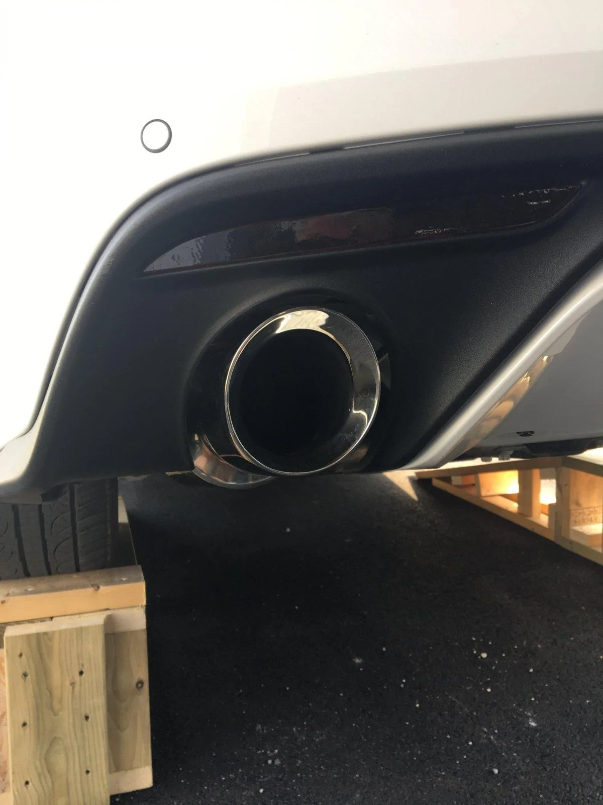

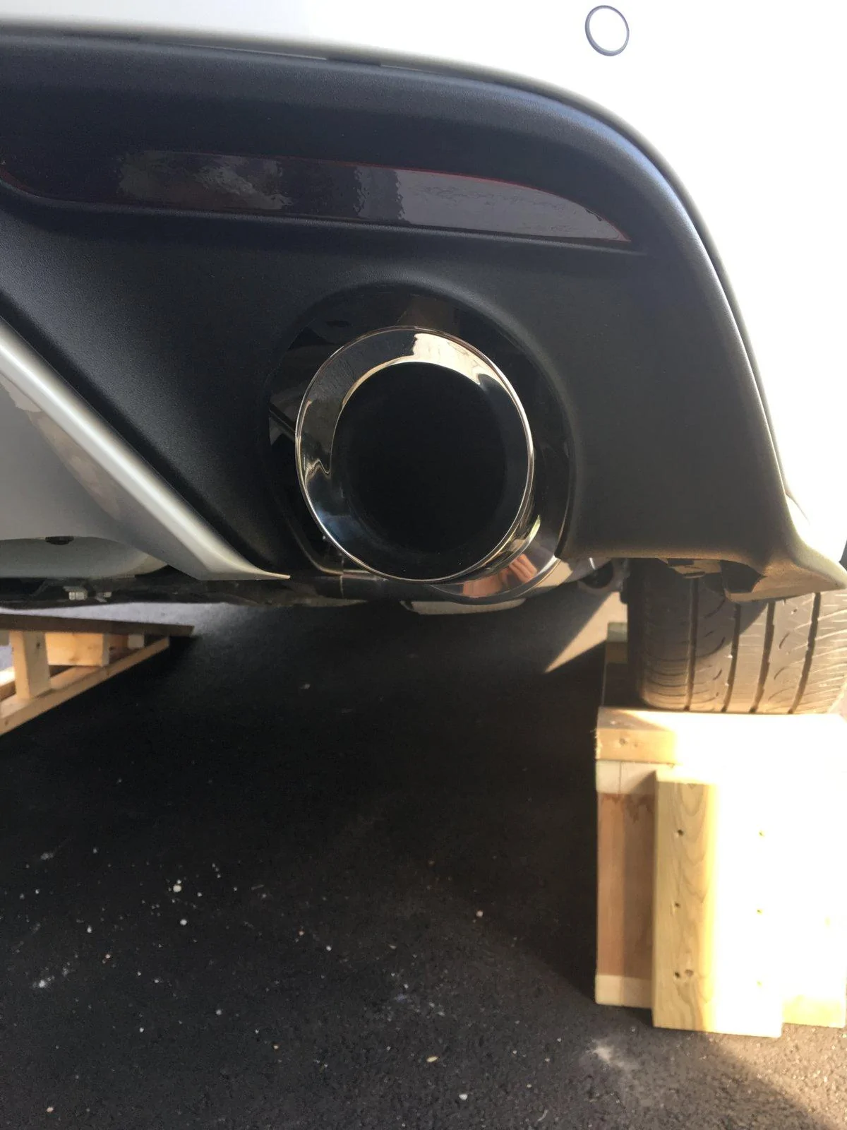

All changed out. Drivers side is set back about 1/4” compared to the passenger side. And passenger side sits a little lower. Overall I am pleased with the look. Maybe the stock did the same thing. I hadn’t really looked. LOL.
Now time for a ride.

Just a thought on the ramps, they look strong in compression but perhaps not so much in diagonal rigidity, was thinking this could be increased a lot by affixing another piece of timber along each side into both the horizontals and the uprights for the length of the ramp. Just my 2c as an aside...
Fordever
Mar 6, 2016
83
2,568
1,309
NL, Canada
Derek
2016 GT/CS Convertible
Hey Derek looking forward to your assessment.
I was thinking the same thing about the ramps. I have some 3/4” plywood here laying around and I will probably cut it fit for both side of each ramps and uprights.
This was my first attempt at building ramps, so there is always room for improvement.
Good observation and thank you for the advice. :clap:
