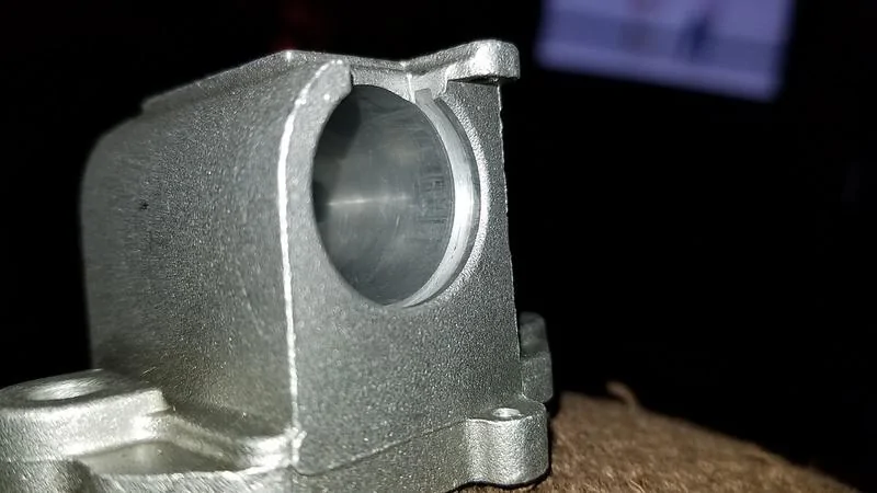

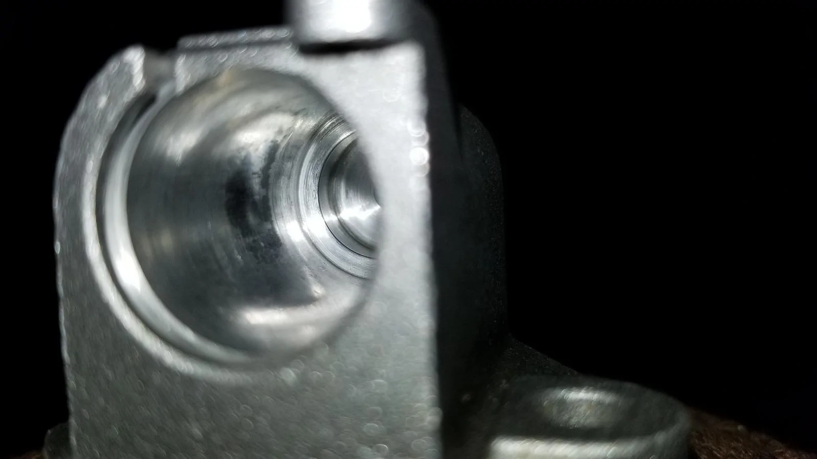

I had nothing else to lose so I took the front cover back off and inspected the drivers side cam tensioner and found this.
The plunger was riding in the bore at a slight angle and you can see where it was rubbing on one side in the back and the other side in the front. I replaced the tensioner and now the noise is gone. Apparently, if these things aren't perfectly tangent to the chain guide they side load the plunger.
