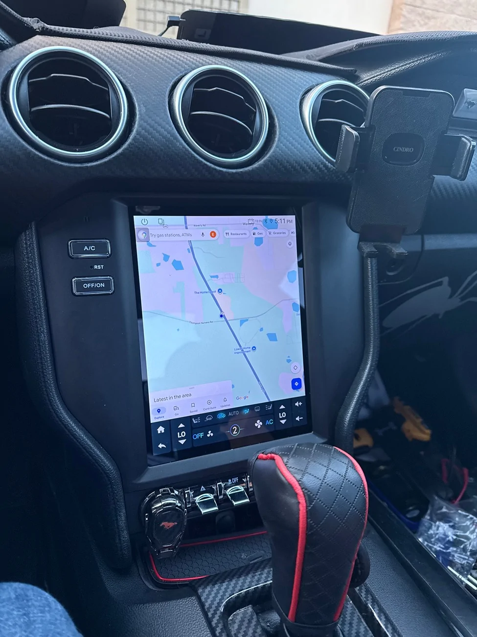

I got the 14" andriod head unit from ebay. The thing wants to act like I have dual ac control so it works sometimes. Anyone have the proper APK file to load on here for a manual ac operation? It's driving me crazy thanks for any help

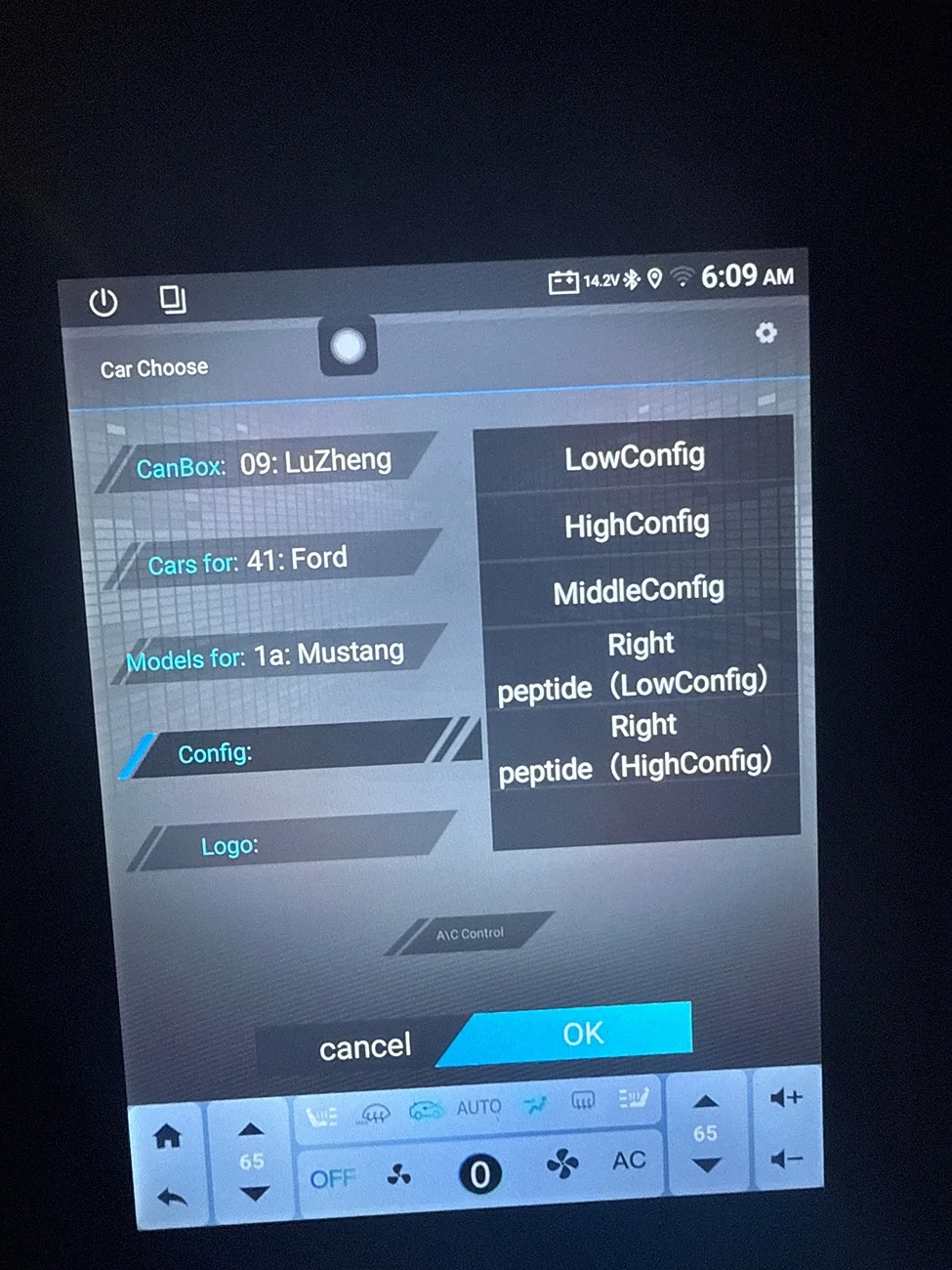

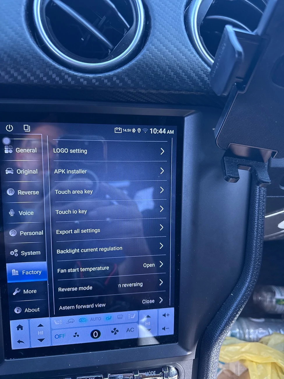

I have the same unit in my car. You have to use the supplied wire pig tail and jumper on the back on the unit. No instructions came with the unit for this. The wire was supplies. I got mine on Amazon the seller had a Tech number in the box. I have a base model no climate control.
