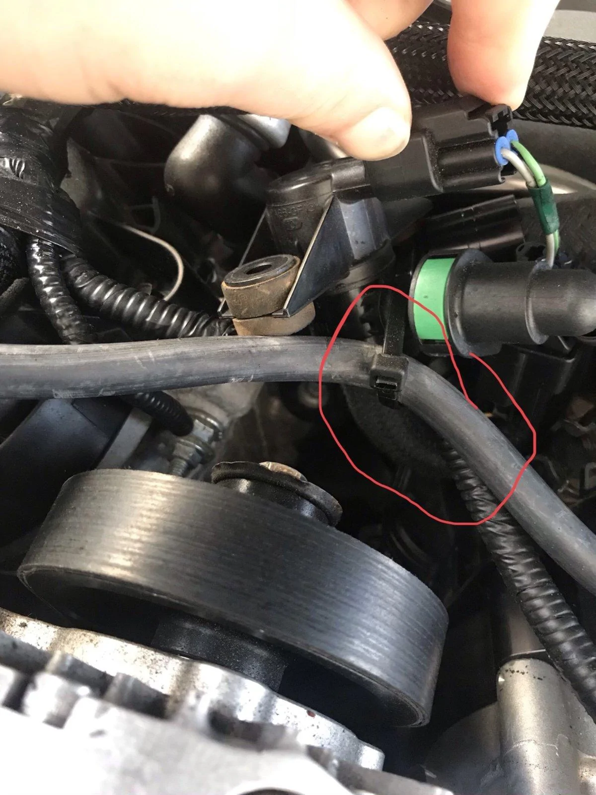

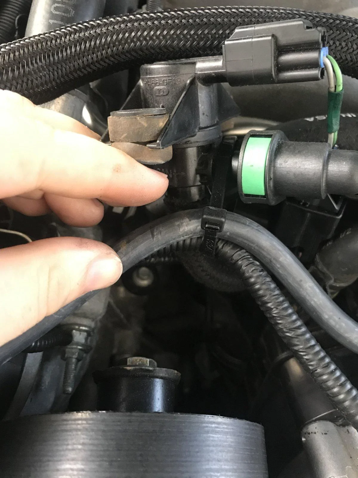

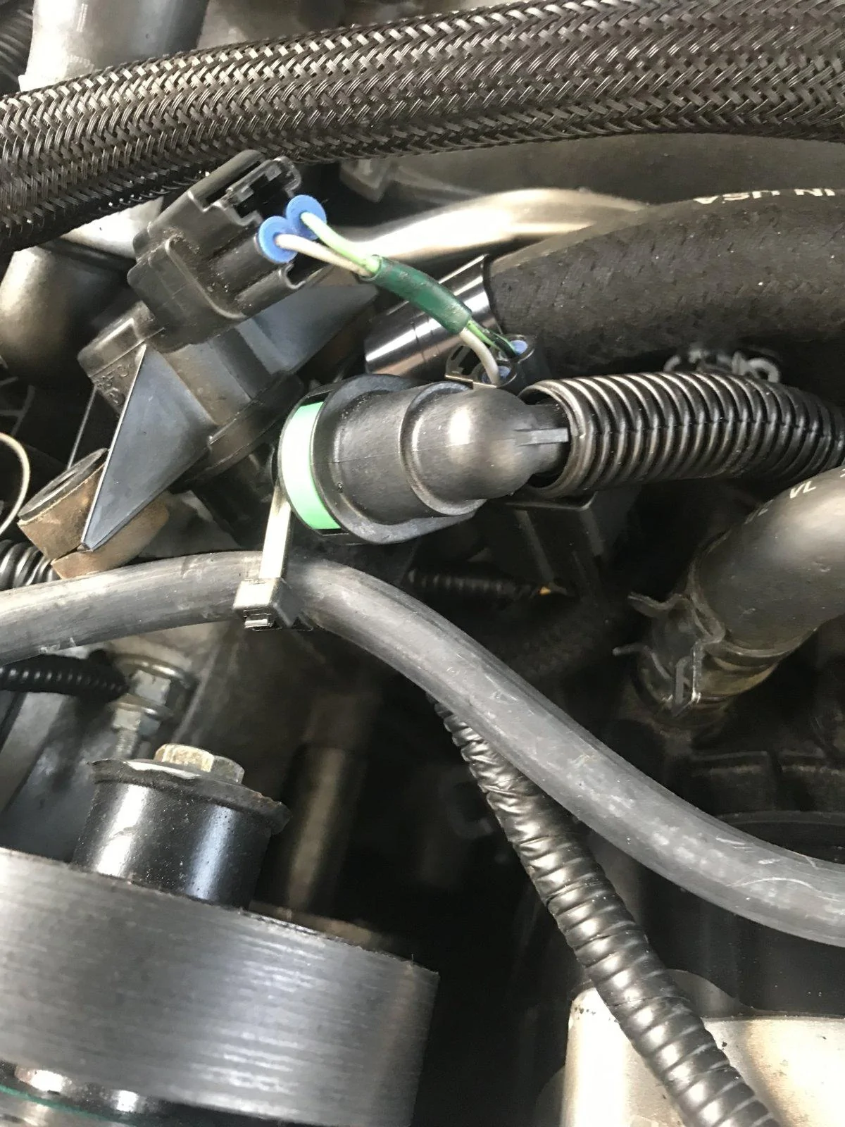

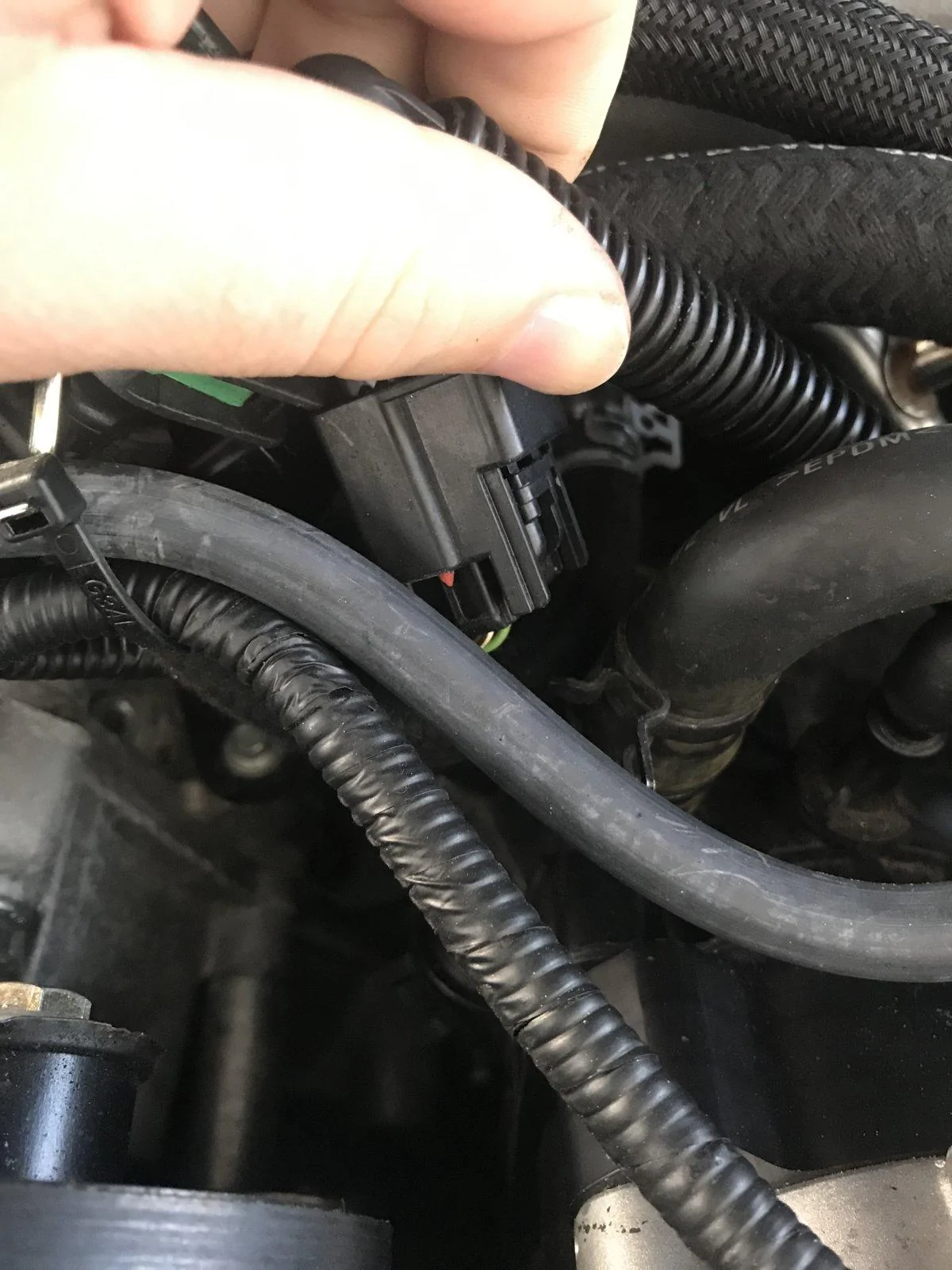

A shop installed the manifold for me, here’s some pictures, it’s pretty cramped for sure. If you find something wrong I’ll be forever in your debt lmao

Bingo, it's a little unclear but it looks like nothing is connected to the bottom of the evap solenoid. The green push lock is connected but a rubber hose has to be connected to the nipple on the bottom that goes to the manifold.

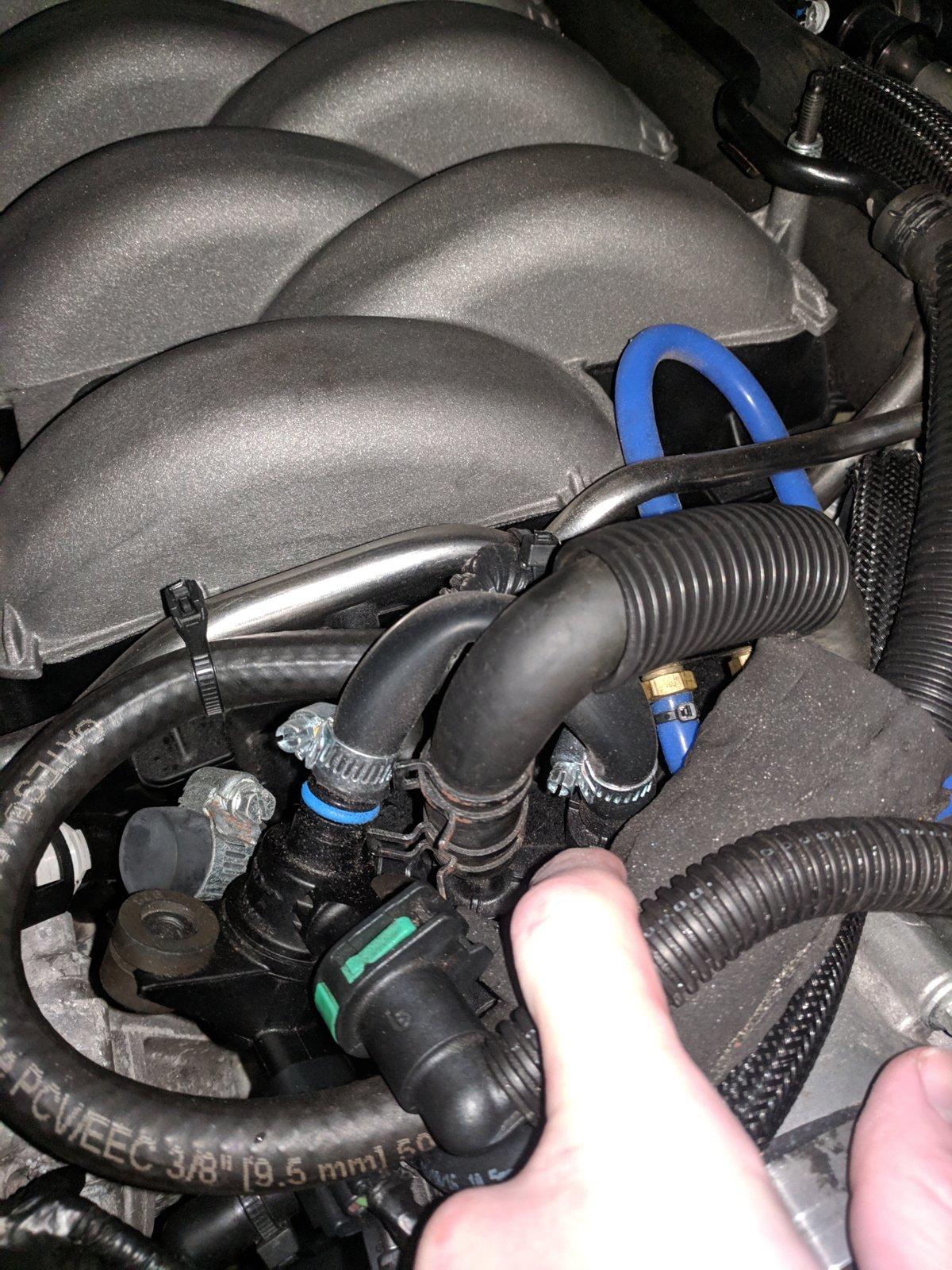

Here is a picture of how mine is hooked up and oriented.
Youres looks a little different than mine, maybe mine is upside down and thats affecting it? I thought it wasn’t connected either, but It is connected to the manifold, it’s the braided line circled in these photos. I thought maybe it could be the boost also, but I’m not sure.

Mine is upside down to make it easier to route the hose. Trace the hose back make sure its connected to the same spot as mine. Mine is boosted too no problems.
