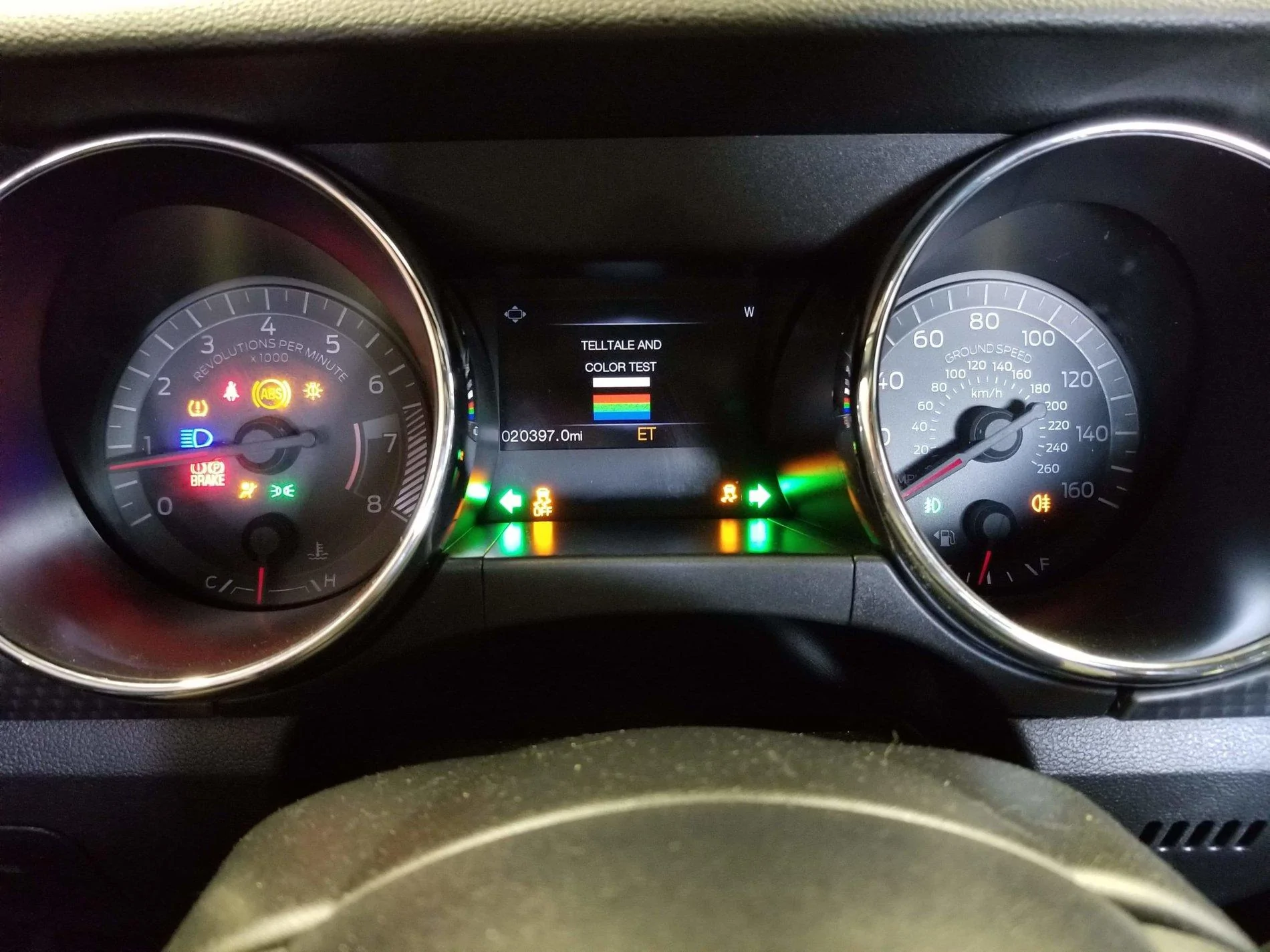

I bought a 2015 ecoboost from a used car dealer a month ago. After replacing a transmission speed sensor I noticed the scanner said I have a CEL for crank pressure, but no light on the dash. I ran that engineering test mode by holding OK while starting and still no check engine light. Am I overthinking this, shouldn't the CEL display in that mode or when in accessory mode?

I'm more concerned about not getting the light to illuminate at all. Like a burnt out bulb. How can I test the light is even working. It's not displaying in test mode or in accessory mode.

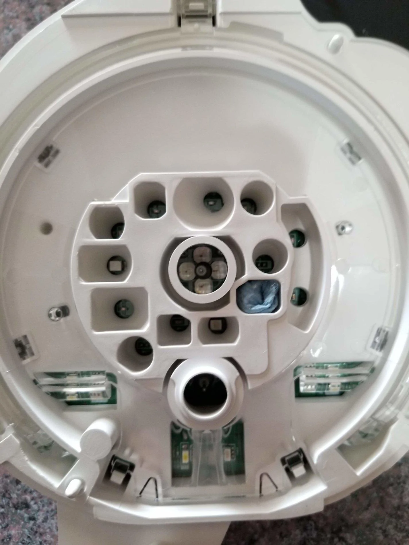

No codes about the cel not working, so I removed the cluster to investigate.
Found out why it's not displaying.
Balled up paper towel. I think the dealer has some explaining to do.

WTF, that's messed up. So is that how your dealer fixes s check engine light? I'd be talking to the general manager and/or owner of that dealership.
