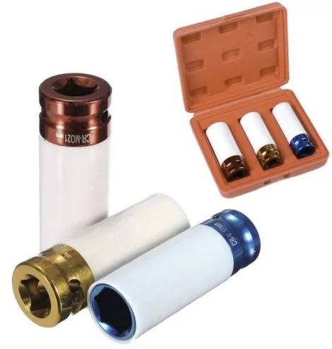

I would look into those specific lug sockets, they are coated with plastic on the outside (and on the inside I think) so as to not damage your wheels when they inevitably make contact.

+ those plastic coated sockets are great if you can find em. Otherwise some fresh tape over a metal thin walled lug nut socket wrench.
