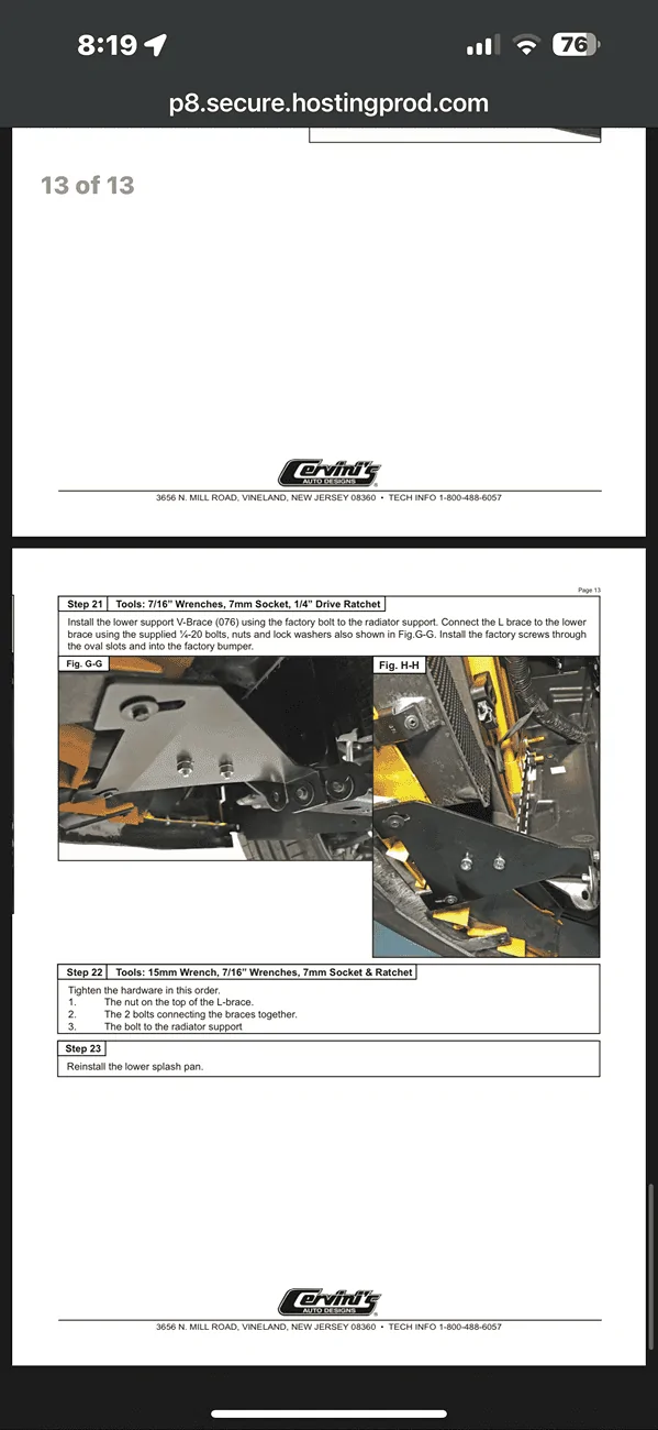

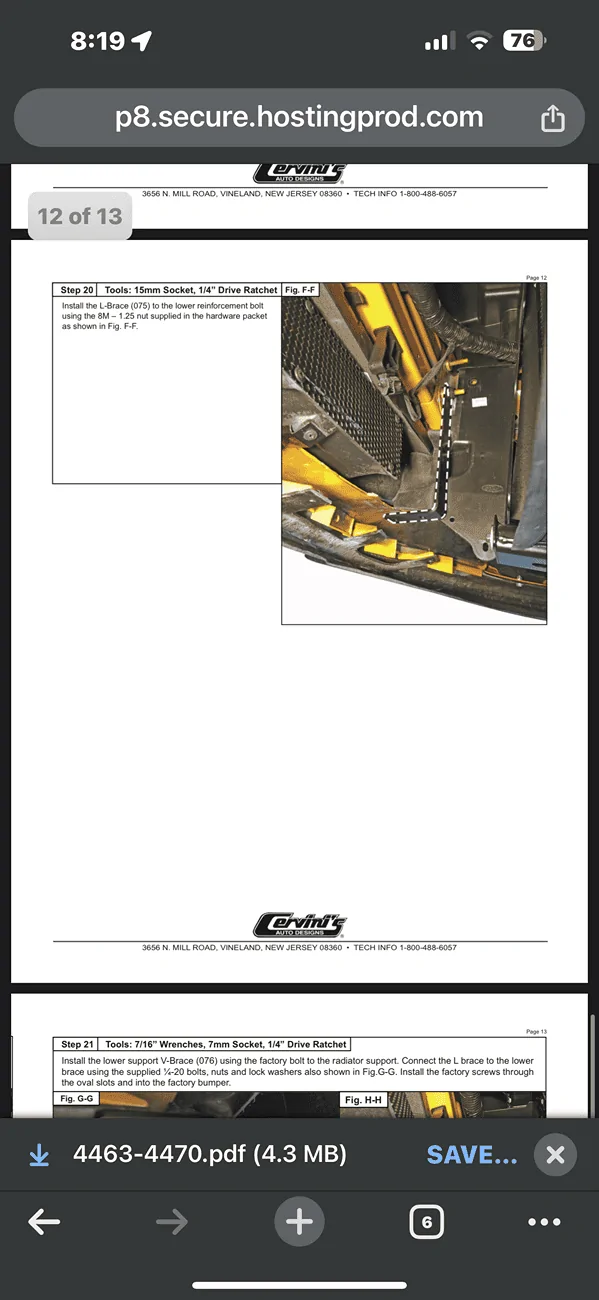

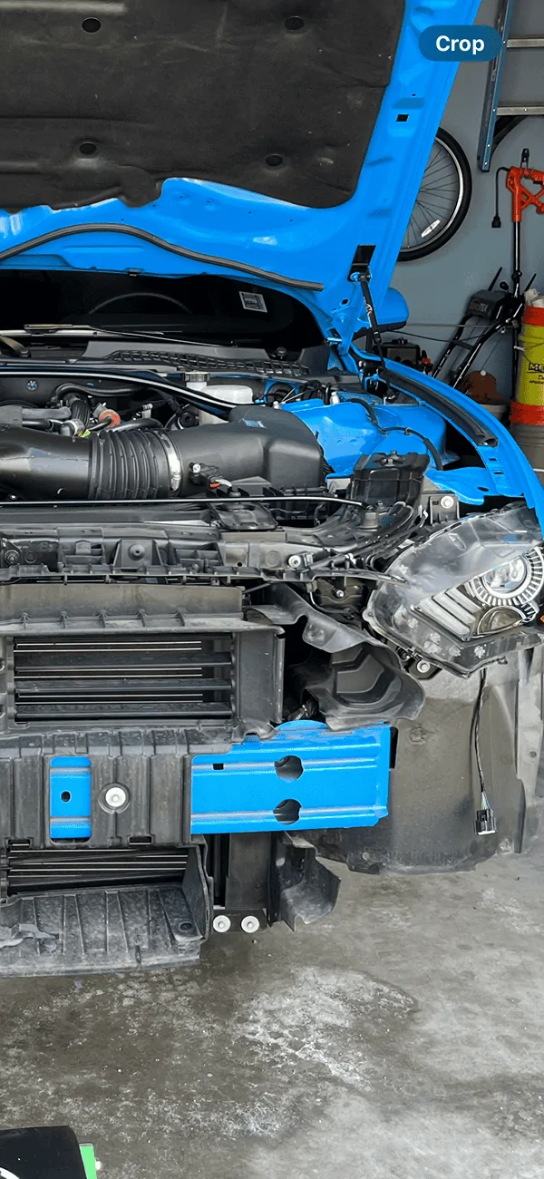

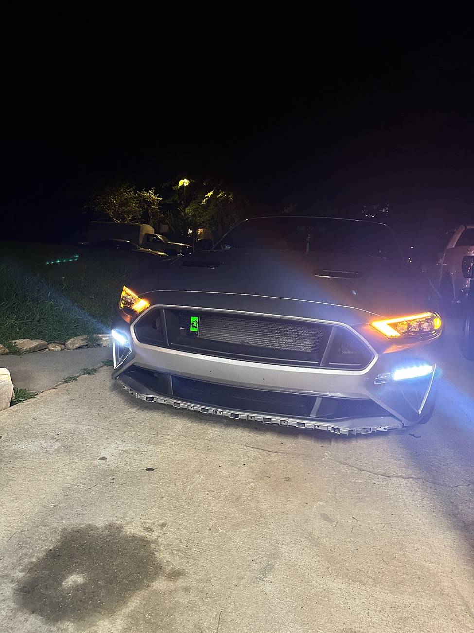

so I ended up having my friend help and install it last night. But we did skip the L brace and V brackets step. But I was thinking about it. Is it mandatory installing those? Or will I be fine? I read somewhere on a old thread that someone said without it and having an aftermarket splitter that has downforce will cause some kind of damage.. this is how it’s sitting now (waiting for new splitter to be delivered.)
