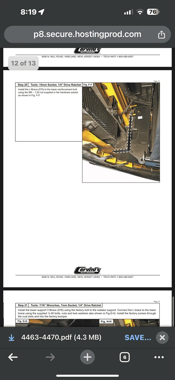

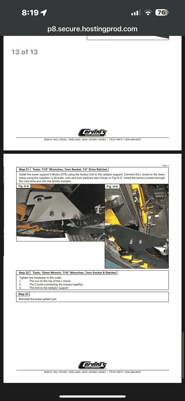

So me and my friend installed the Cervini C series grille last night on my 2020 GT. We ended skipping the installation on the L brackets and V braces. But I was thinking of it over night. Will it be okay without it? I read on an old thread that without it and having an aftermarket splitter that causes downforce at high speed you’ll risk of ripping the splitter or grille off and damaging your front end?.. is this true? Can anyone give me some input i on this? (Here’s a pic of how my car looks with it on, still waiting on MP Concepts splitter to arrive)

I would recommend installing them, especially if you plan to drive fast. Fast is relative, but there's a fair amount of downforce at speed that they are engineered to counteract. I'd hate to have a failure and wish I'd have taken the precautionary measures to install the brackets and braces.

This. I've read and heard a couple stories of people having their shit rip off at speed on highway pulls without the braces

Well thank yall. I will definitely install them. I’ll just wait for my splitter to come in so we can get it done in 1 day while the bumper is off.
