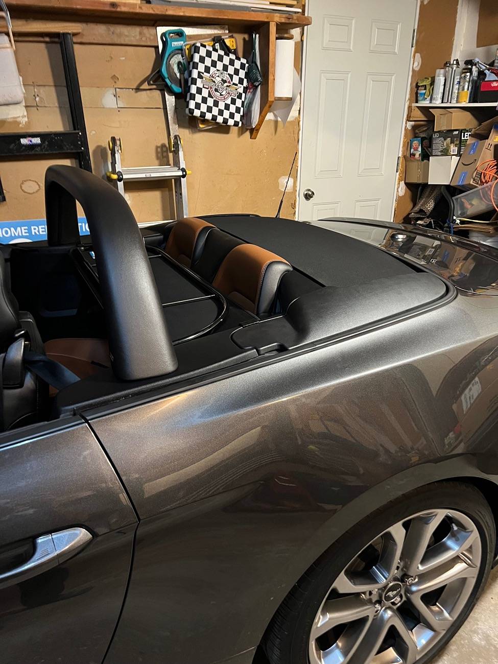

Here is mine - installed last September by myself.
Like the OP said, a lot of steps, but good installation instructions and the CJ Pony Parts installation video made it very doable.
To me, drilling the 2" holes in the trim panels was the most hair-raising. I checked the layout template about ten times before drilling.
Even had gone online to see what two replacement trim panels would cost?
Fortunately, it went well, looks factory - luv it!

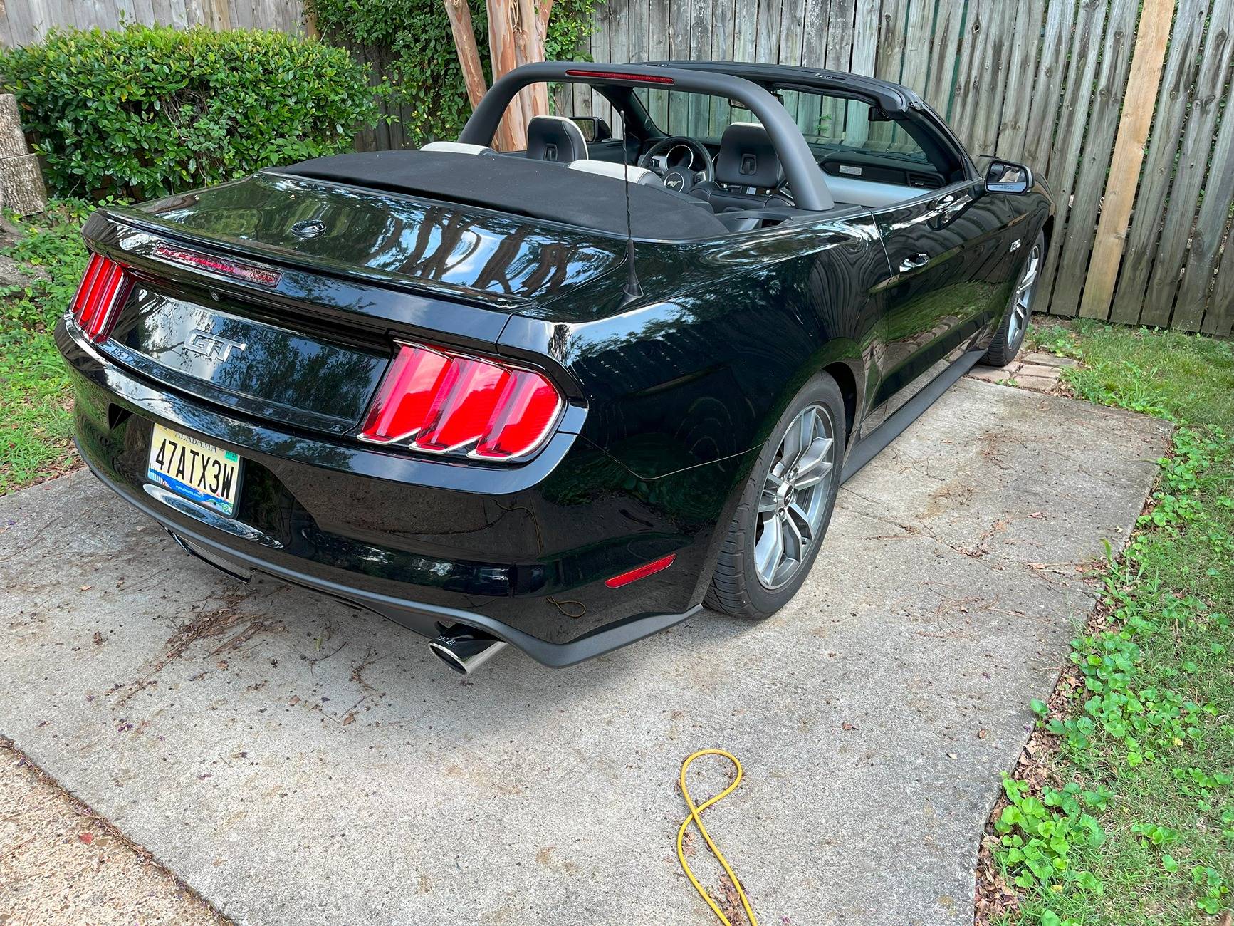

So I finally caved and got the CDC light bar. I liked seeing it on other cars online, but rarely saw it in person. Maybe once or twice at Cars n Coffee. My wife was against it, but she still lets me do what I want on my fun car, but made it clear she thinks I ruined the car now :-D Anyways, I didn't see any recent thread about them and only three very old threads. Figured I would post some pics and open the floor to questions - I installed it all myself after watching the CJ Pony Parts install video twice and reading through the instructions. There are a ton of steps, but it really is doable even by yourself.
I think it looks awesome!!
