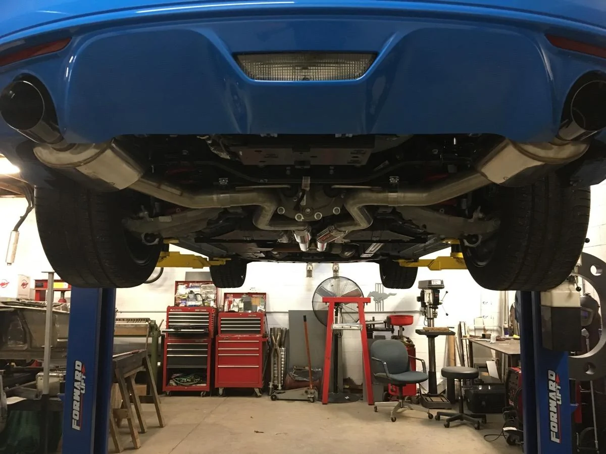

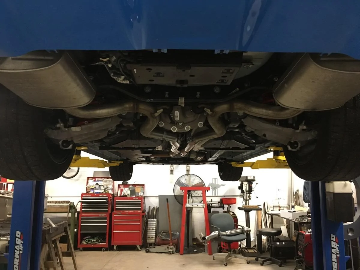

From someone who just ditched the stock mufflers w/ Steeda X pipe and went for an AWE Touring cat back, (sourced from Beefcake) I should have done this from the beginning and skipped the X pipe all together. MUCH improved exhaust note, simple install, no rattles or drone. I debated all the popular brands and didn't know how loud I wanted it. The AWE Touring is just right for DD use and won't attract the attention of too many law enforcement officials. I'm just happy to actually hear the exhaust with the windows up, like it is supposed to be. I would highly recommend this route.
Before
After
