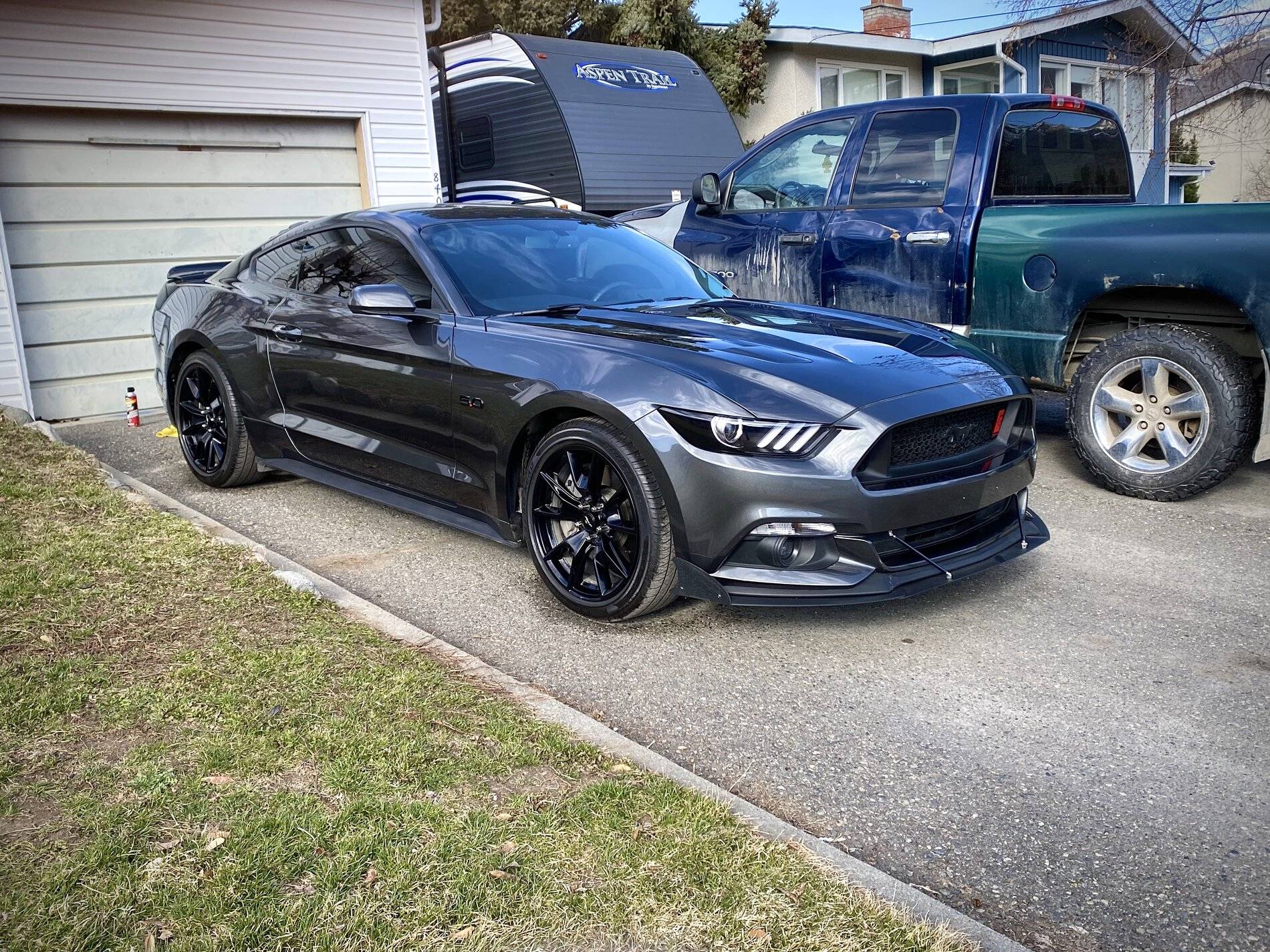

So I’m deleting my cats here in a few days and I’ve been searching forever to try to find a decent exhaust set up for it. I currently have the Magnaflow Tru-X resonated x pipe and muffler deletes and it sounds great. But I know as soon as I delete the cats that the maglaflow will become super raspy and that’s not what I want. So I want to put my previous resonator delete x pipe back in and run some axle back mufflers, I just don’t want something extremely loud because the cops here will literally crush your car over loud exhaust 😂 but I don’t want something raspy and I’ve been searching YouTube high and low and I can’t find an answer. Everyone just has screaming loud exhaust and that’s all I can find. Help? 😰
