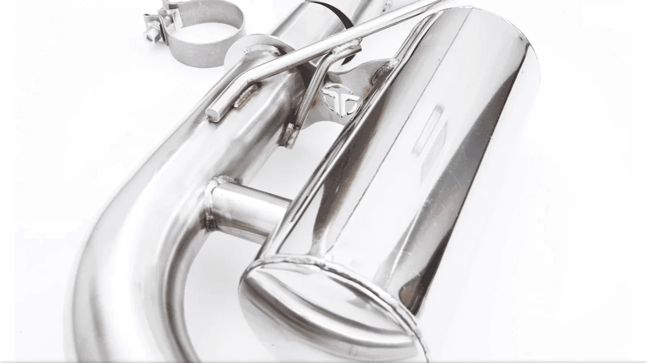

It’s the rear mufflers, they are not designed to cancel typical drone frequencies.
H-pipe, X-pipe, No-pipe will not change the drone.
At the end of the day it’s the rear muffler design that kills drone such as AWE or CORSA, Borla does a good job but I can’t stand fiber packed mufflers.
Rear Helmholtz should do the trick. Depends what you want to spend.
Something like this Thermal R&D gets it done effectively.

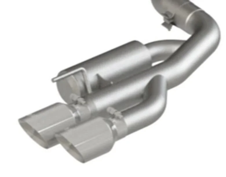

The MBRP race cat back on the 18+ mustangs has built in heimholtz resonators and no drone. I had it on my 2019 and loved it.

I installed milt thermal system recently, do you have any photos of the back half of your system? Trying to find out if thermal sent me the wrong system

The images I see online/in for sale posts. I'm here show the rear section to be a straight tube with the helmholtz being separate (basically a muffler delete with a tube of to the side). The set I received looks like plain old mufflers and doesn't match any photos but thermal doesn't offer photos on their own website so I can't compare it
I know on the 18-23 the helmholtz is built into what looks like a standard muffler. I wonder if they changed that for the 15-17s
