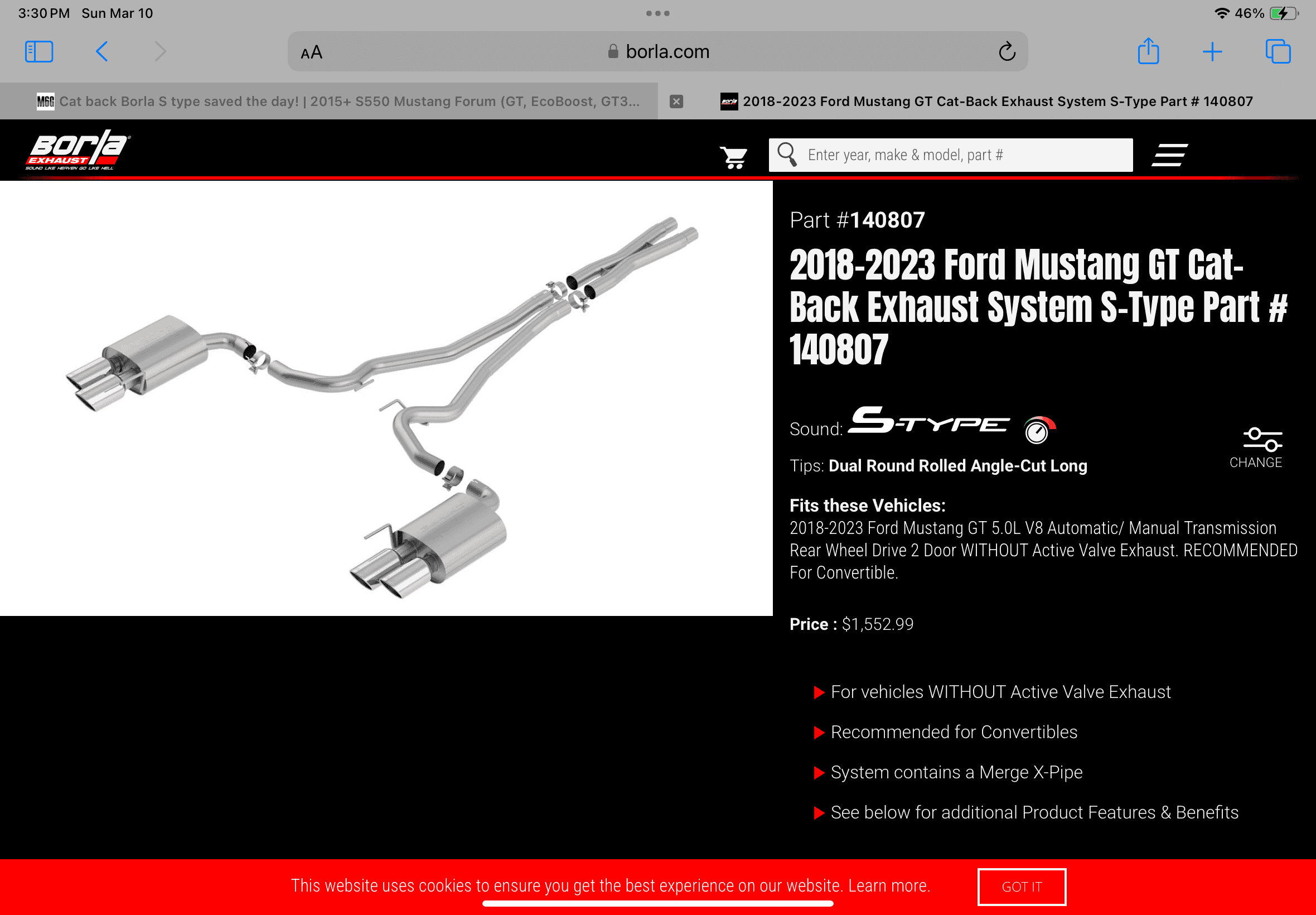

Did you use the “ convertible “ S type or the regular 3” S type?
The convertible S type, there’s not supposed to be room for the 3 inch with the extra cross bracing that convertibles have.

Well yes and no. The 3” will work you just have to put a spacer in between the braces and the body. Parker Performance makes a kit. Main reason I was curious is the Vert cat back looks like it has a resonator similar to the factory one but the coupe version does not.
No resonator, it came with an x-pipe. I think the touring comes with a resonator with an internal x-pipe.

Ahh ok that could be where I was mistaken. I was thinking for some reason they only had the touring for a Vert. I did an H pipe a couple years ago but I want to do a full system in the future.
