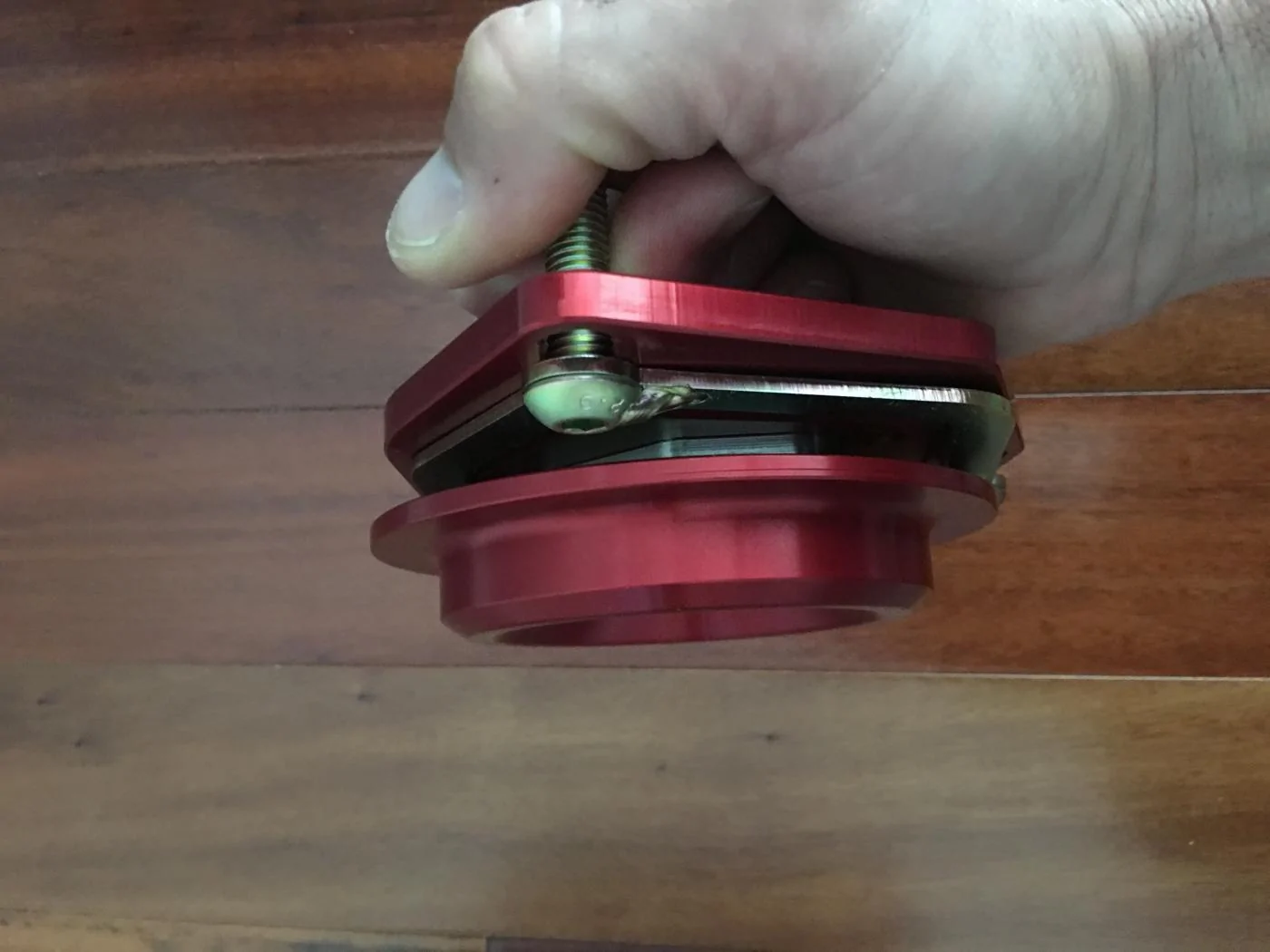

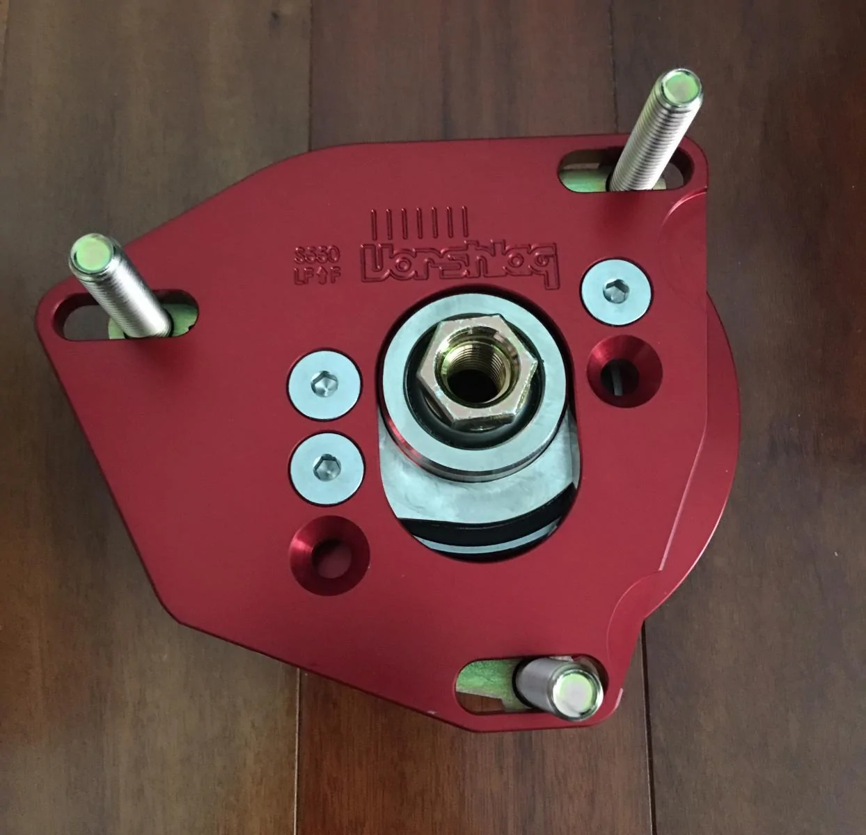

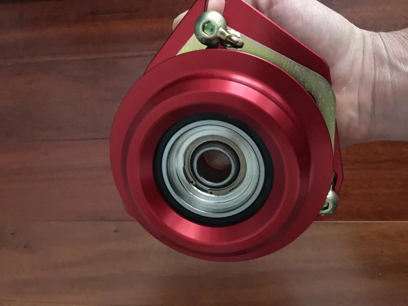

Vorshlag it is. Going to get some camber bolts until i can afford them though.

Another vote for Vorshlag plates. I run them with my JRZ's and they are absolutely fantastic, really nice pieces. Probably still going to want the camber bolts in addition to the plates though if you are looking to run big negative camber. With my plates maxed out I'm getting -2.4*.
