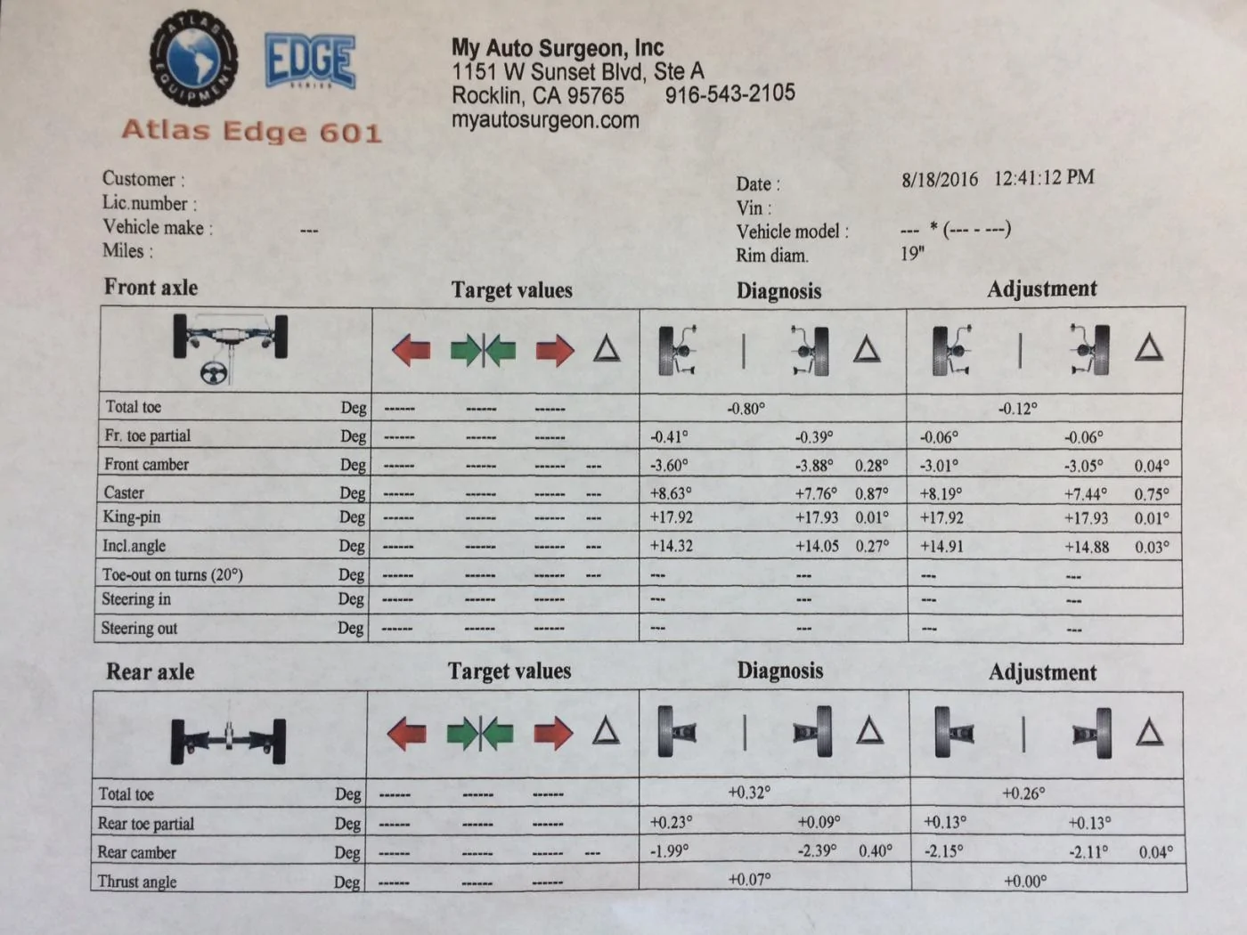

Hey guys, on this topic, have any of you guys with lower height springs + camber-only (not caster also) plates found that the non-adjustable caster ends up being different from left vs. right?
I'm at the alignment shop now, and they are saying that at my target of -3 deg camber up front, they are seeing -6.xx deg of caster on one side, and -7.xx on the other.
BMR Handling Springs and Sways on middle position, Koni struts, Steeda camber plates, and clearanced strut towers to allow max camber.

FYI - here's how the alignment ended up. Very happy with my camber and toe at both ends, and caster ended up being 0.75 deg different L/R.
The tech was pretty knowledgeable about track setups, and said that this could be due to my local track being 75-80% left hand turns when run CCW, which it almost always is. More g-loading on that side can make all the tolerances in the front end components creep to one extreme.
