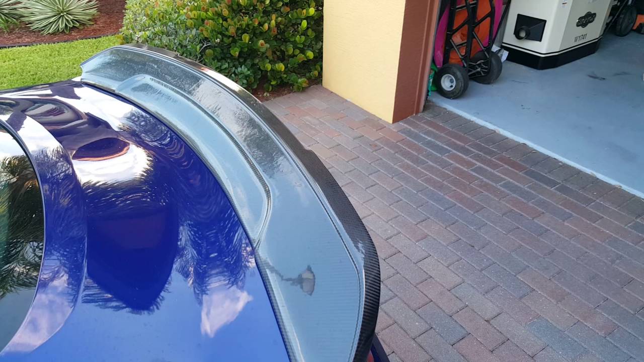

Has anyone installed the gt350 track pack spolier from carbon dynamics? If so did you already have a factory deck lid? Went to remove the factory deck lid only to find out that the bolts that hold it down into place are only built into the factory decklid. Looks like i have to buy bolts just to make it work and cover up un used holes now. Anyone have this issue?

Which style spoiler do you have? I have this one (Not my car though).
You do not have to take off the factory decklid at all. There are two 7mm bolts on each side off the trunk (inside) Remove those and then remove factory spoiler. Remove left over glue and fit new spoiler. It should line up perfectly.
Some people have had issues with Carbon Dynamics. I didn't and the spoiler looks great (Though I'm considering getting the GT 350R wing type spoiler instead).
Definitely don't remove the decklid though. I just replaced my decklid a few hours ago with the matte version. There's no need to take it off. You shouldn't have to buy bolts at all. Not sure how you are going about this but it was an easy 30 minutes top install for both decklid and spoiler.

I have the one in the pic you posted. The bolts are built into the factory premium deck lid.

I have one of these. The clear on the top is fading :/ Shame because it’s a great looking spoiler
