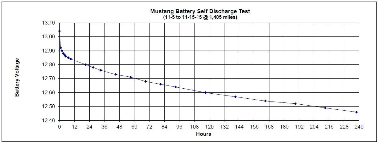

The normal parsitic drain isn't much (less than 20 miliamps). My GT can sit for 10 days and starts up just fine. Here's the battery voltage drop over a 10 day period. Nothing was disturbed on the car during the voltage measurements across the battery, so if you're opening the doors, etc all the time it will drop the voltage down more than what this curve shows.
