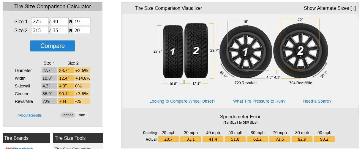

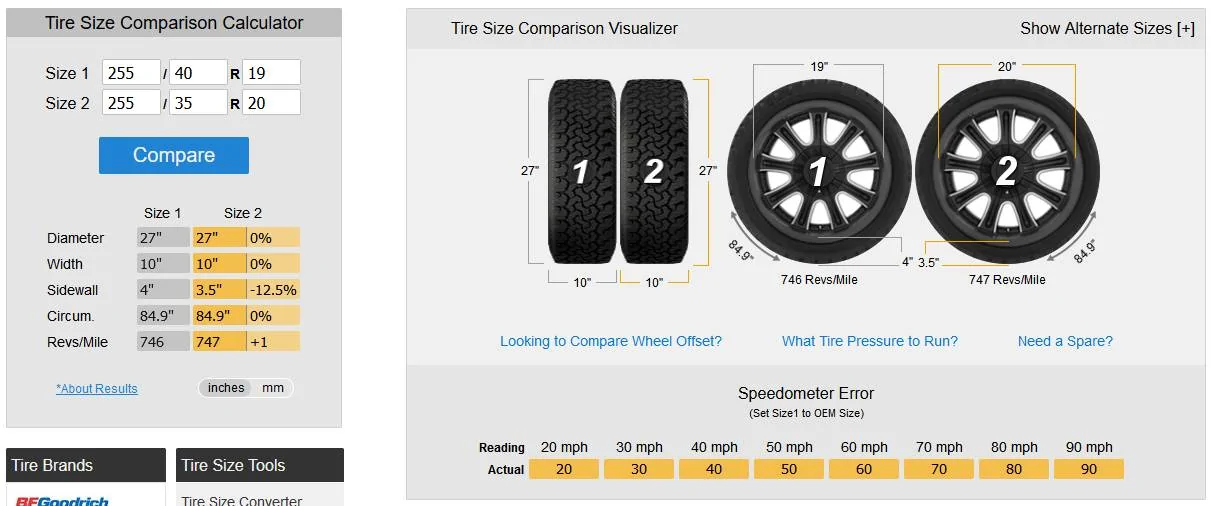

It looks like going to a 20" wheel might work. Would this be acceptable / safe to use? I'm not going to crash wildly or upset the handling with these sizes? 😁 Going to 255/35/20 and 315/35/20 means I could fit Vredestein Quatrac Pro tyres (which I've had experience with before on other cars).
Thanks again.
