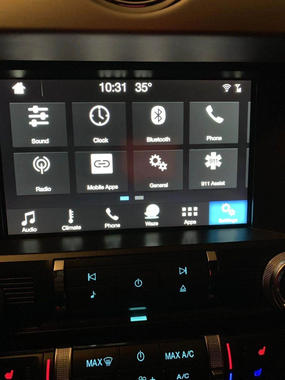

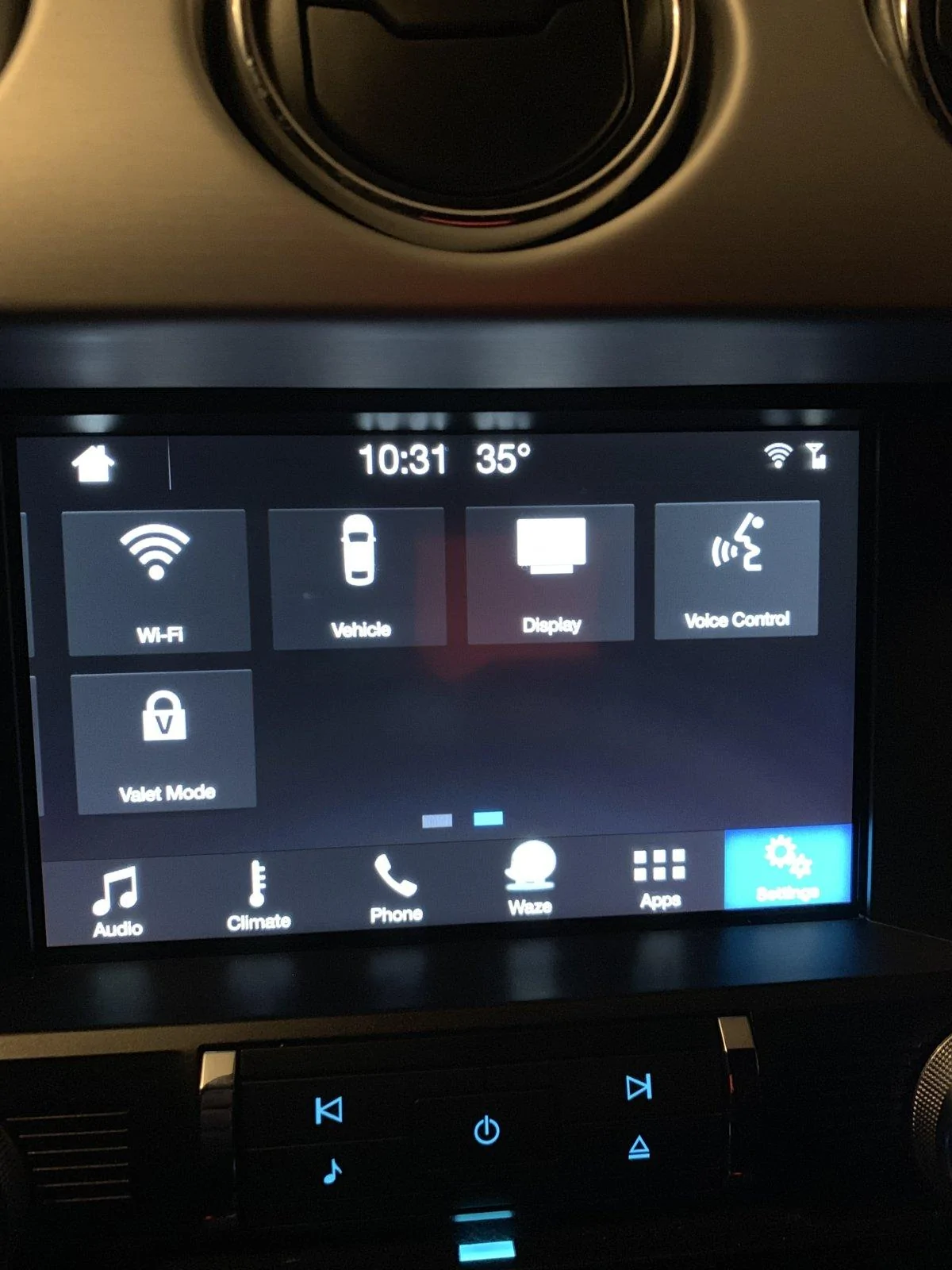

I confirmed that I’m running IOS 12.1.3. When I connect the lighting cable, I do see the charging indicator o my iPhone. I get no security messages. Here are my screens. I’m at a loss.

So here's the unknown - for me at least, since I don't recall - I'm not sure if the Car Play settings (in Sync 3) displayed before I installed my hub ...Well I tried everything in the link provided except changing back my IOS version and nothing. Still no Carplay icon. Funny thing, my son connected his Android phone and Android auto was available. I did disable it afterwards. I’m at a
Which iPhone do you have? Is your iPhone currently setup via bluetooth to connect to your car? If so, I would try going into bluetooth settings and forgetting Sync, then hook your phone up via USB. My iPhone isn't set up for bluetooth with my Mustang, I just always plug it in via USB. There are times when I plug it in and Carplay doesn't work but that doesn't happen very often. When you plug in your phone the first time using Carplay, you should be seeing a pop up with privacy terms you have to accept. Make sure your phone is unlocked as well when you plug it in. Sometimes Carplay won't turn on until after I unlock my phone. I think the new restrictions in iOS 12 sometimes mess things up.They did tell me they ordered and replace the media hub but didn’t give me the old one. I know it’s new because it includes a new power receptacle and the USB connector lights up. I’ll try to pull out the hub and check the part number tomorrow. Thank you for the help you offered.
