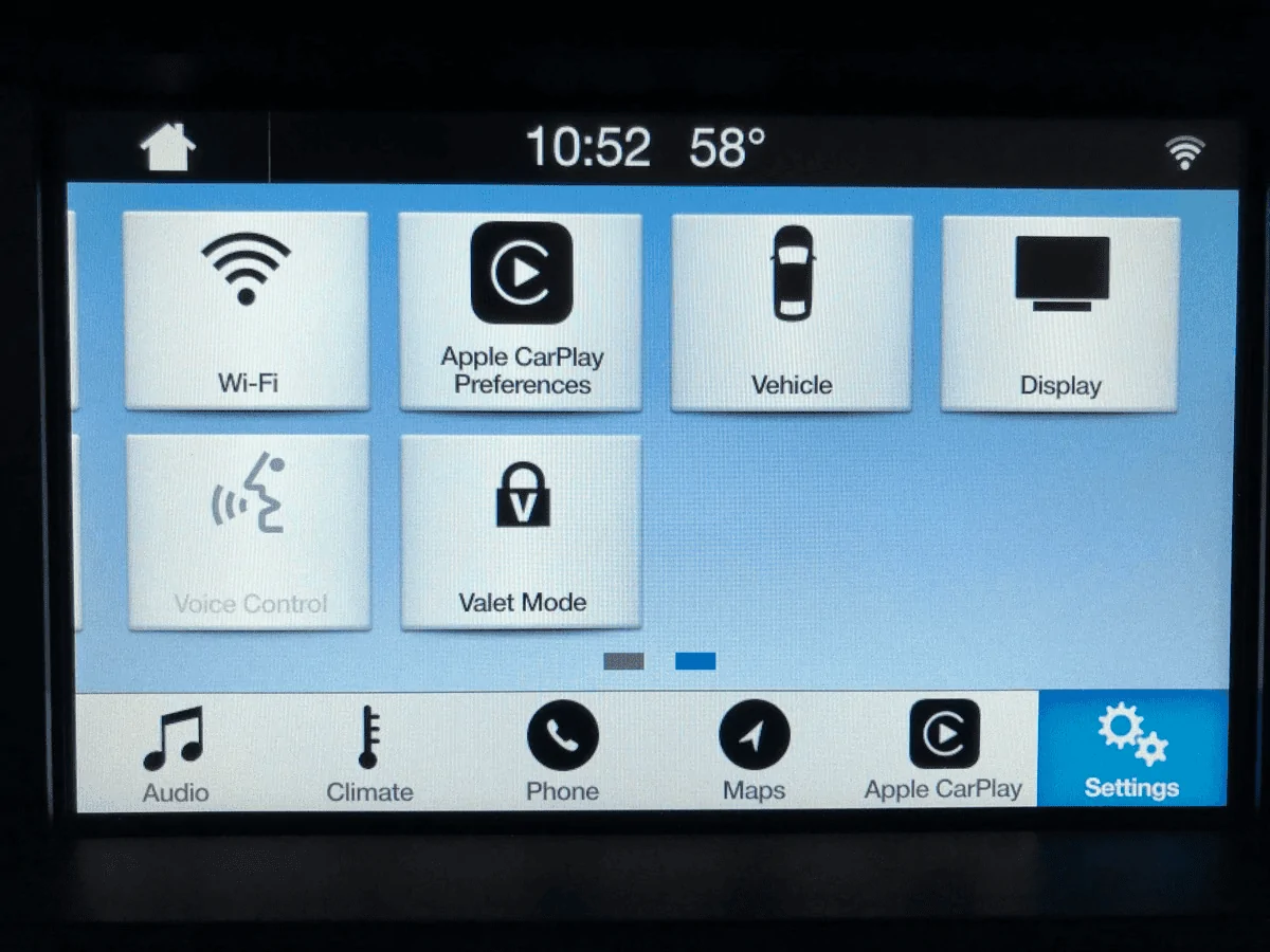

Just had my Ford dealer update my Sync 3 to version 3 and install a new hub. I have Waze but no Apple CarPlay. I have no idea why. Any ideas?
Do you have the CarPlay settings in your Sync3 settings available when your iPhone is plugged in? If yes check if CarPlay is disabled for your iPhone.

No I don’t see any indication of CarPlay. I see Waze and if I press the “speak” botton on my wheel I get Siri asking questions. I have no CarPlay user interface available that I can see.

OK, a few things (assuming you're up-to-date on iOS, car is on, etc ...)
When you connect your iPhone to the Lighting cable, do you see a charge indicator? That means the hub is at least "working", in terms of being powered.
On your Sync 3, with the iPhone attached, do you see the CP icon on the bottom row of icons and/or if you enter Setting on Sync 3 do you see a CP settings entry (it's on the second page - i.e., you have to swipe once right-to-left)?
Like so (shows both the CP icon and the entry in settings):
At first connection to the headunit, you should get a security prompt on the device/phone confirming you want to register it as a CP device. Then, when you go into settings >> Carplay in Sync 3, you'll see the device name listed - also, when you go into Settings on the phone, settings >> general >> carplay, you'll see the name of the vehicle device listed (I have both a Sync3 and a UConnect for our two cars).
