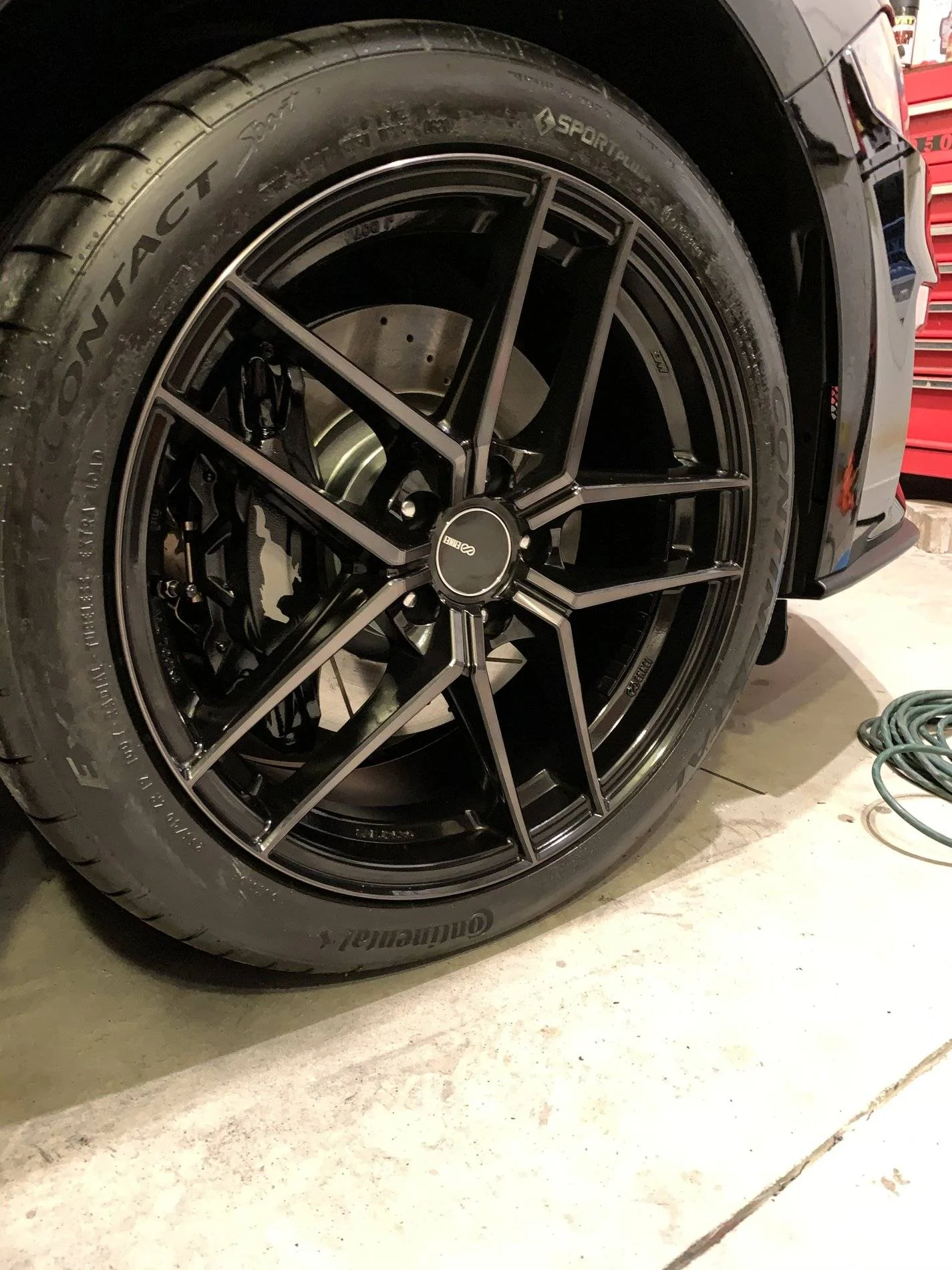

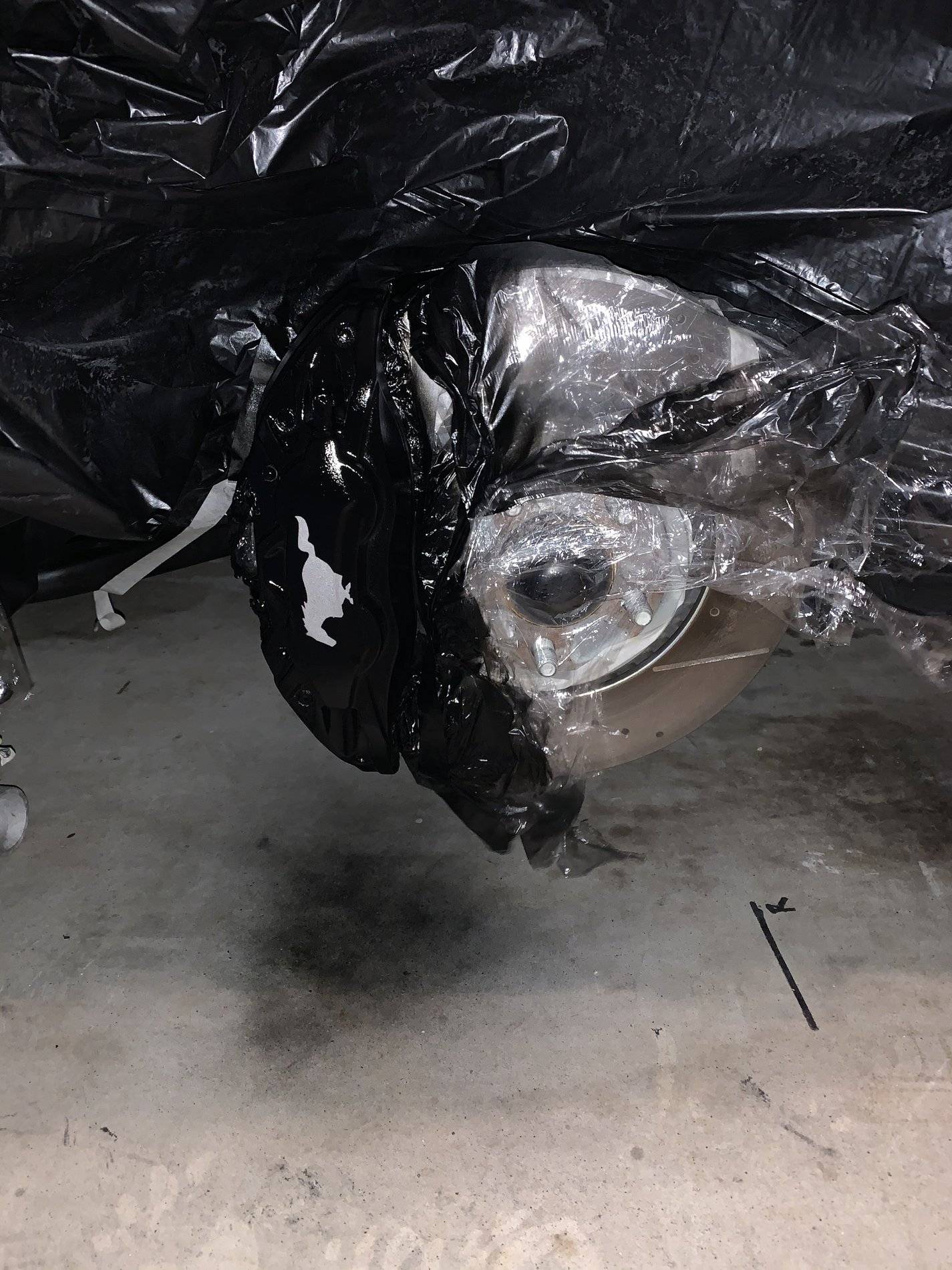

Wanted something a little different I haven’t seen yet, so I decided to paint the calipers but need something besides covers or “Brembo” logo’s on it. Wanted to keep it traditional or to refer to the Mustang..so here’s what I got...

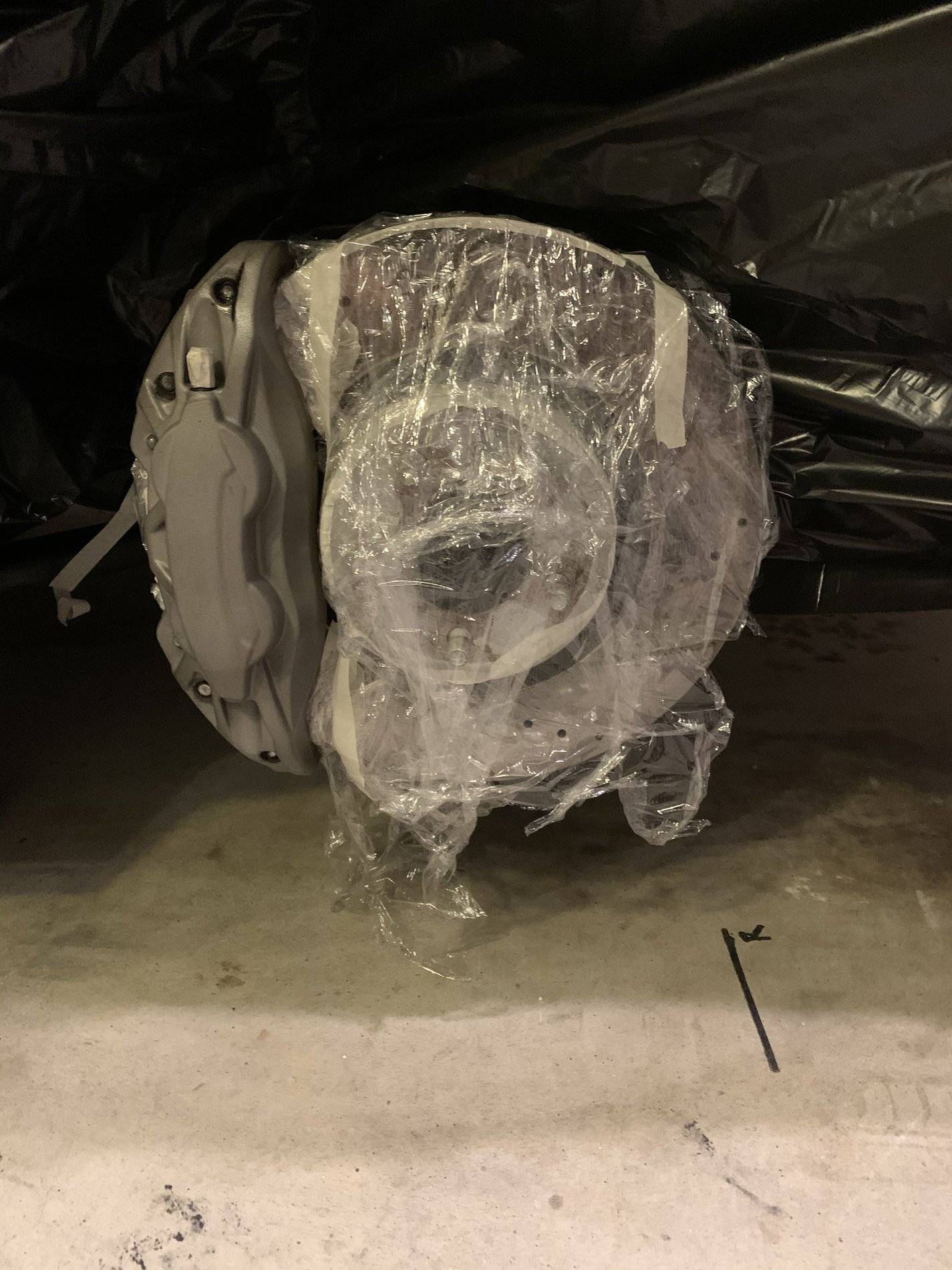

Looks good. What paint, and how did you do the stencil?
I used the VHT gloss caliper paint, and used a vinyl stencil from a Cricut , 2 coats within 10 minutes, 3rd within 5, remove the stencil and 2 coats of clear enamel within 10 minutes of each, set for 2 hours and replaced wheel
