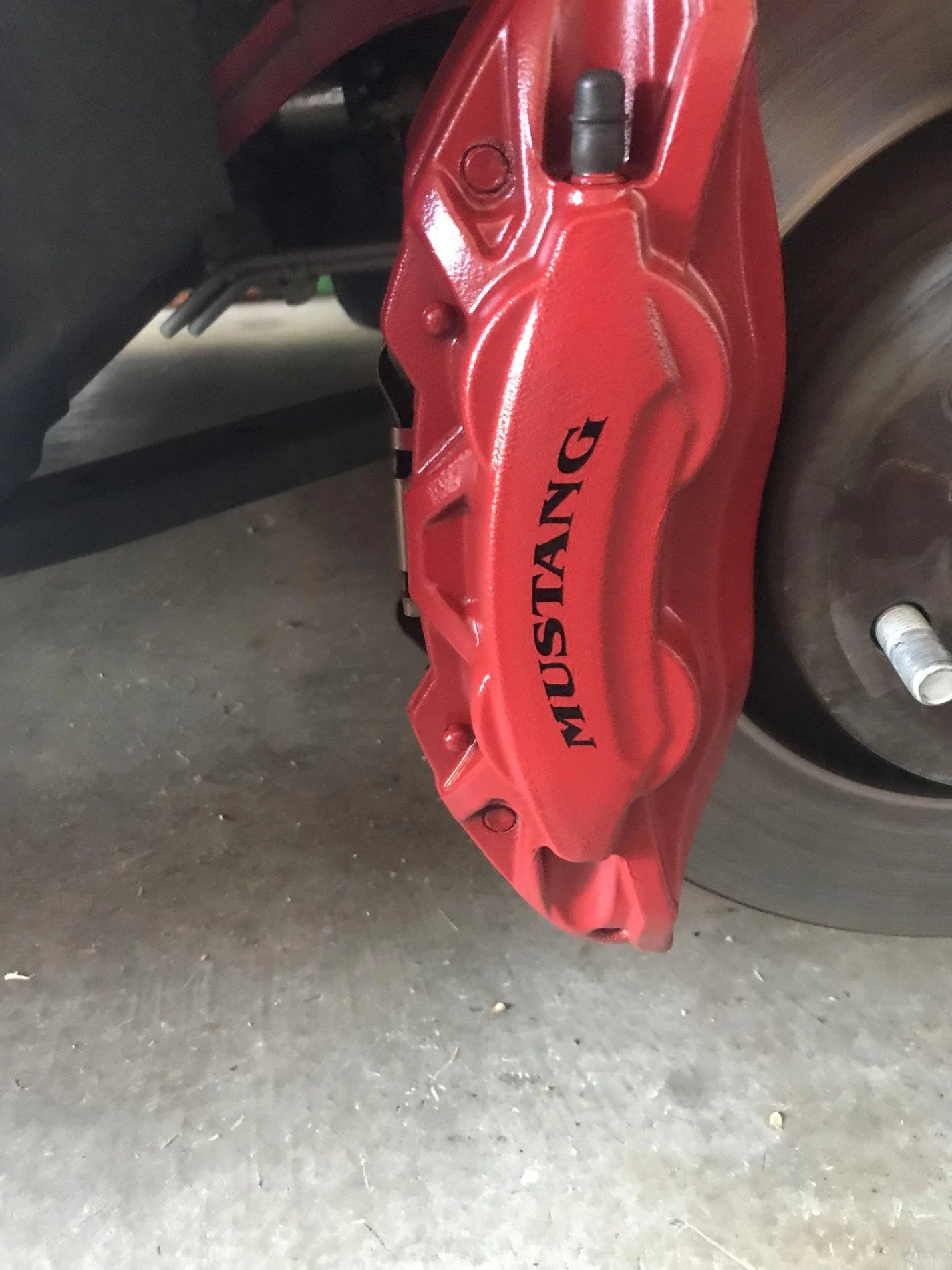

There are a lot of videos on YouTube on how to paint it. I sprayed mine and looks good. I even put a high heat sticker.
