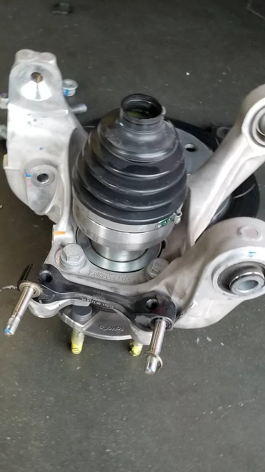

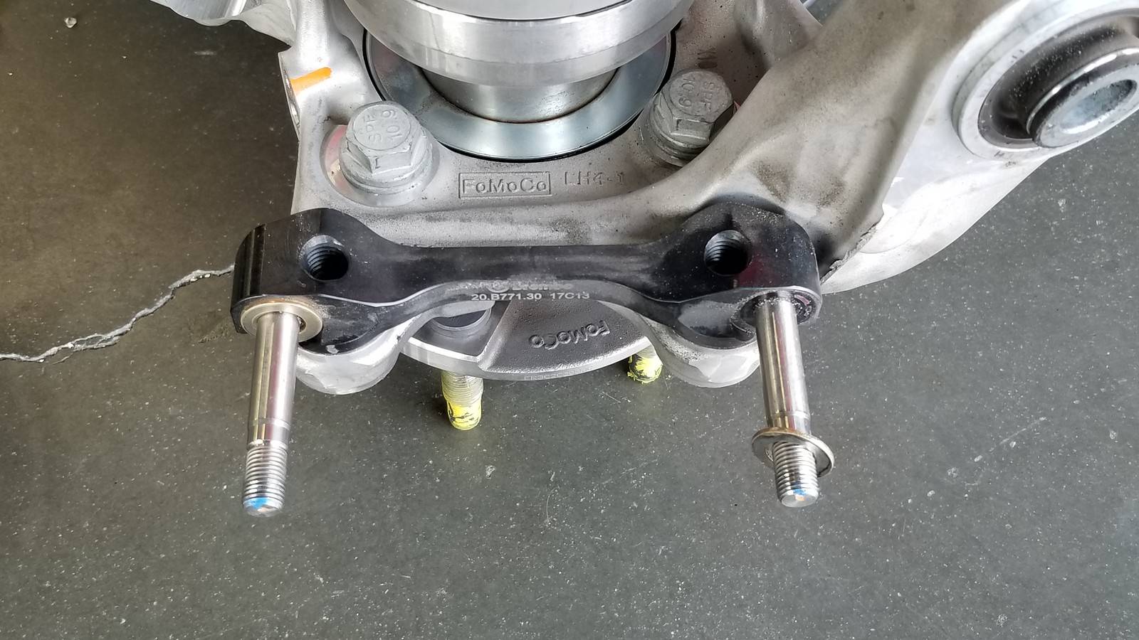

Regarding stainless in this application...never remove or try to torque hot fasteners, don't use impact tools on them, and use the included ARP thread lubricant. Potential issues mitigated.
Internet experts/YouTube videos....yikes. The stainless alloy used is 17-4PH and it is perfect for this application. You don't see brake manufacturers or OEM's use stainless fasteners at the caliper to spindle or knuckle interface due to cost. But those same manufacturers use them frequently, across the spectrum in motorsports where pinching pennies to maximize profits is not a concern. For example, the GT4 cars use stainless caliper studs and while I knew they had them up front on their Brembo setups, I had yet to see the back. Plenty of people ask why they can't use a stud on the rear calipers and you have to explain to them that the factory rear calipers are not a radial mount, such as the fronts. While at Daytona in '18 with Kohr's team there was a mid race incident that sent one of the two cars they were running back to the paddock for repairs. I left the pits and followed the car to get a closer look at the hardware being used on the rears.
Note, Multimatic uses Brembo's out back that convert side mount to radial mount as well as 17-4PH stainless caliper studs.
