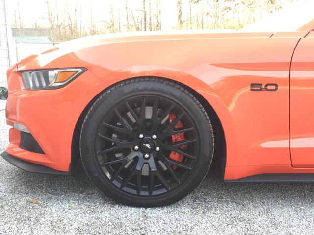

I am Curious on powdercoat and heat? Last I checked it bakes on around 400deg F, do rotors get much hotter than that? Also same question on stickers, don't the melt off? Do they make any good spray on paints with many colors for the heat for us to do in the garage?
Powdercoat is the best way to go for calipers. It can keep up with the high heat juuuuust fine. Spend the money and do it right the first time. My experience with the do it yourself caliper paint kits is that the color starts chipping in 6 months. Too much hassle. With powdercoat, you can get any color you want it will look perfect for years.
Decals are normally fine too, if they are made for calipers like the Brembo ones.

I painted my calipers with Duplicolor High Temp Engine Paint. I used Chevy Orange. Can't tell there's a difference from Comp Orange. I used their clear over it too.
