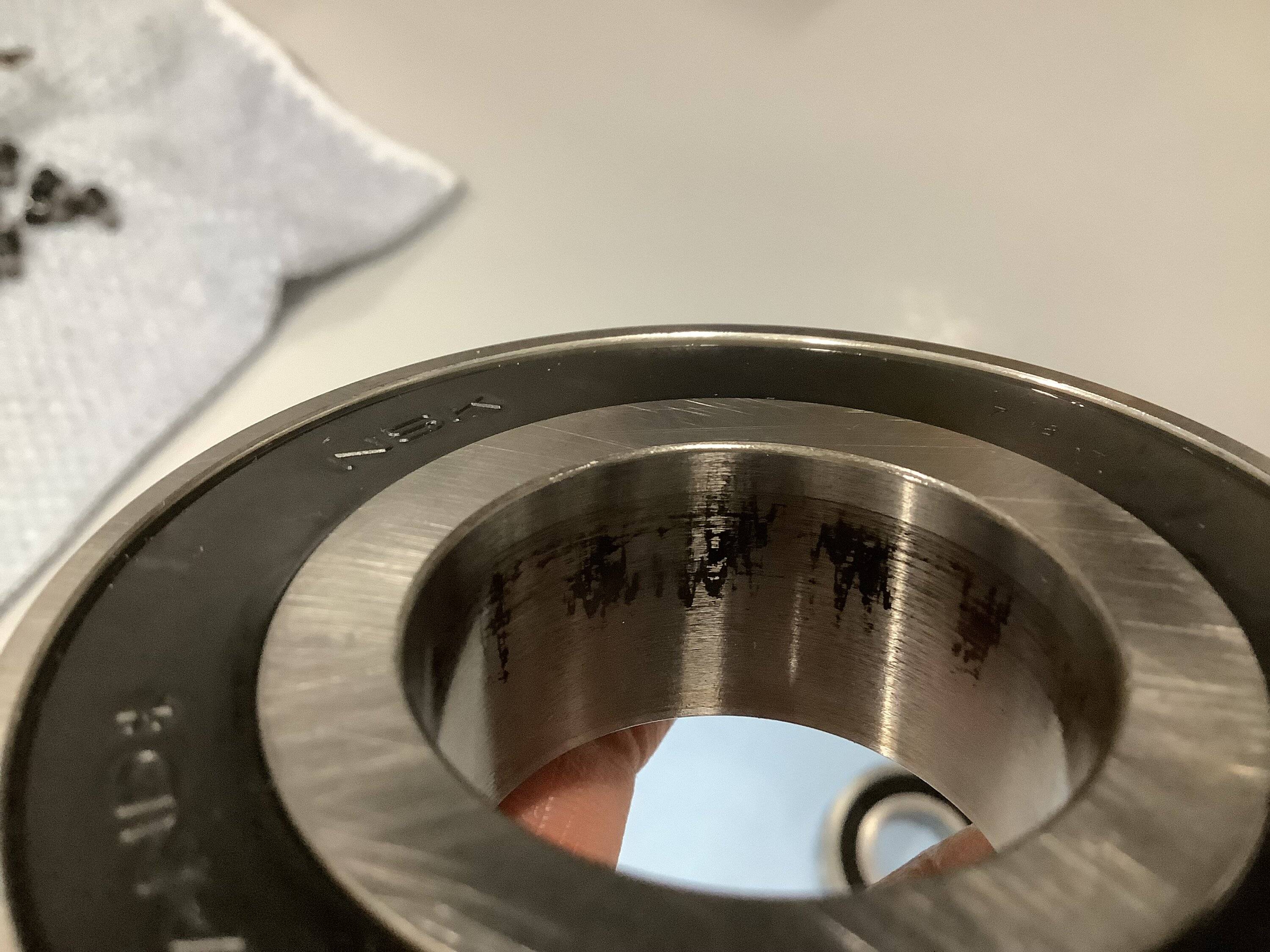

I wouldn’t be surprised about that. Here is what my input shaft bearing looked like at 6400 miles. It’s also why I decided to add an external fluid pump to provide better lubrication in that area.
That's crazy after just 6k miles! I'm assuming there is a thread somewhere showing how you added that pump? Was your bearing making noise before you discovered that? Or did you do it preventively?
I wouldn't expect my input shaft bearing to have any issues since it is a brand new Stage 3 build from Calimer with 0 miles on it.

Man, I sure hope it’s not the input shaft bearing. If it is, then the whole tranny will,need to be taken apart to gain access to it. The FSM says not to remove the input shaft unless it was necessary. Having said that, with Calimer’s stage 3 builds, they’re supposed to have an upgraded 26 spline input shaft right? I’d ask them if they replaced the bearing when they upgraded the shaft.
If they changed the bearing you should have been good. Question is, did they change all three bearings in the cases?
My tranny wasn’t making noise, nor was I having a problem with it. I decided to rebuild it as a preventative measure during a clutch swap to make it stronger than factory and to handle drag strip use. I bought new bearings and had them cryogenically treated to make them stronger as well.
Here is the build thread on my MT82-D4. It shows mods to the casing and external fluid pump.
