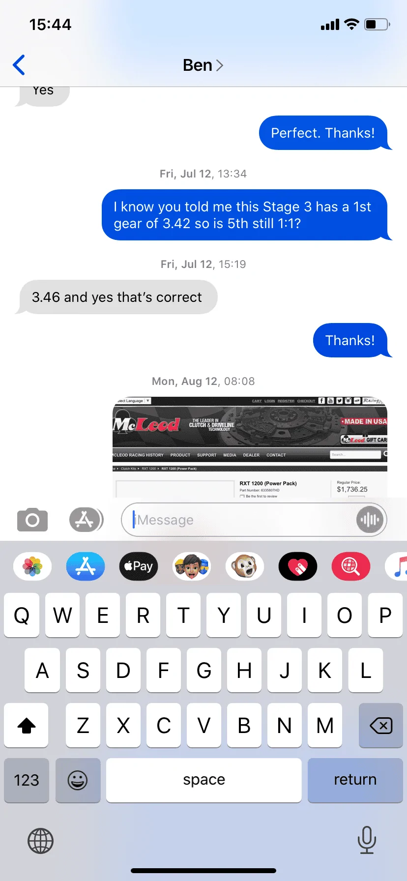

I called and messaged with Ben regarding mine before I ordered and again upon receiving it at my shop. Speaking directly with Ben Calimer himself he gave me these numbers:
(If these aren’t the correct ratios then don’t shoot the messenger. I’m simply stating what he told me DIRECTLY on the phone while answering my questions about placing the order for my Stage 3. I didn’t get these numbers from anywhere but Ben Calimer directly)
1st gear 3.66 in my 2016 stock MT82
1st gear 3.46 Calimer Stage 3 GeForce
1st gear 3.09 stock 18-19 MT82

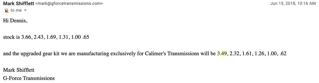

Either Ben is misremembering his specs, or something changed. I have one of the first Stage 3 builds (7/18); when I reached out to GForce about the ratios, here's what they told me:
In case my screencap link goes dead at some point in the future, in summary:
1st: 3.49
2nd: 2.32
3rd: 1.61
4th: 1.26
5th: 1
6th: 0.62
1st: 3.49
2nd: 2.32
3rd: 1.61
4th: 1.26
5th: 1
6th: 0.62

I found the paper where I had written down the GForce ratios as posted on Facebook by Calimer as 3.46, 2.29, 1.61, 1.26, 1.00, and 0.61 overdrive.
