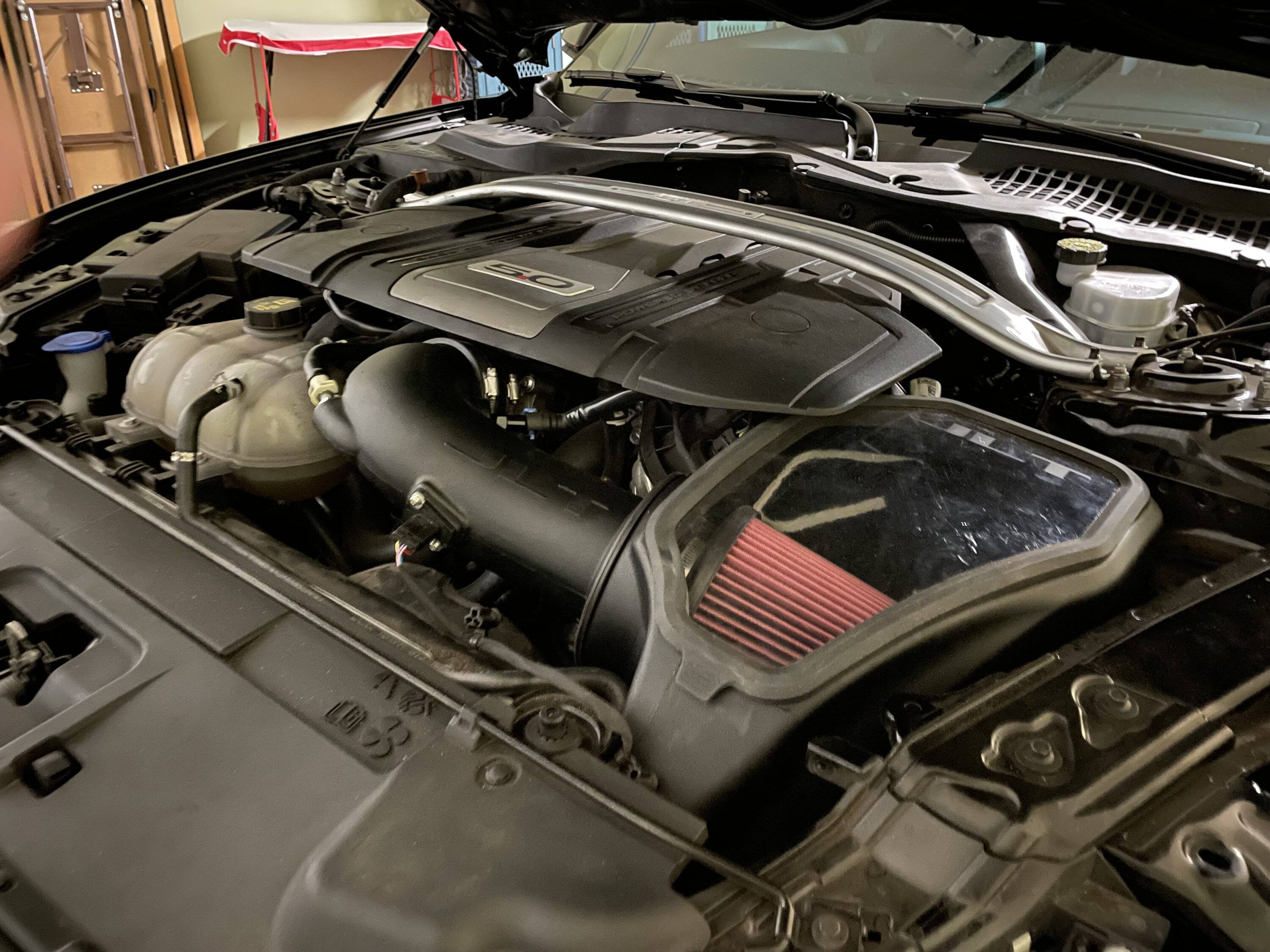

I have the new-ish closed lid JLT. Fit and finish is amazing, and plastic is thiccc. I have not yet seen a drastic jump in IAT that would not be expected in this Phoenix heat.
