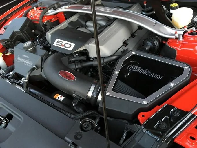

A CAI when combined with other supporting mods will add a fair bit of performance and efficiency to your ride. The IAT "issues" are exacerbated by the fact that it is a readable measurement. If you are not racing the car they are not a giant concern, but you do want to try and keep everything cool for better longevity. Many CAI's will get you 10-14hp (sidenote our Windstorm and the JLT CAI make the same exact line for line power) on top of the better aesthetics of your engine compartment.

That could not be further from the truth. Our Severe Windstorm will almost make your ears bleed with the symposer tube connected.
I was assuming no sound tube as it seems most people remove it. I personally hate sound tubes but yes running the sound tube with a closed box intake will be louder than if you removed it with the closed box intake.
