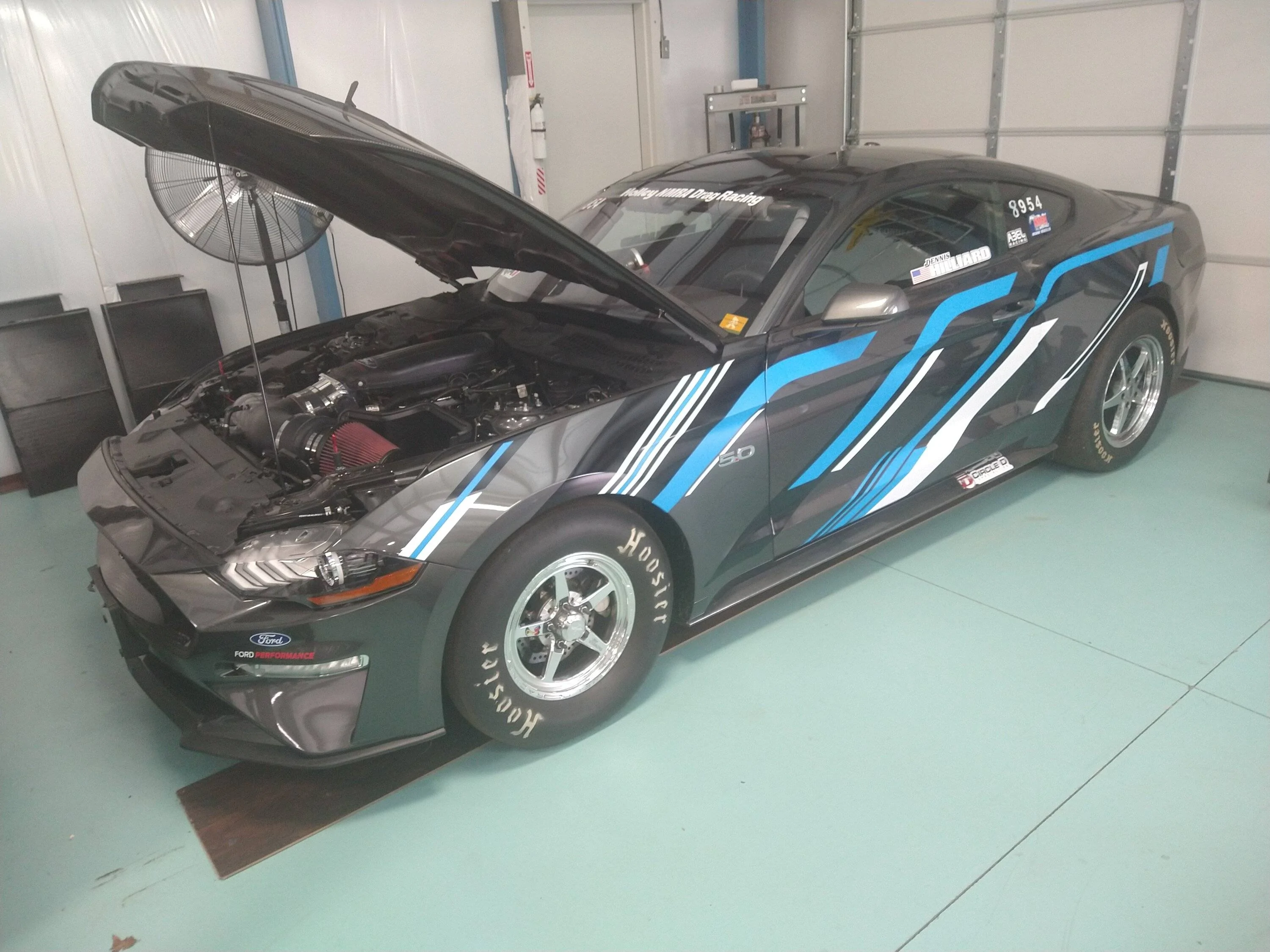

I will try and get some pictures up soon, It has been on all motor Coyote face book page awhile back. First as good as the 10 speeds are for a well built NA motor the torque converter technology is just not there for a true 5500 to 6000 rpm stall, also the trans brake is not really a good choice . You will brake the trans, not if but when. It's 110 pounds lighter then the 10 speed, 40 lighter then the 400, less HP to run, 1000's of them used in bracket car's stock and super car's behind big block motors, I went with a full race unit from JW. Converter was built by Circle D, a bolt together unit, and yes as fare as we know this is the first S550 with this swap. The car will run 4:88 gears

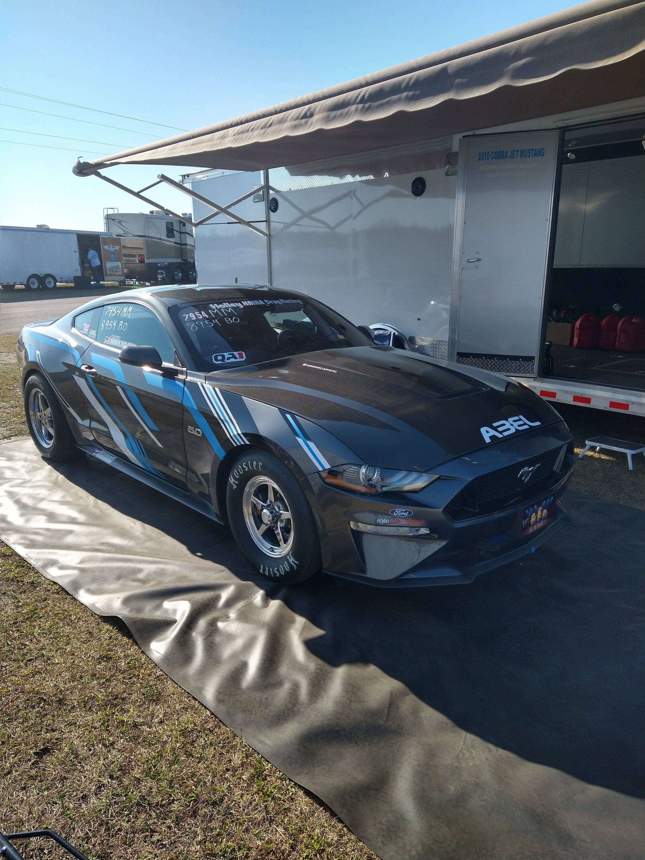

This is my 19 Mustang GT project car, 5.5 motor, C4 trans we believe this was the fastest stock motor 10 speed in the country, went 10:50@ 133.86 on a very soft 60ft. 1.50 in 1800DA air. 3420 pounds with a full 8.50 cage,

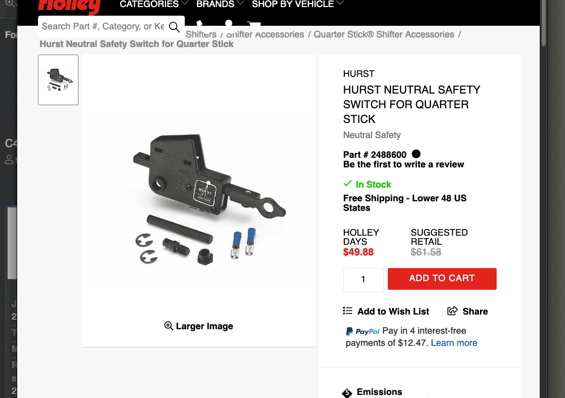

Check this out.
It interrupts the voltage to the starter solenoid, you can have the ignition on the starter will not turn over.
It's a simple circuit, just find the wire that goes HOT when starting, it is only hot when starting.
I don't know what the wiring looks like for the Mustang starter & solenoid so can't any closer to the exact how-to.
If you can post a picture I could be more helpful.
https://documents.holley.com/2488600_instructions.pdf

Thank you for that, I have looked at that and now that you point out that really all I should have to do is tie into that hot wire to the starter I think I can make that work. Thanks again.

To be clear the solenoid, not the big battery cable that drives the starter, makes sense?

Yes, I did understand, makes perfect sense. Thanks again.
