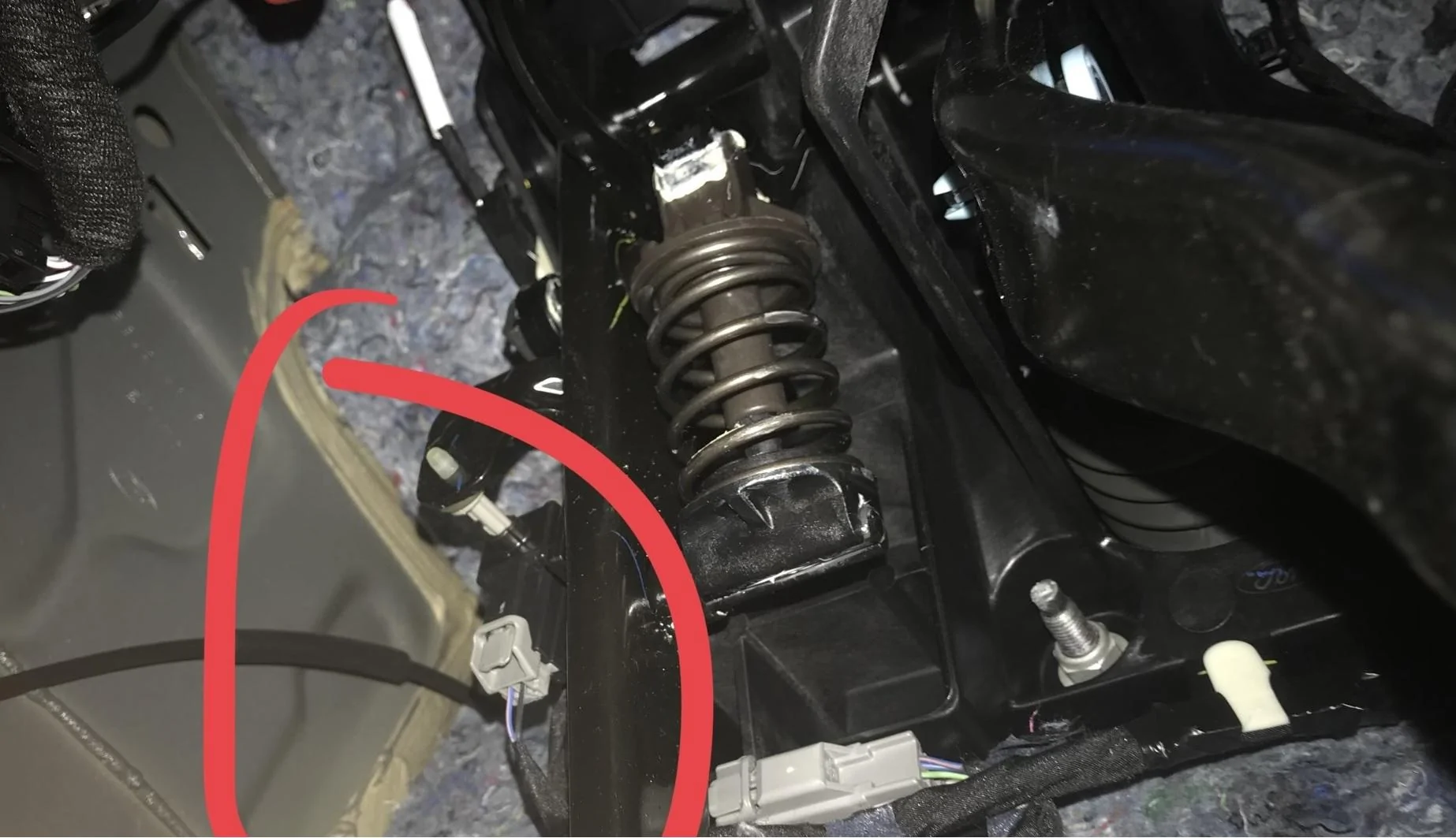

Let me see if I can find a pic. I was confused at first too but it’s not too difficult

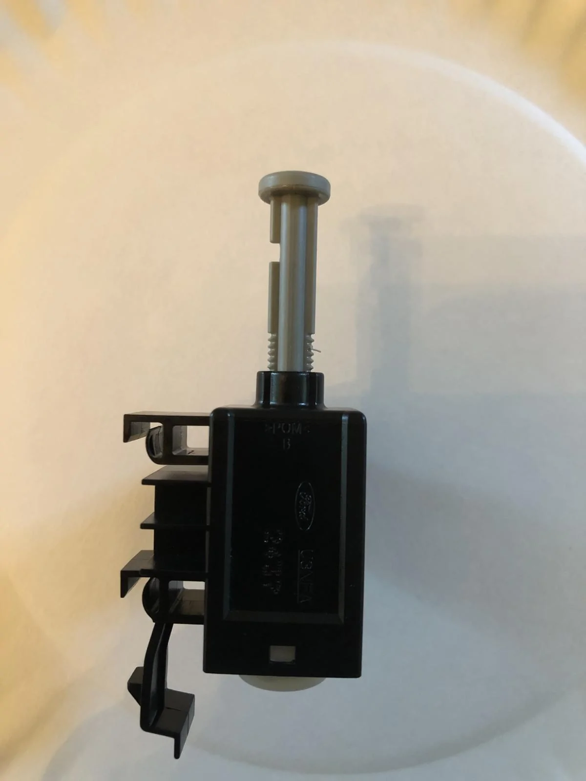

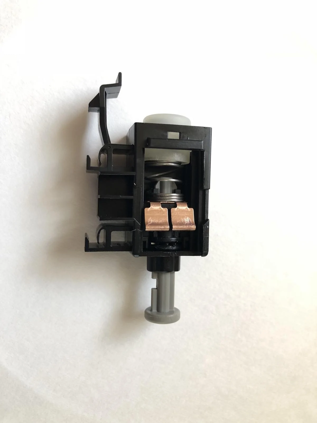

Peedystablo82 Well-Known Member Joined Apr 1, 2018 Threads 26 Messages 269 Reaction score 35 Location VA First Name David Vehicle(s) 2017 mustang GT pp Paxton e85 Dec 9, 2018 #17 You just have to push the clutch safety switch in the little slot and then twist it and it will lock into place.
