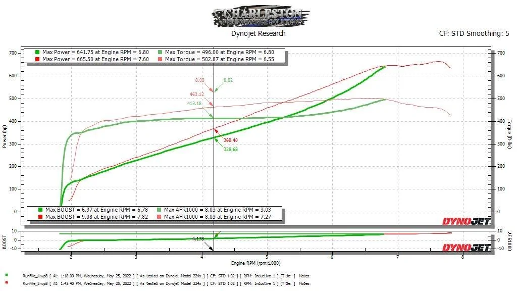

It made 660 whp on pump 93 I’m going to take it to another shop to dyno again to see if it’s reproducible. Overall very happy. It’s just a daily street car although I’m planning on taking it to the 1/4 mile this fall.

Very nice number! I’m looking forward to hearing what it does at rhe track. Will you be on factory tires or stickies for the track outing?

Will be on nt555g2 and nt555r2 rears. I have zero experience racing so I’m just hoping to not embarrass myself.

beefcake stage 2 V3 kit, is that a Whipple? I googled and that's what came up. Nice numbers. You thinking about E85 in the future, to push deeply into the 700 plus HP range?
