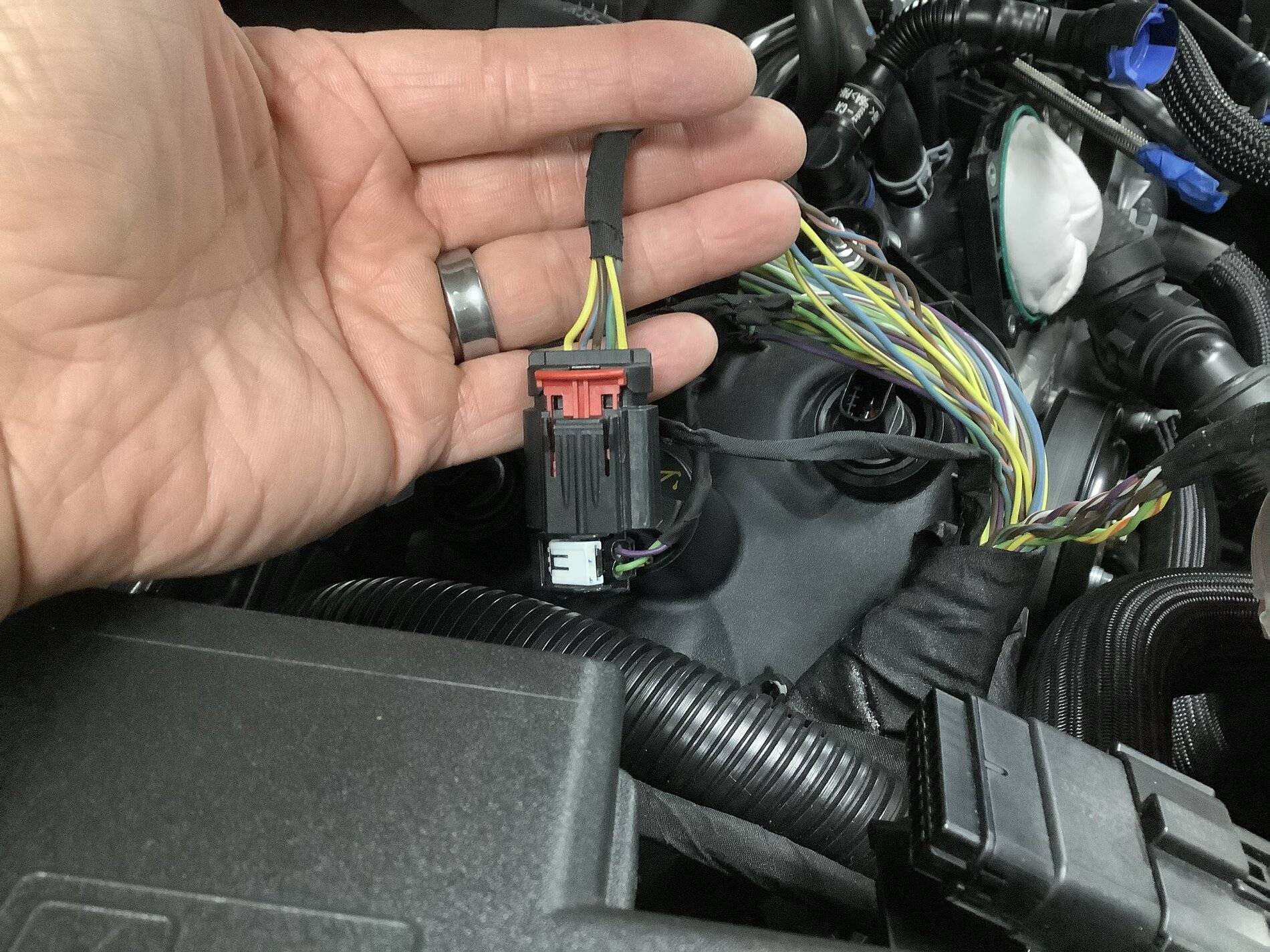

Quick question: Do they need to be repinned for use on a 2017 ? I already have the adaptor, thanks.

The 87mm TB is inductive which have a module that digitizes the output signal (converts to PWM) that the ECM receives.
That's all Greek to me. What's the 'for dummies' translation ?

The pin out is the same. The digital signal is the Devil in the detail.
I’m in over my head at this point but I know the GT350 throttle table is required, how to get the 15-17 ECM to read the digital signal is what I’m still unsure of.

There’s a great discussion on HP Tuner about this subject and using the GT350 throttle table.
All well and good, but I'll just get a 90, repin it and be on my merry way. Thanks for taking the time to respond.
