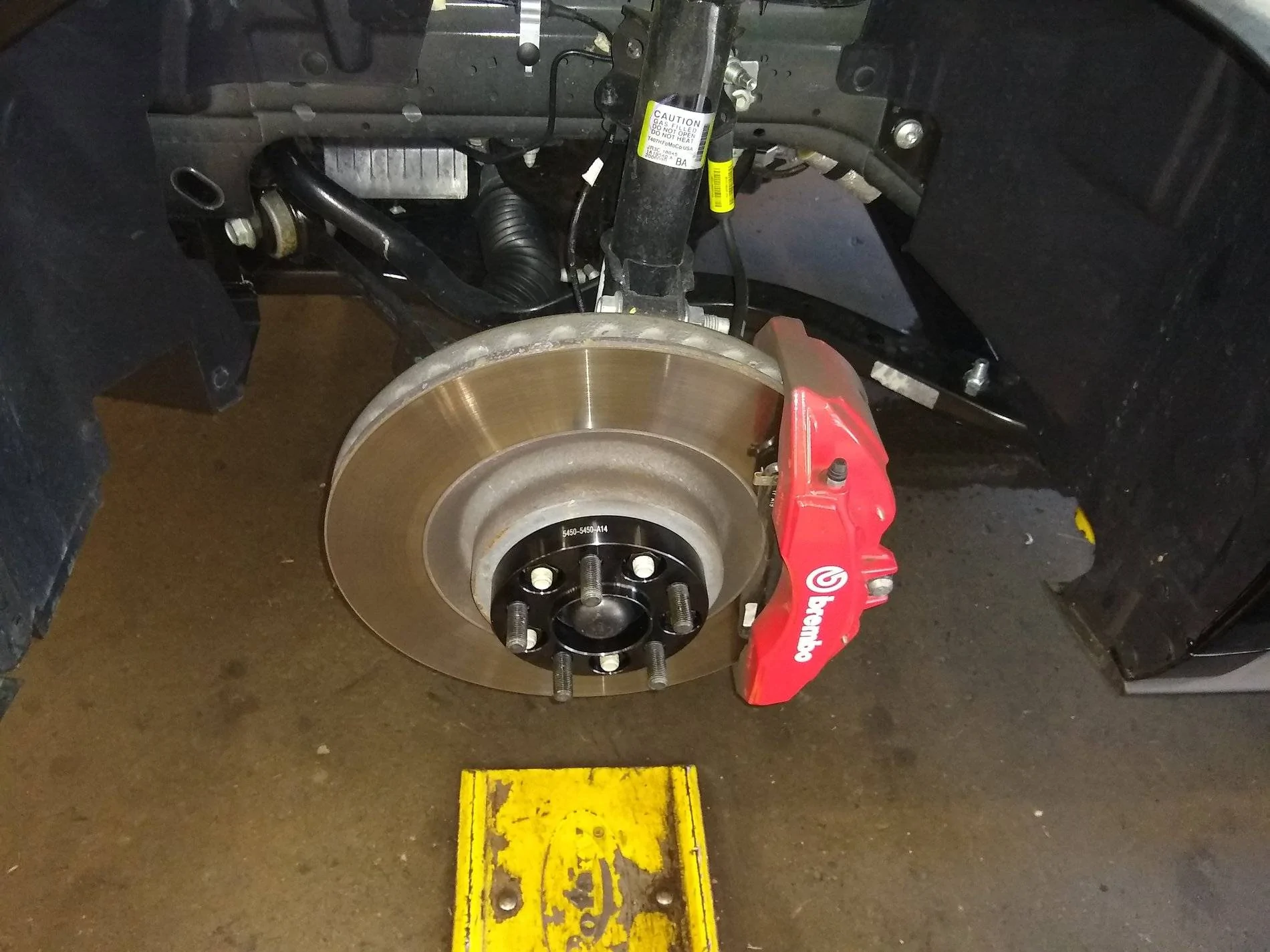

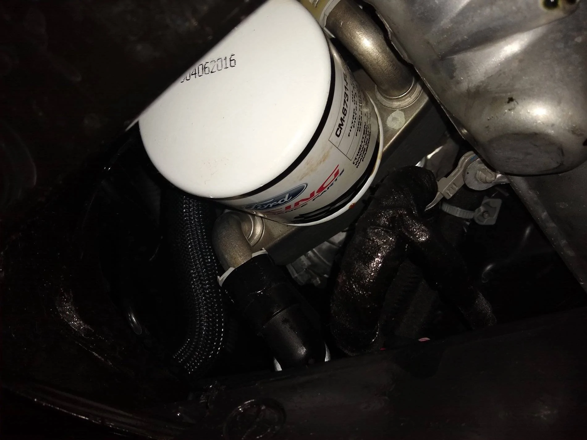

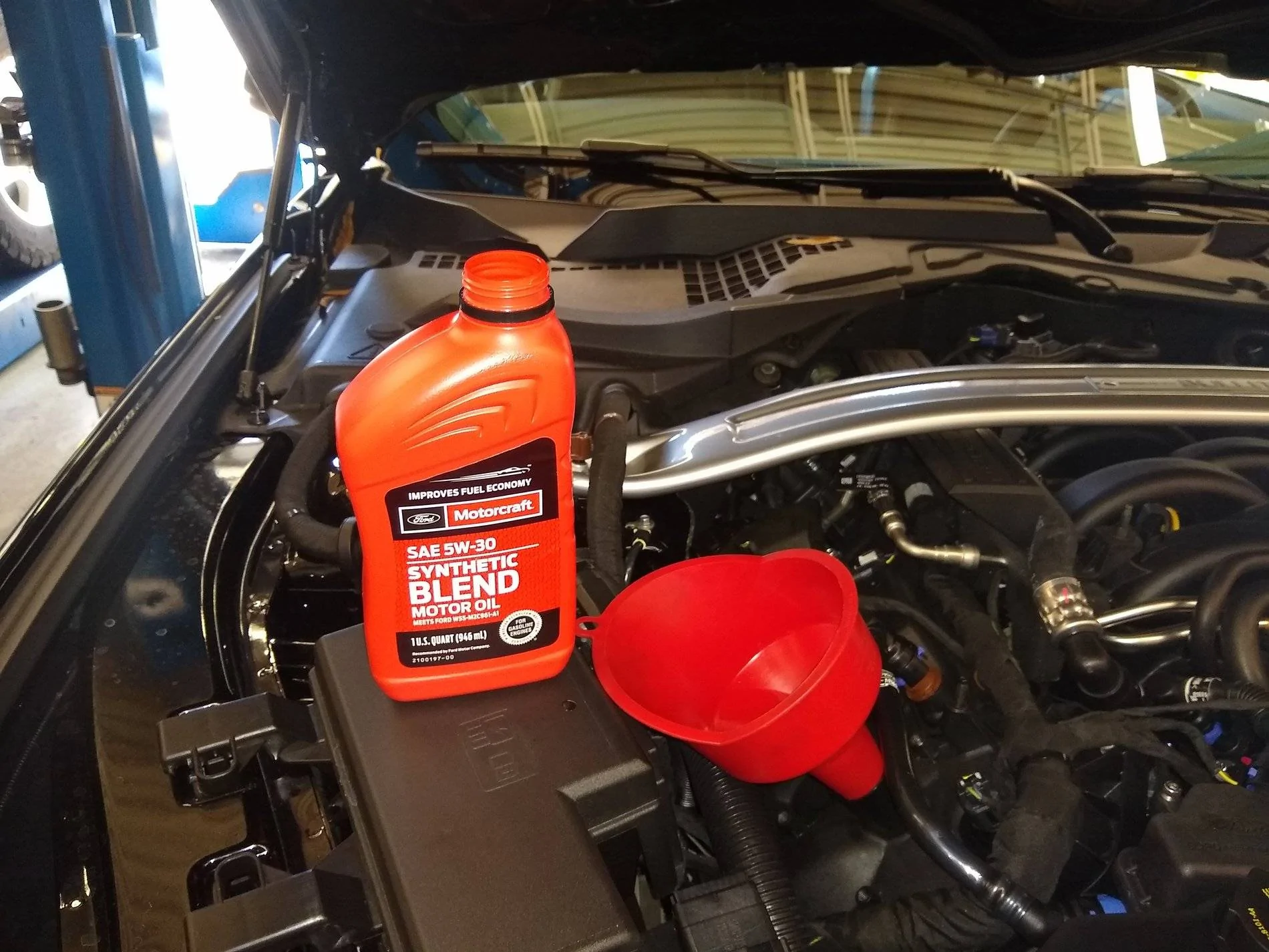

Installed the Steeda Wheel Spacers today and did first oil change with the billet oil plug. Went with the Ford racing filter, and 10.5 quarts of MotorCraft 5W30.
The Ford racing Oil Filter is much larger than the tiny little OEM filter, but the gasket and holes all line up. Took an extra /2 quart.
**I DO NOT LIKE THIS OIL DRAIN PLUG.......

I used the Motorcraft Oil for this first change. May try Something else next time, but sticking with Ford Products for now.
Filter is much larger, but goes in without issue. Oil change was a 10 minute job.
Front wheel with Steeda Spacer. I torqued the spacer to 100lbs, and lug nuts to 120. 120 & 150 seemed way too high.

It seems Ford Motor Company requires 150lbs!! Hope you don’t have any problems!!!! Your choice but Manufacturer specs are for a reason!! Cheers!!!

Did you check if that racing filter has the same relief valve pressure as OEM? You don't really need that huge filter, if you're doing regular oil changes. If you're going to leave the oil for the 10K miles Ford wants you to, maybe. And only if the relief valve is the same. Otherwise it's a waste IMO. Besides, our engines don't have nearly the oil pressure levels as the VooDoo, for example, so not needed on a stock engine. Same thing with racing engine air filters: They let more air that your engine doesn't need, to it ends up getting more dirt as well. I wouldn't use racing anything, unless actually racing, but to each his own :).

I went with the racing filter more for better filtering and larger capacity. Plan on 10K filter changes, havent decided on oil yet. Will do a sample at 5K and decide from there. All depends on how many miles I am driving the car. Will likely end up with an annual oil and filter change. No idea on the relief valve, but assume it is in spec with OEM.
