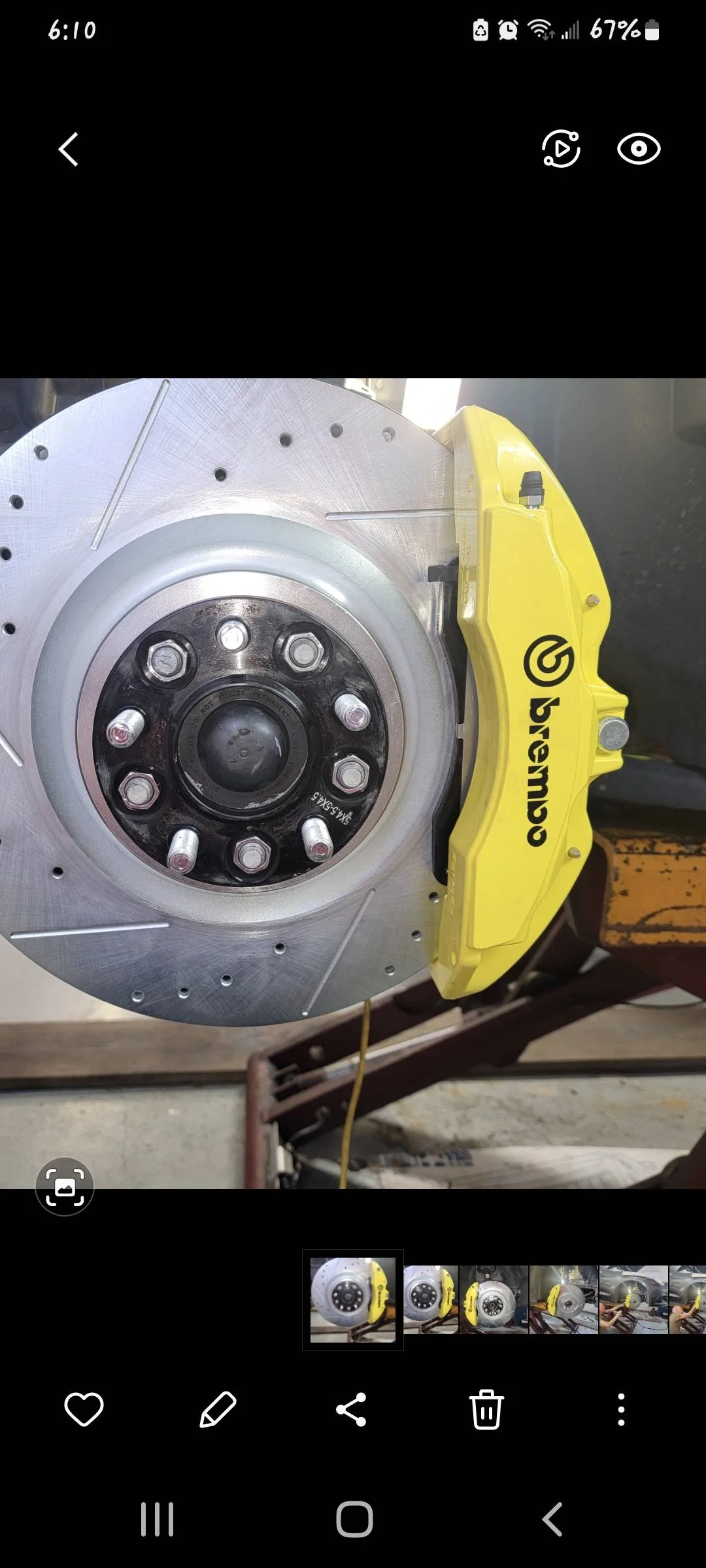

Yesterday I installed the Brembo's I rebuilt and powder coated along with new rotors. Everything went great. I used Power Stop Z26 pads and rotors. Bedding the pads was a piece of cake. I've only driven about thirty miles but initially I thing brake fell through the pedal is better than stock. I'll be putting some miles on today to further evaluate.

Hey I was looking to rebuild my Brembos but the only thing i didnt know about was where i could get another brembo sticker of the right size. where did you get yours?

R&G decals. I took the car to the car wash (touchless) today and all looks good. You'll want the 4inch.
