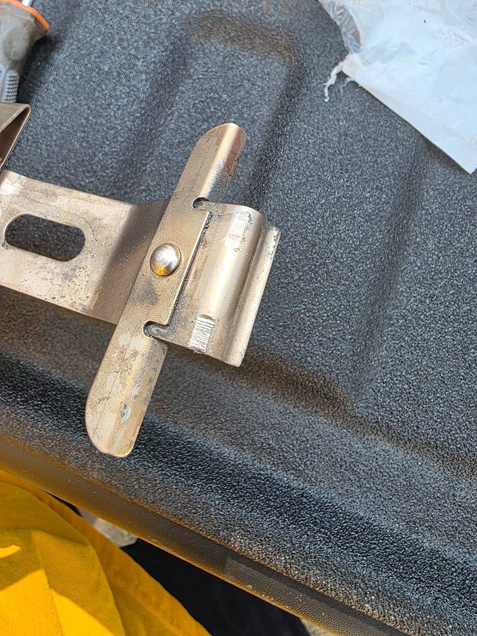

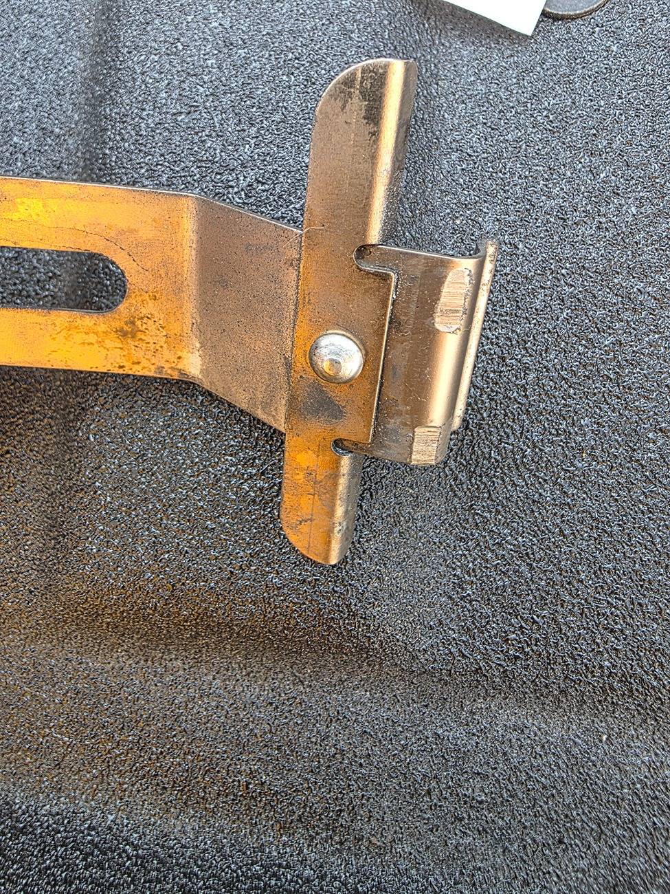

you guys rock! took the front wheels off and checked, it was exactly what yall said it was. bit of a dumb a** on my end as I should have known. Many thanks to all of you!

One would think the amount of money we spend on this stuff that it would be correct. Shouldn't have to use old parts or even question the new parts. But at the end of this day, I am happy. No more scraping sounds and they fixed the original issue.

I was able to use the powerstop hardware but I just had to snap it into place. I wouldn’t say it’s a defect, I would say it’s a different style we aren’t use to(Brembo). With a flat blade screwdriver and very little force it can be clipped into place.
