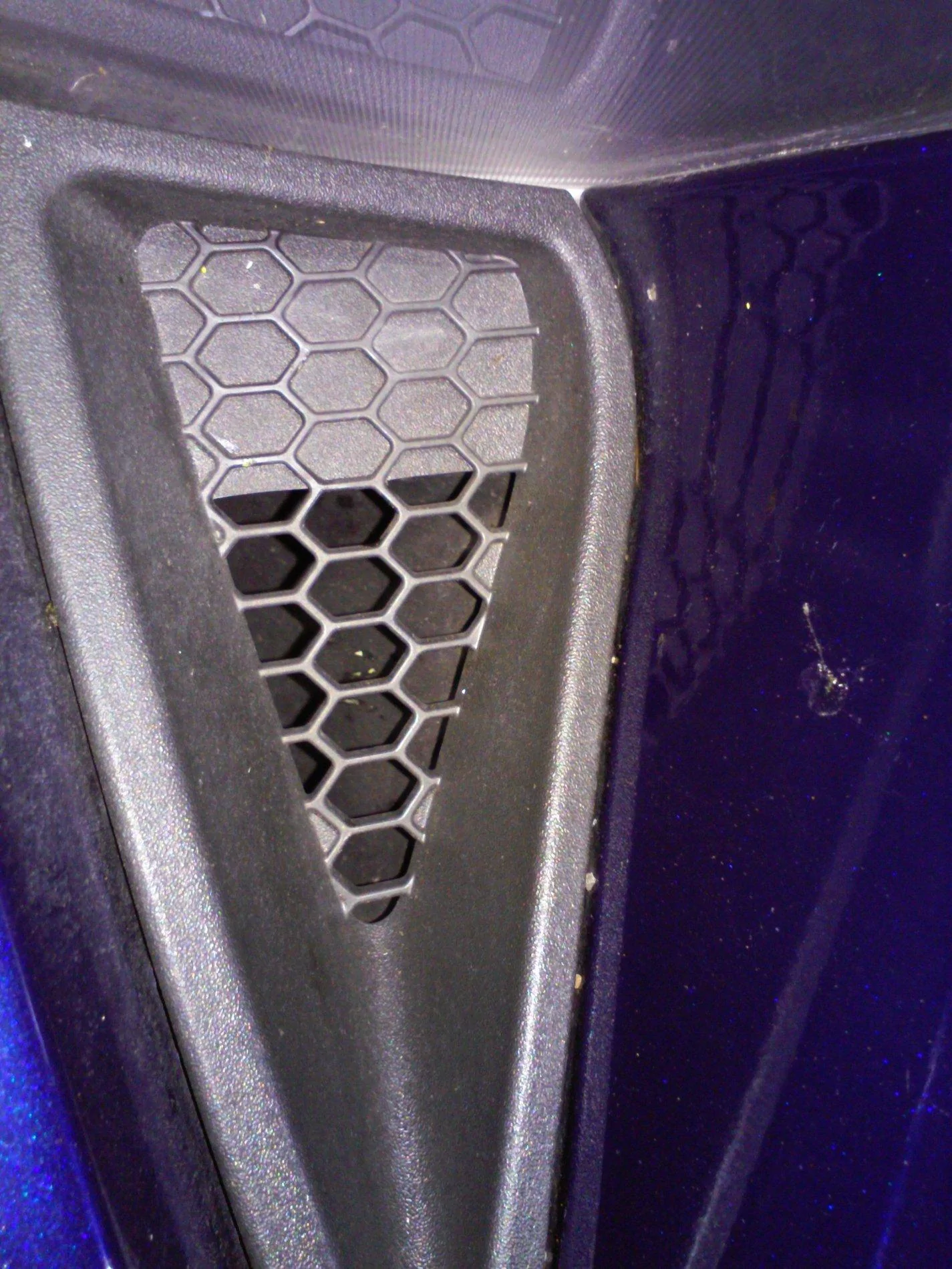

OK, this may be a stupid question, but I just watched a YouTube video of a guy tearing the whole front of his car apart to add the RTR front brake air vents/ducts. The interesting thing about it, is the front bumper cover has the duct work built in for a pathway to allow air to travel into the wheel well area. So, my question is simple.
Why not just drill out the holes in the stock plastic air vent cover? Is this somehow a really bad idea? It does seem like the air flow won't do all that much to cool the brakes, but maybe with excessive air flow on the outside of the wheel, then it creates some differential pressure that cause more air to flow through the wheel spokes from the inside of the wheel somehow. But again, instead of tearing apart the whole front of the car, why not just drill out the holes in the existing stock plastic vent cover?

I have to agree with you. Why spend $200 on this when you can just drill out the existing vent cover ????

I'm thinking his car is not a PP2 car. The wheels are but he doesn't have the chin splitter and I'm not sure that's the PP2 strut tower brace. I'm guessing that actually PP2 cars have that area open to the ducting. I'm very curious about this. I'll check my PP2 in the morning and see if this is open or not and I'll take pics and respond back.

Well, unfortunately, I was wrong. My PP2 has the same blocked off solid piece in front of the ducting. I'm going to have the front clip off to install the upper grill which i opened up via palm sander to allow flow to the Vellossa tech snorkels which also are getting installed. I think I'll just remove the solid honeycomb area with my dremel, sand the edges and call it good.

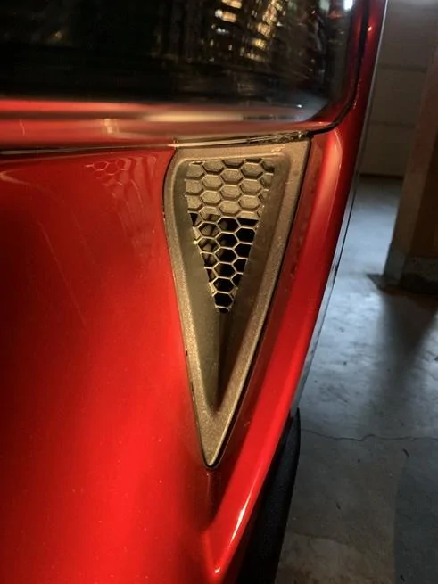

Hi everyone, I read somewhere the reason behind it.
Can't recall where i read it, but I do recall the answer
For Non- Performance pack cars (like my 18MY Premium) makes sense to have ducts open as the factory wheels are 8ish inch width and the ducts direct air right to the outside edge of the wheels improving by certain amount the front end aero (makes the front slippery by a tiny amount, fuel economy, drag etc. will improve)
For PP1/PP2 cars, they use wider front wheels with 9 or 10.5 inches respectably from the factory. So if the duct is open the air will actually hit the rubber (not the outside edge of the wheel). By having closed window, the air will have to go around the fascia improving aero for that particular setup. Note, that the PP2 cars have a small air deflector at the edge of the lower splitter acting as a vortex generator creating a pressure that sucks the air from the wheel well, in other words, is trying to suck as much turbulent air as possible, the amount of improvement will be negligible for any user, but not negligible for EPA rating.

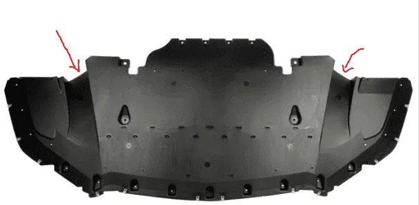

These outside vents are not even close to help with braking cooling performance.
PP1/PP2/Mach1 have a dedicated brake ducts cooling feature within the Lower air deflector at the inside portion of the wheel/tyre assembly.
This lower air deflector can be retrofitted to a Non-Performance cars BTW. found this picture in Cj Ponyparts web site and they have an explanation on how can be done.
