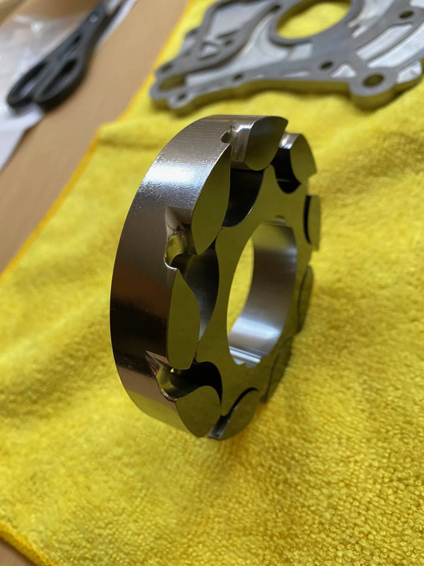

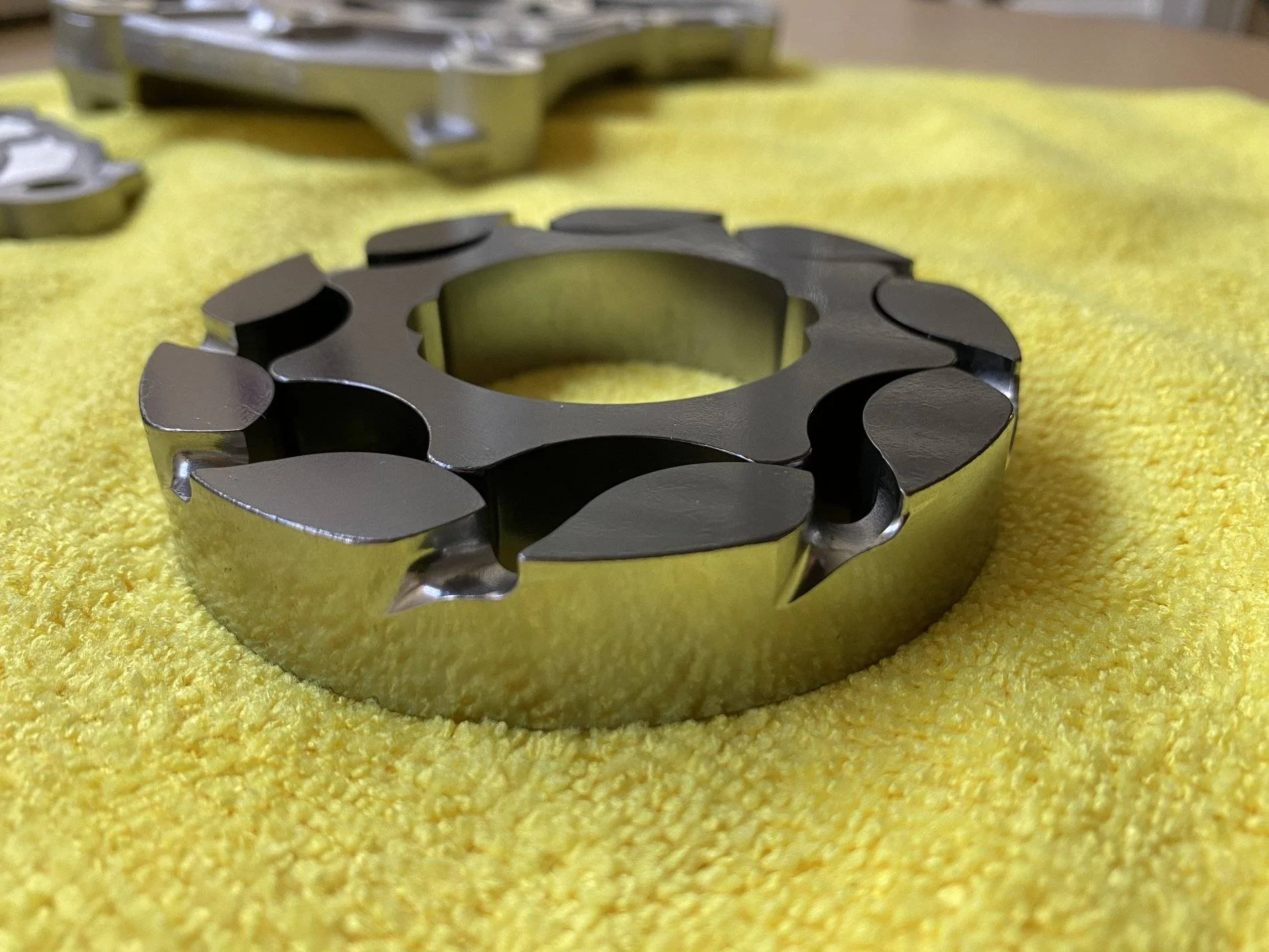

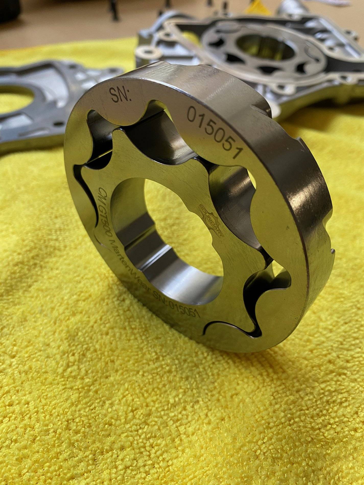

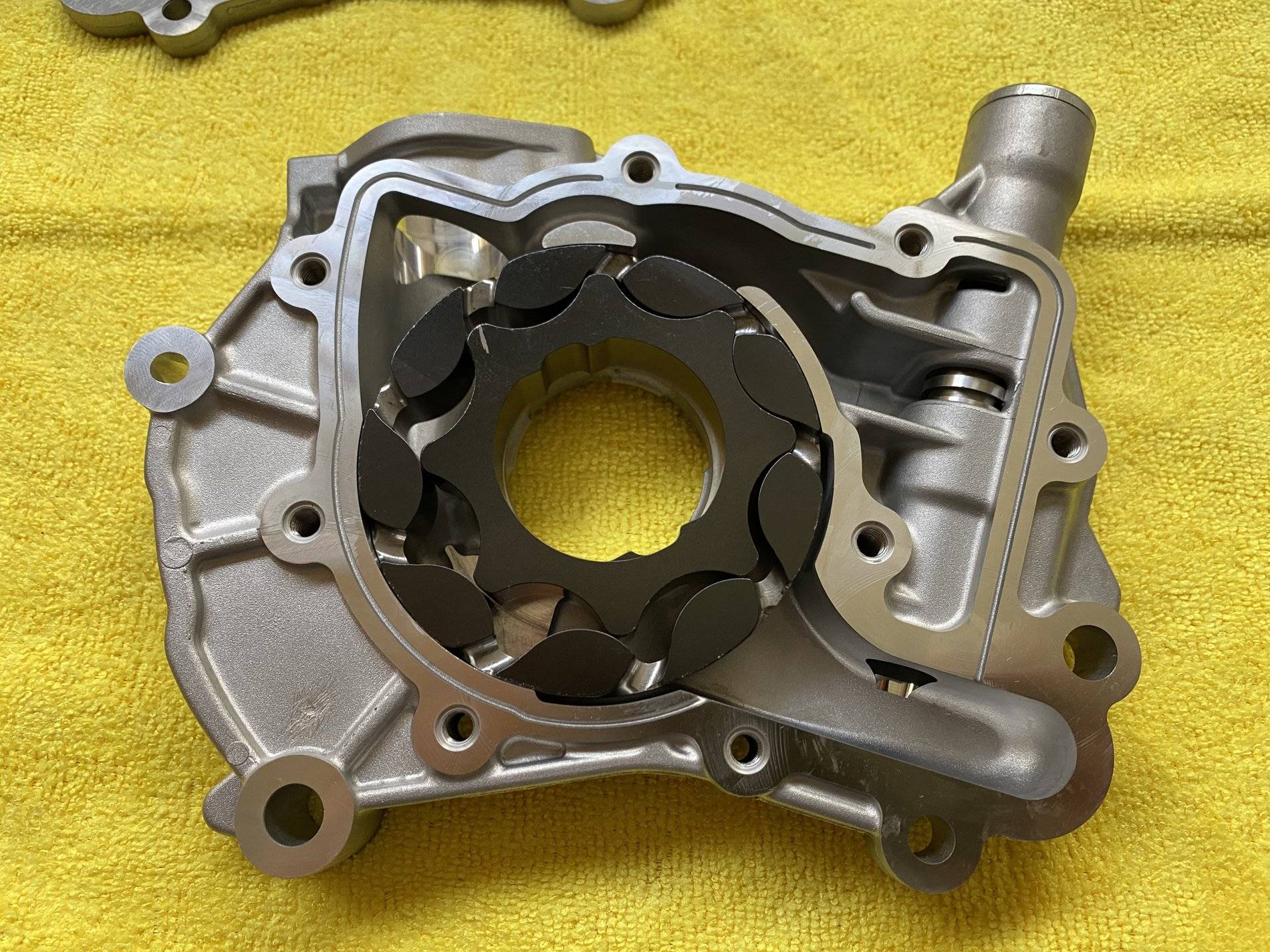

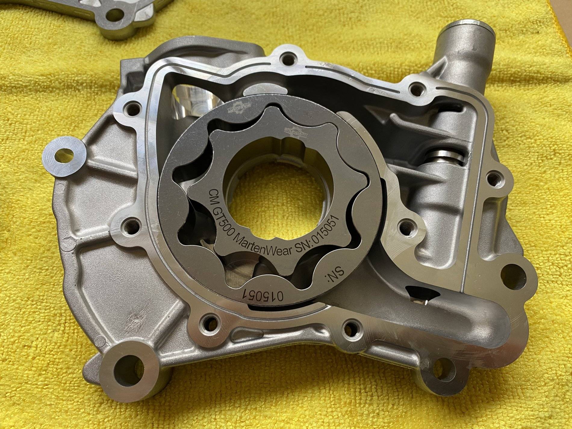

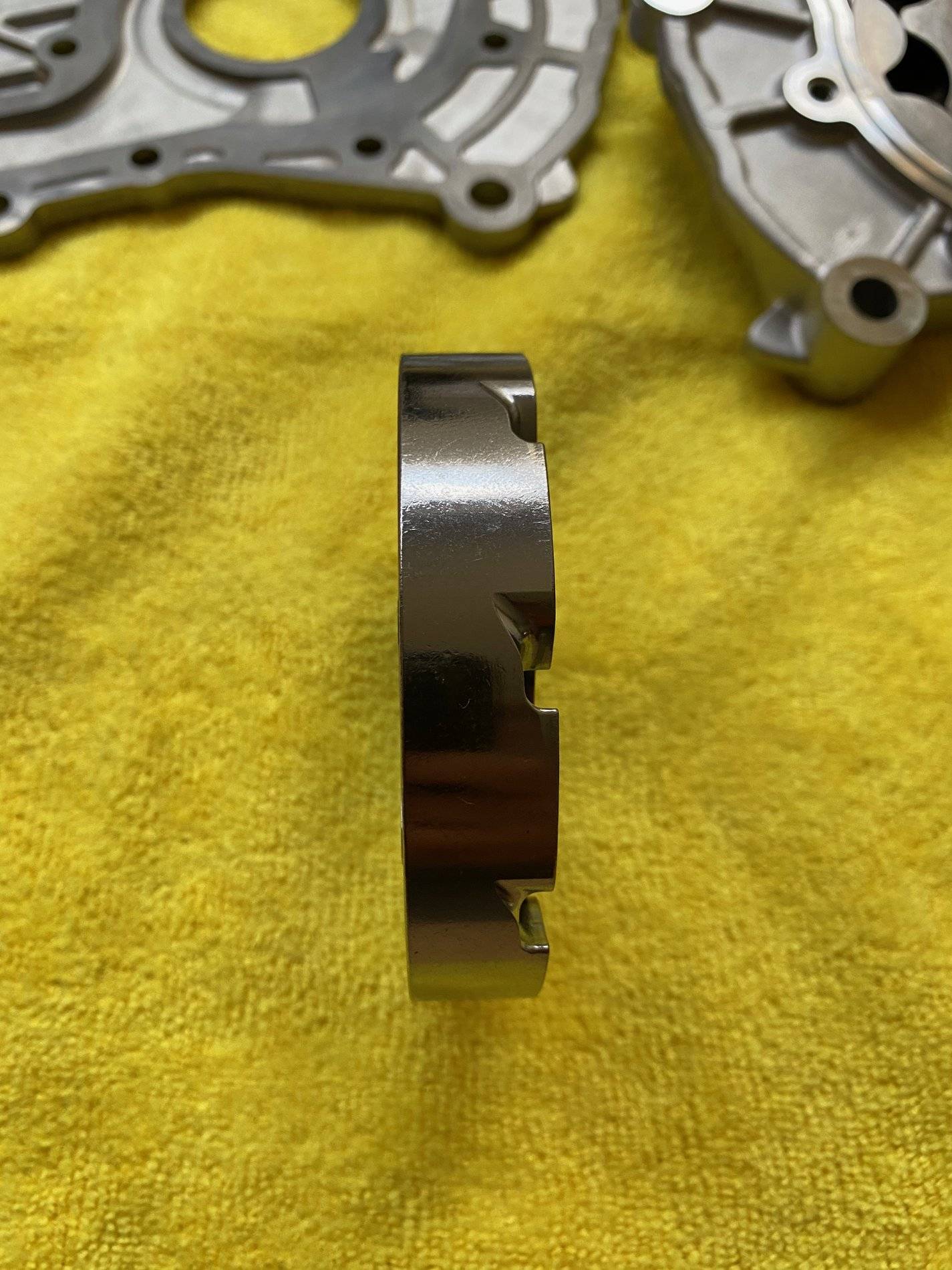

This is part of a larger project but wanted to share some info as these gears specifically DO have an orientation necessary when being installed. The ones pictured are for a GT500 high volume oil pump but these are also made for the stock oil pump that come with the 5.0 models and I have been running a standard (if you can call it that) Boundary oil pump gear for the last three years in my Whipple setup. So, regardless of black opg version you get, install orientation is as follows.
CORRECT:
NOT CORRECT:

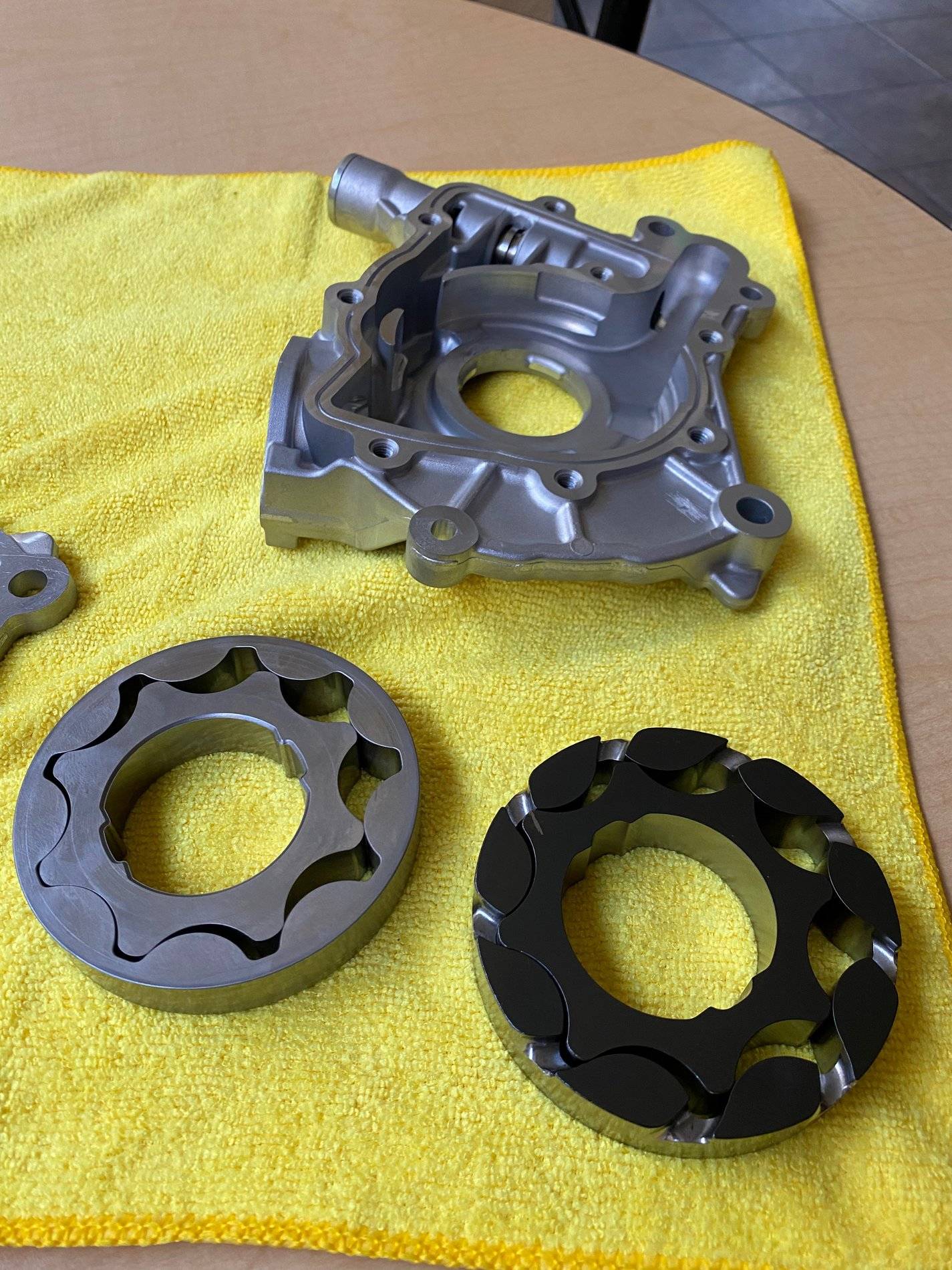

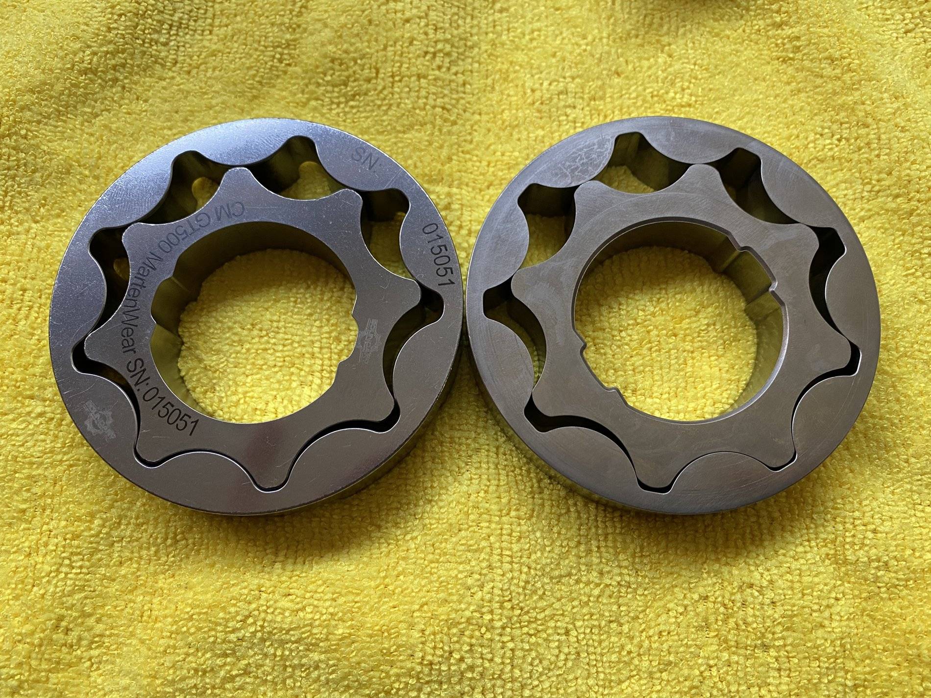

Here are some other pics for the hell of it including the stock opg's. Everything is brand new.

Maybe its me but the outer circumference of those gears look a little rough.
Their product does not appear to be very impressive. The set of Boundary gears i had in my stock engine looked like crap too.
