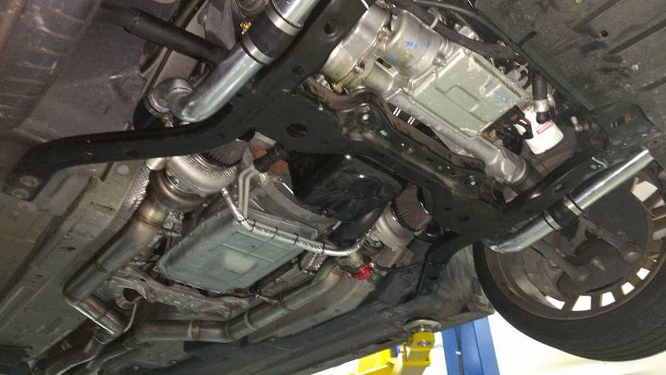

Nice setup! Boy... I would want something protecting those lines under car lest they get snagged on something on accident... but otherwise cool beans!

I'm still making little adjustments with hoses, pipes and wires. I want everything tucked as far up as I can.

Yeah, it can be cleaned up a good bit. There's a lot going on under there once it's all installed! ;)
Is there any concerns with water, with the turbos being so open under the car like this? I live in Vancouver Canada and it likes to rain here

No sir.. you would have to have water about a foot deep before it became an issue. As it stands our turbos sit the highest out of any mid-mount kit on the market.. a good 3-4" about the sub-frame.

Great looking setup! Definitely going with TT's in the near future.
Hopefully this isn't highjacking your thread but I noticed you have the Gt350 I/M.
My question is, would it be worth the money to pair the turbo's with the GT350 I/M? I'm guessing the rev limit and air volume increase would make more efficient use of the boost. Ideally I would want to have it as well, but is there any data comparing the increased HP w/ or w/o?

There was testing done with pretty much all the available intakes with a procharger. I think the result was the GT350 helped up top, and was similar to gains seen with a Sniper manifold. Definitely worth it if you have the $$.

Im hoping that it was worth the money. Once my tune is as dialed in, it would be cool to compare logs/graphs between my set up and a similar one with a stock GT IM. I was told that the increase would be substantial, but without any comparable data its just a guess right now.

Can the turbo and waste gate be attached to the header outside then the whole assembly be slid up into place ?

Attaching the turbo to the header wasn't the hard part. You need the turbo out of the way to reach the PITA bolts in the front of the motor.
