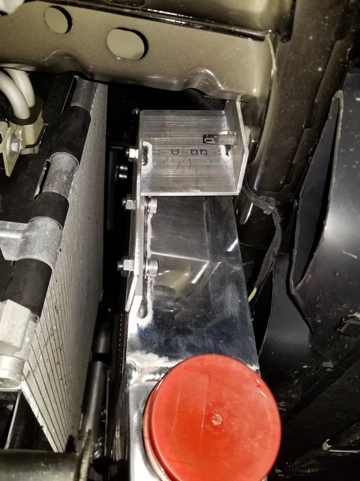

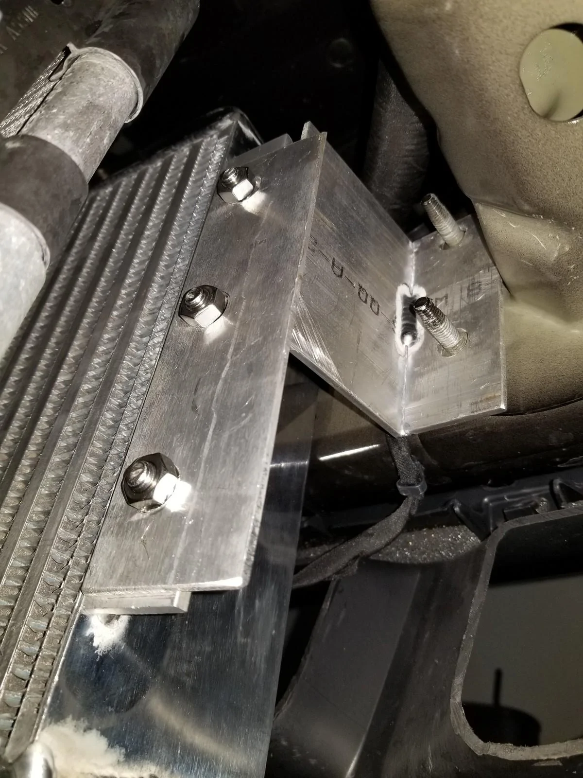

You do not need the bumper support. The intercooler mounts to existing bolts in front of the radiator and ac condenser. If you have a front grill delete kit you don't even need to take off the bumper cover if you had an intercooler there previously. I did mine 2 nights ago and slid it up into place. Here are the mounting bolts you are using. The one on the driver side has a wire loom attached to it you just pull it off and after mounted you put it back on. Here is the passenger side. You should need (4) 8mm 1.25 nuts to hold it in place.

Thanks for the response. The bracket looks a little different in my cooler but will know for sure once it's delivered. This will be great if it's similar.
