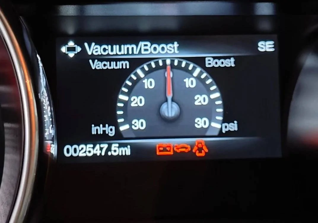

Was fairly easy to do and it seems pretty accurate. I changed the Vacuum gauge to the Boost/Vacuum gauge from the Ecoboost using Fordscan. Best part is you can view it as a gauge or as digital read out so no guessing what kind of boost your making.

On my 2016 I have a Vacuum gauge that shows but it will not show boost. Not useful when running a supercharger.

That's why you get forscan and change it to the Vacuum/boost version of the gauge.
