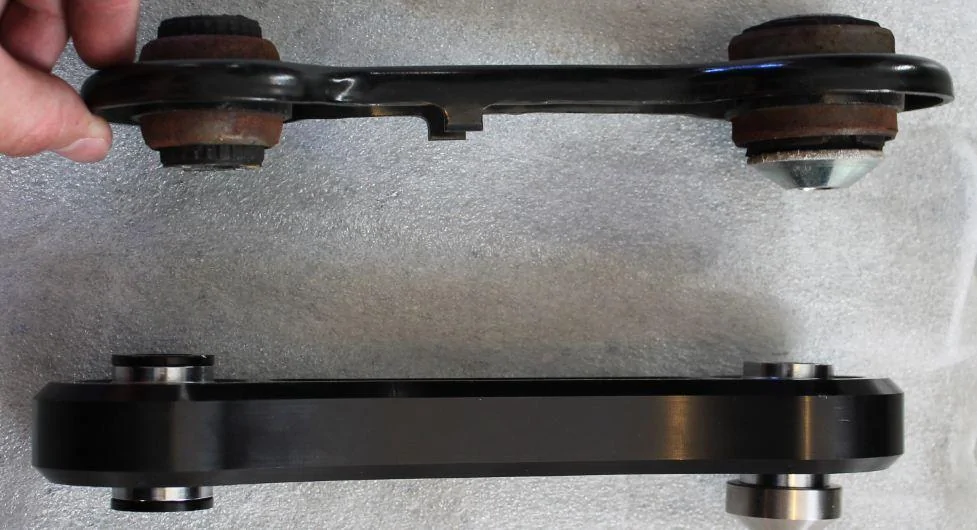

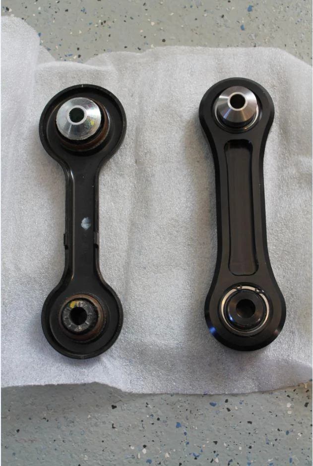

Initial impressions of the vert link kit was very good, comparisons to stock can be seen in the pictures.

BMR vs. Stock vert links top
BMR vs. Stocker vert links side

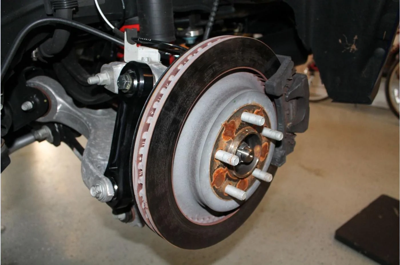

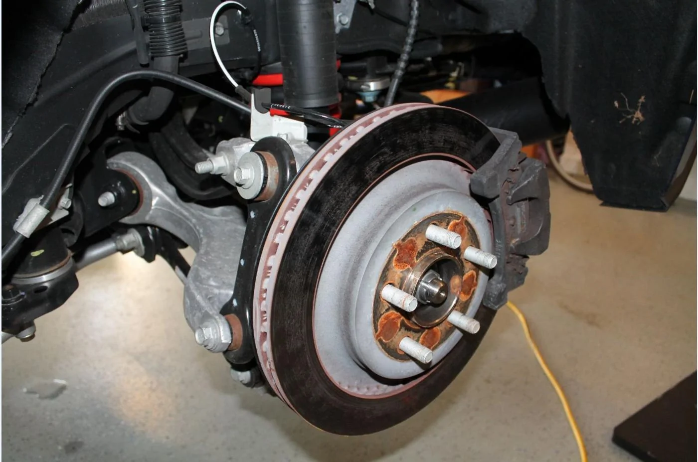

Stock Driver's side vert link installed

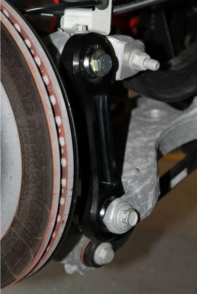

BMR Driver's side vert link installed
BMR Passenger side vert link installed
