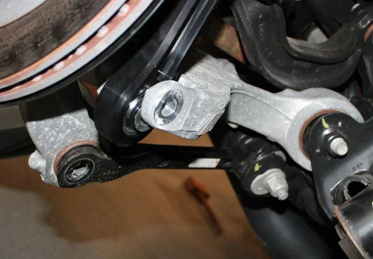

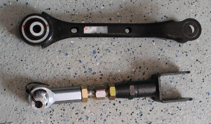

Before, during, and after installing the BMR LCA bearings I also installed the adjustable toe links from BMR. This install is about as easy as it gets. Maybe 2 hours to complete the install if moving slowly, with plenty of breaks.
Put the car up on jacks and removed wheels. Next removed the factory toe rods, only two bolts, 18 and 21 mm and an adjustable wrench does the trick. Once removed, made the BMR toe links about the same length and installed with BMR hardware. One note, it is important to align the black square washers so they set in place with the factory indentations. Otherwise, the toe rods will move. Once in place, tightened the BMR bolts with a 22 mm socket and adjustable wrench.
Job done, headed to get an alignment. However, alignment shop seems to be having difficulty getting this car to have less than -3* camber in the rear. This is too much for me, I would prefer around -1.5 or so. If anyone has ideas or suggestions, let me know.
